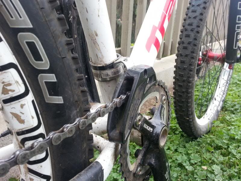

    You can always do what I've done.
    Top guide + a hose clamp + a piece of metal from home depot = $5 chain guide.
    Never dropped a chain either.

    Quote Originally Posted by ihaveagibsonsg View Post
    That's only $5 if you have a top guide laying around. If you only want a top guide then get an E13 XCX guide. But if you want a bash, taco bash (not sure how I feel about this without ISCG tabs), or a top and bottom guide then get a proper guide.
