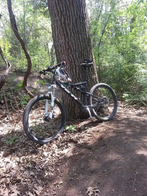

    Yeti makes great frames. But these are pretty similar single pivot frames, really - except the Yeti is a degree slacker. This should make it better at fast gnarly descents, but I'd imagine there is not a whole helluva lot of that in FL. And if you want a slacker geo, the RZ's Lefty fork is easily modded to bump travel an additional 20mm.
    I am biased, as I have the modded 2011 RZ 120 2 pictured above. I love it for mediaum trail and XC riding. Its light (24 lbs), an efficient pedaler (w/ PUSHed shock), quick, precise and agile, yet can attack moderately gnarly descents better than an XC bike.
    Sounds like you have a persistent creak - which can drive you nuts and make you want a new bike. For FL riding, I would not see the Yeti as a significant upgrade for you.
    I'd resolve your RZ's creak (prolly suspension pivot or BB related) and continue to enjoy the hell out of it.
