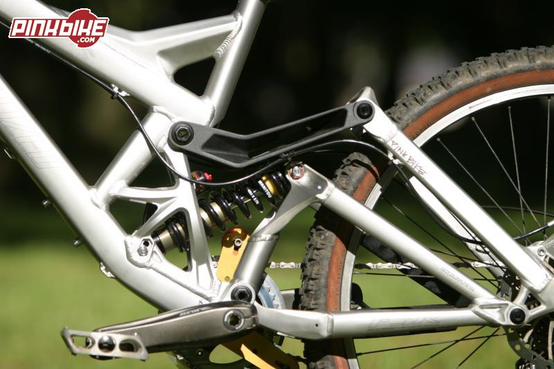

    If this is your bike:
    Then it's not a four bar It's a single pivot linkage or faux bar. The path of the rear wheel follows a concentric arc around the pivot point, the path of the wheel is not affected by the pivot because it is located on the seatstay above the axle. If you removed all the extra links above the seatstay, it wouldn't change the path of the axle therefore, you've got a single pivot! Be careful about telling people they don't know what theyre talking about.

    Just because the sticker says so doesn't mean it is what it says it is. A four bar or Horst link has the pivot on the chainstay, a faux bar or single pivot linkage has it on the seatstay. Not trying to flame you about the not knowing what your talking about thing, just thought it was ironic...

    Kona claims their stuff is 4 bar, and it's set up the same way as the pic above (pivot above the axle/dropout). Is Kona wrong too?
    http://www.konaworld.com/08_tech_dual_suspension.htm
    4 bar doesn't necessarily automaically mean "Horst link" exclusively...........It's just a generic description of how many things are moving around when the suspension works.

    Correct me if I am wrong, but a single pivot means one pivot point. I see four on the moto.

    Look at where the axle is compared to the pivot point. The axle is directly attached to the forward pivot point, therefore it is a single pivot. For example compare to a Spesh FSR (fancy name for four bar linkage):
    The pivot is forward of the axle on the seatstay, meaning that the forward pivot point is interrupted by another pivot before reaching the axle. This changes the path of the axle as it moves through it's stroke and minimizes chain growth and reduces stiffening/squat under braking.
    Many companies use the faux bar suspension and it works fine, just all those pivots and linkages are simply a function of driving the shock, it doesn't have an impact on the axle path like a true 4-bar.

    This is simple:
    If there is only one pivot point between the BB and rear axle, then the suspension is a faux bar or single pivot.

    I do see where it states; "The pivots will still be physically attached to the main triangle separately and thus the suspension will constitute a true 4-bar." I think the author was making the comparison between single pivot suspensions and 4 bars, and was reinforcing that even though the wheel path is identical to the single pivot, it was a "true" 4 bar linkage. Not that this variation (Horst link) was the only "true" 4 bar. But hey, maybe I'm misunderstanding something.
    And the article still calls all the other 4 bar variations, 4 bar linkages/suspensions.
