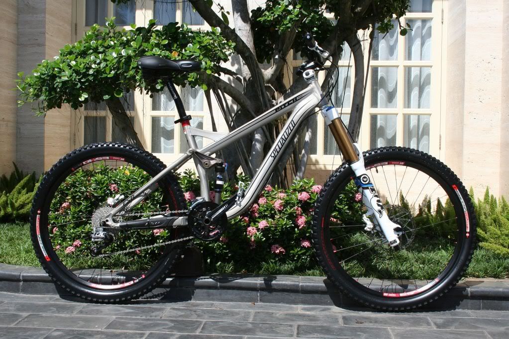

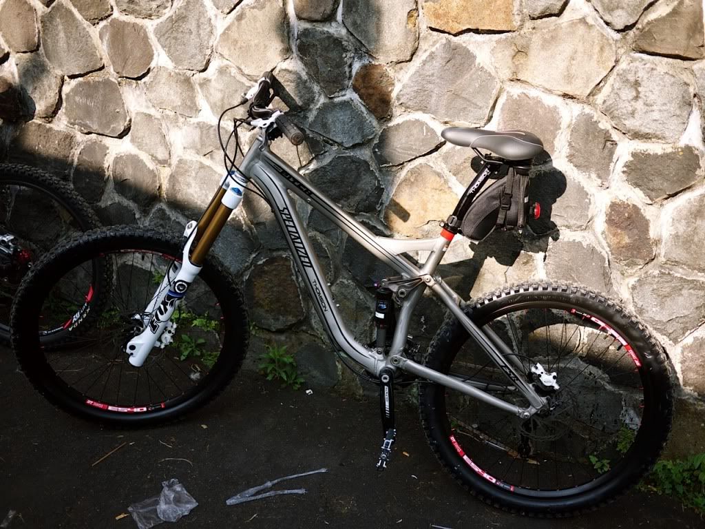

    Quote Originally Posted by stunzeed
    So I have been in heavy debate whether or not to swap my Fox 36 160 out for a 180mm to run on my Nomad
    Its hard to get an honest opinion from most 180 owners because must just say its bad@ss and works great since they bought the 180. I would like to hear the real deal...good and bad of those running a 7" fork on a 6" travel bike. Is the bike really that much more plush? Does it dive more? Steering sluggish..etc
    I did it ...., I'm glad I did it.
    I'm glad I didn't follow my friend's sugesstion to buy Fox 36 160mm for geometry blablabla reasons.
    My bike is Specialized Pitch Pro ( standard bike come with Pike 140mm ),
    I replaced the pike fork with Fox Float 36 180 FIT-RC2.
    More Dive during braking ? Yes, sort of .... but I can minimise the dive effects using low speed adjustment.
    More plush ? Yes, definetely, it has 20mm more travel to absorb vibrations + hard hits.
    More sluggish on tight cornering? Yes, ..... but its not important factor for me. I can switch front tires to make it grippier.
    Better ride ? Yes, definetely. Fox Float 36 is the best suspension fork.
    Look cooler now ? of course
    Going uphill ? The front tires sometimes can lift on very steep hill..... but I shift the weight forward, or I simply step down and start walking.

    you're running a 180mm fork on a 140mm bike? that would put it at around a 65 degree head angle. that's just dumb. seems you have the wrong bike.

    better hope you never need the warrenty...

    Simply badass?
    Ha. Kinda silly maybe... 180mm fork on a 140mm bike? snap goes the headtube...

    I have tested my bike two times going to mountains. Nothing wrong with it !!
    I'm glad I did it and I dont care with warranty.

    I've just installed a Totem Coild 180mm on my Rocky Mountain Slayer SXC 50. I wasn't happy with my Fox Float R. The problem right now is that the my Totem has a defective, leaking Mission Control cartridge and it's currently being warrantied. For the three rides I had it, I was very impressed with the stiffness of the Totem. I wasn't happy with the medium spring so I've ordered a soft spring (I weigh 155lbs). Will report back once it's back from the shop.
