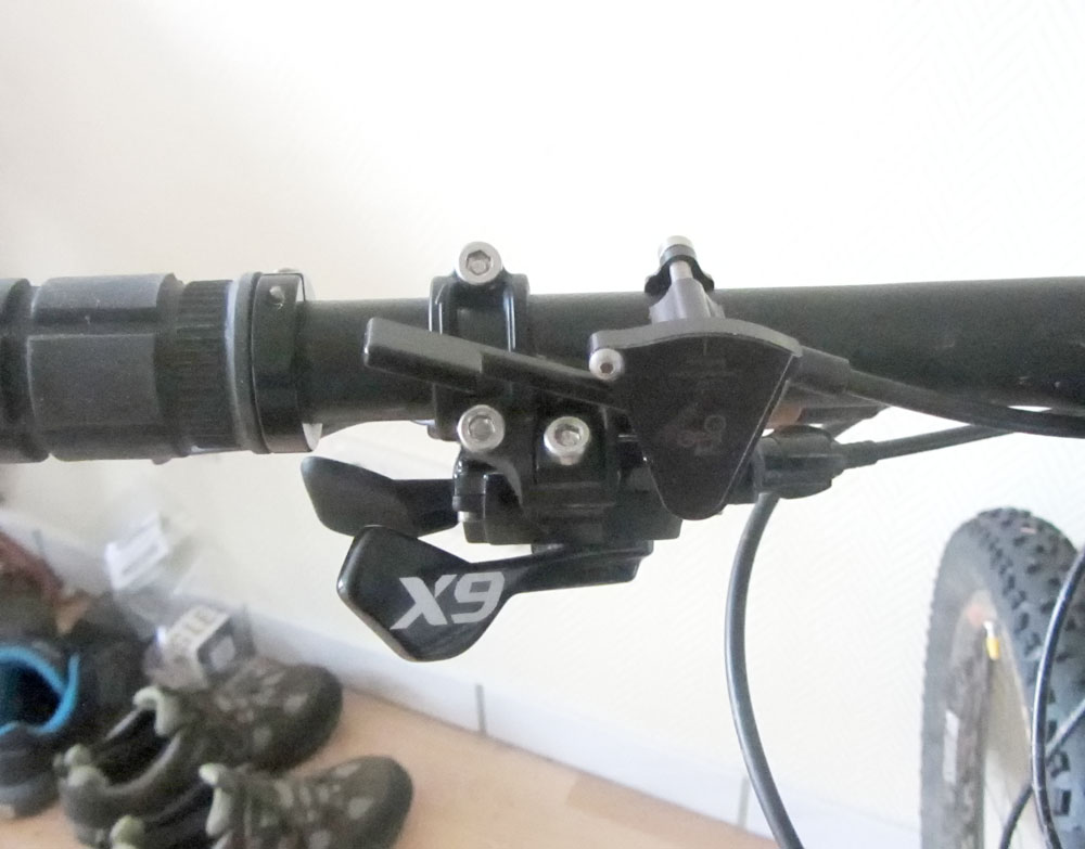

    Thanks, I had this idea too, but running a rear derailleur the X9 Trigger is in the way on the left side...
    This is my solution so far, but ergo-wise it is not ideal

    These are good news - I will follow the news on the GD site to see if this comes true.
    @randan
    Unfortunately these posts are quite old and they all need special tweaks to operate in a proper way like drilling holes and adding screws. The only lever that might work "out of the box" is the Manitou infinite travel lever - but this one is discontinued.
    Seems like we have to wait for the new ergo lever from GD itself...
