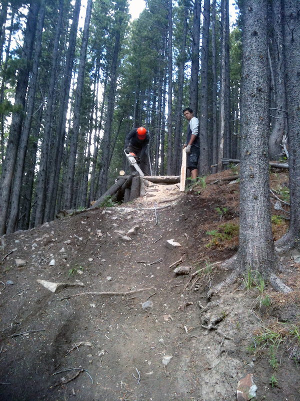

    Was off the drop below. In fact, since I took that picture the transition was extended another 10 feet. I can only imagine how fast he must have been going to overshoot all of it.

    Quote Originally Posted by Bilirubin View Post
    Yeah, you may have not had the pleasure of riding a Jedi...you don't slow down, anywhere! When I was talking to Chris about my warranty issue, he told me he had let some privateers take out some demo bikes. The all came back saying exactly what I said. Like when you roll it into chunder at speed, typically a bike will slow down as the rear hooks onto square edge hits. The Jedi doesn't. In fact, I think the way rear end moves, it pumps the bike as the spring unloads and you get a little kick!
