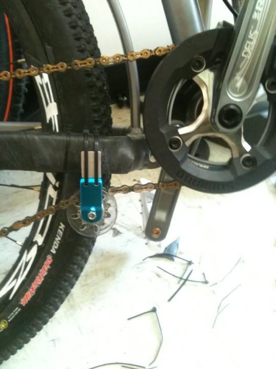

    153
    I got this from chain reaction cycles... Brand-X Chain Tensioner | Buy Online | ChainReactionCycles.com
    the mount comes from this cant clamp on the Reign, so I have DIY the upper part myself, so far the chain never drop again.
    563
    does that only work for single ring setups?
    The mountains are calling and I must go
    153
    I think it may just fit single ring.
