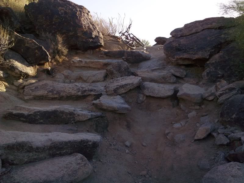

    We can agree to disagree. There are several step up rock ledges on National (local phx trail) that I cannot even begin to make with a 3rd ring on the bike. I hit my 32t bash on them 50% of the time though. With a 44t triple...forget even trying. Not everybody can make use of the extra clearance, many folks have no need for a dropper post, and not every trail is tailor made for a 29'rs....horses for courses.
    (not my pic nor am I the rider in this photo of "The Triangle")

    You probly need air in the rear shock if your bash is hitting that stair case

    The staircase climb to left has been accomplished by very few (in my presence). It's just too choppy and requires almost trials like skills, or at least very very good slow balance skills. The line up (still accomplished by very few vs. total amount of riders) is the step up on the right hand side of the pic. It's difficult to tell since the depth is not captured on film (CCD's?) very well but it's quite a loft just to get the front wheel up onto the rock, then the hard part begins.
