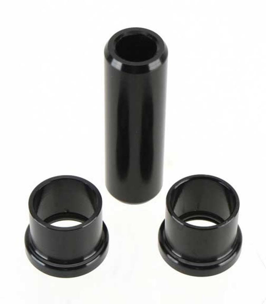

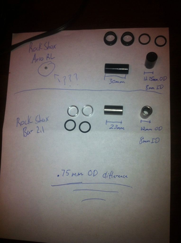

    290
    Do I need any special tools to swap bushes from my RockShock Bar 2.1 to my new Monarch RT3?
    Reputation: jkidd_39's Avatar
    Sep 2012
    997
    Quote Originally Posted by blundar View Post
    Nope. Just remove the DU bushings, pull the shock. Replace shock with the new bushings you ordered for the monarch.
    One thing to keep in mind. Some of the DU bushings look like 1 bolt on each side and a sleeve in the middle. This may not be the case. Some have one bolt and then a sleeve with a rod cast into it.
    Just an FYI.
    Tools I used. Needle nose pliers, flat bottom punch, rubber mallet. Hex keys.
    Good luck
    Jan 2013
    290
    You used the flat bottom punch to get the bushings off? I don't have one of those. I might just have to get one. Any particular size recommended?

    Zeppelin Elite Crank Specs?
    I used a punch to push the du bushing out. So I could remove the shock.
    You could use a screwdriver to push it out. Just use care to not damage the threads.
    Your bushings may come right out. I don't know why my bushings were so tough to remove.
    I don't even know what size punch. I have a set of them.
    Jan 2013
    290
    I was thinking of using a deep socket that is just a bit smaller, and then tap that with a rubber mallet.
    It probably will be very easy. Both the new and the old shocks are RockShox. So I am hoping that I can just take out the bushings off the old one, and re-install everything with the exact same components on my new Monarch.
    The Bar has different bushings! they have a smaller OD. They will not work. I'm refering to these..
    You will need 12.75mm or commonly 1/2" OD bushings. The Bar 2.1 has 12mm OD bushings.

    Amazon.com: RockShox Rear Shock Mounting Hardware-3-Piece Set: Sports & Outdoors
    You need two of them.. Here is a pic I took to try to explain via internet my issue. I couldnt find a bushing at the time in 23mm.. so I used a file.. total hatchet job! I'm gonna order the right ones asap.. I totally destroyed my Bar 2.1 and RS was nice enough to send me a brand new Monarch RL. I think since the Bar 2.1 is about as low as you can go on RS's product line they used old school hardware.. and I get the feeling that Airborne used old school sizing to cut down on production costs on the zeppelin. Not saying it's a bad bike. I very much like mine, but I find alot of stuff on the bike that are corner cut-ish.. Can't go X9 on an $800 bike and not skimp somewhere..
    Makes me sometimes wish the hobgoblin was out when I was shopping. I would be rocking one of those if it was an option.
    Here is a terrible drawing to show what you need..
    I really appreciate all the help!!! Sorry if I am being a bit redundant with the questions. I just want to make sure that I don't end up buying the wrong bushings.
    So I need 2 of these? (This is how the pull-down menu lists it):
    1/2x1/2-inch 30.0x8-mm
    I am loving my Zeppelin Elite. Rock solid reliable so far. This new rear shock is an effort to alleviate some of the pedal bob that I am getting on long XC runs (especially on climbs off the seat). I will probably end up upgrading my front fork too when I have some additional funds available.
    Nope... 1/2 X 1/2 23.0 X 8mm
    two of them. The Ario came with 30mm bushings.. I just pressed them out and was showing all the hardware...
    And ask as many questions as you want... Here to help! For $13 a set I certainly want you to get them right!
