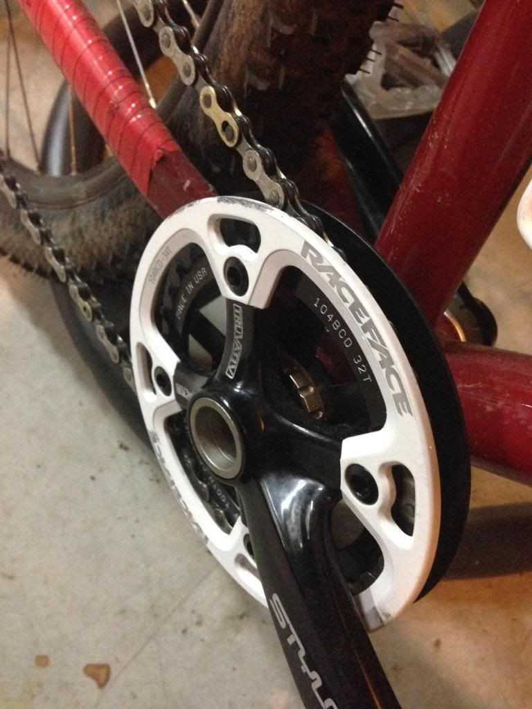

    I just recently did the same thing. I first tried removing the inner and outter chainrings and locking the derailleur in the middle. That didn't work well at all, chain fell off all the time. So i added a "jump stop" to the inside, a bash guard to the outside, and removed the derailleur. Better, but still crappy.
    My 3rd and final attempt, that has worked flawlessly was to buy a wolfstooth chainring, an inner "bashguard" from BBG, and keep my outter bashguard, making a sandwich. This was all mounted to a 3 ring Truvativ Stylo.
    It's the bashguard sandwich technique which supposedly works well on it's own, but combined with a wolfstooth chainring which is also supposed to work well alone, it's perfect. I mean I didn't drop a chain the rest of the summer.
    The chainring is a 32 tooth, both guards are sized for 34.
