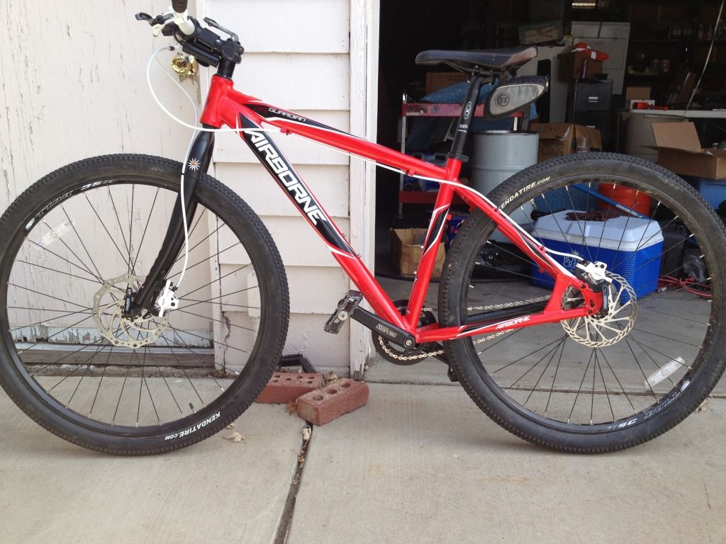

    Post Your Modified Airborne Bikes
    This is my Guardian, i've had it for about 4 months and have already started tweaking it.
    Main mod was the conversion from the stock 3x9 to a 2x9 by removing the largest chainring and replacing it with a bashguard.
    I broke the x5 RD, and replaced the front and back with x7 sram stuff.
    Upgraded the front tire with a Kenda Nevegal.
    and installed the BIONICON C-Guide.
    So far the bike has been great, it has been a great introduction to the mtb hobby. Let me know what you think.

    Red bikes are always faster. I like it!
  • 09-05-2012
    Barheet
    Love it! How's the new tire working for you up front?
    At first glance, I thought the SB8's would suck, but they are amazing. Doubt I'll be upgrading those until they wear out.
  • 09-05-2012
    Wildfifty
    Thanks guys!
    I really like the SB8's too. But they don't provide any puncture protection. So after 4 punctures, 3 in the front and 1 pinch in the back i got frustrated and picked up the beefier tire on the front. i have only had it on there for about a week. So far so good. i feel i can lean more into corners and bankings with it upfront.

    i like the chain guide. why do you go with it? never seen one before.
    what size?
    whats your stats?
    how you liking the X7's?
  • 09-05-2012
    Lenny7
    What is the purpose of the chain guide? I thought they were for single speed and what not.

    The chainguide can be found here Bionicon USA C-Guide Chainguide
    It prevents the chain from bouncing around and falling off the front chainrings. since i have used it i have not had the chain come off even once.
    My Guardian is an 18 inch, im 5'7 165lbs 30 inseam.
    the x7 fd was def a noticeable upgrade in shifting and rear tire clearance. the rd i havne't noticed any major difference between the x5 and x7.

    Did you have to get a new chain for that drivetrain?

    no, but i feel i might be able to shorten it some to get even better shifting. i need to figure out how to remove some of the links.
  • 09-06-2012
    max-a-mill
    if you remove some links you should be able to ditch the chainguide.
    you shouldn't need that extra bit of resistance in your drivetrain if it is properly setup but if you like it go with it.

    Here's mine fresh off a 25 mile ride this afternoon. Changes include the Reba fork, tubeless conversion, and Ergon grips. I'm halfway through my 1x9 conversion but Amazon sent me the wrong size jumpstop, so I shortened the chain anyway and ran it as is in the middle cog. Didn't have any jumps all day. Also noticed a huge difference in weight. Ran the whole 25 miles without going into my lowest gear and it climbs like a rocket now.
    However, I got the tires a bit too low. If you look close you can probably see where I burped out some sealant on the back tire. A friend told me to run it less than 20 PSI. That's what I get for following a friend's advice, eh? I think 24 PSI is about right for me, especially since they are stock rims and tires.
    Fork is running very well. I bottomed it out running 120 PSI so I filled it to 140 PSI and you can see it almost bottomed out but not quite. Still a very nice, cushy ride.

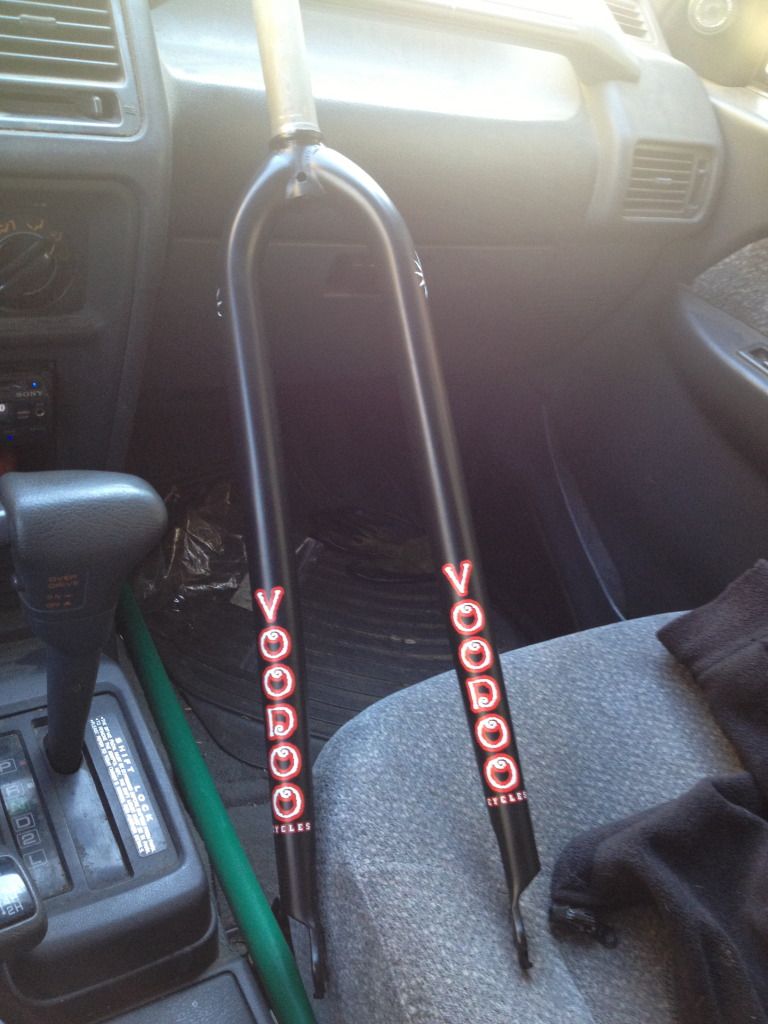

    just completed the conversion to SS, pending a full ride!
    I swapped in a rigid Voodoo Zombie fork. while taking things apart, i decided a good bath was in order! Also, ive been considering forcing myself to run 1x9, as this is the setup ill be riding my yelli in. well, one thing led to another, and it started turning into a single speed!
    so, the fork

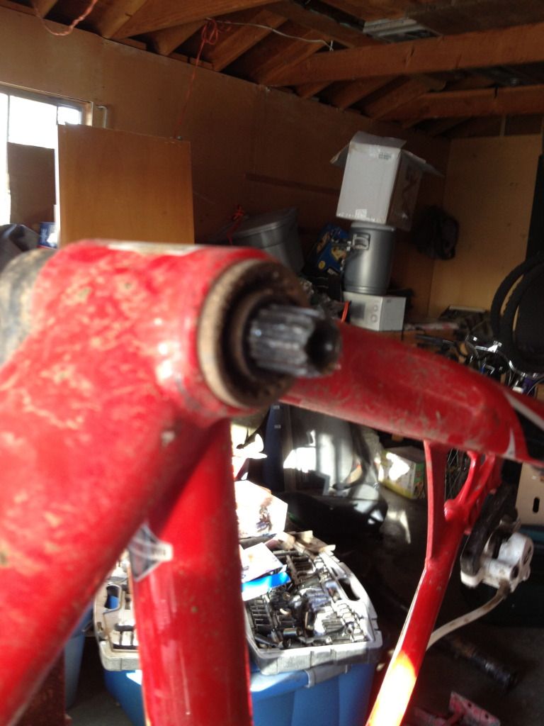

    the crank arm removed to delete the granny ring- swl7, i think you were tightening on yours, cause mine came right off!

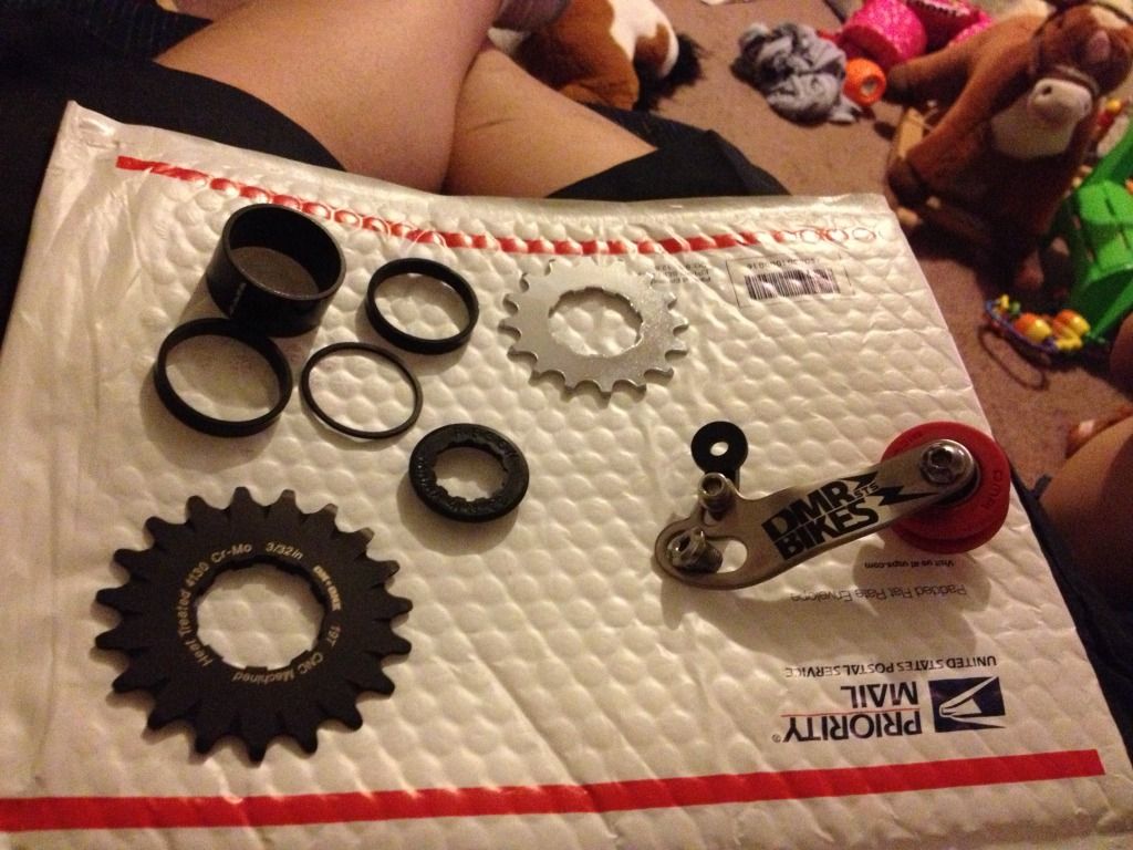

    Singlespeed parts!

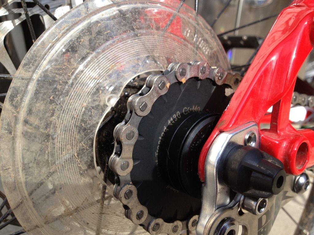

    On-One Armada 19t cog, very nice gear! tonights ride will dictate if a 20t is a better idea!

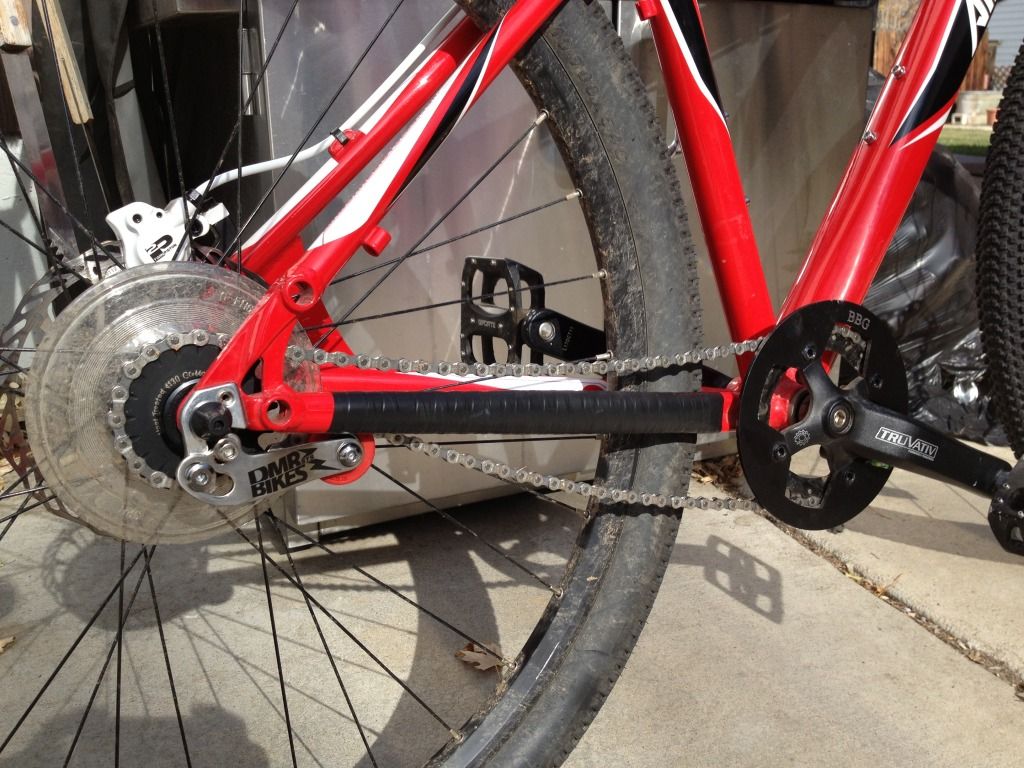

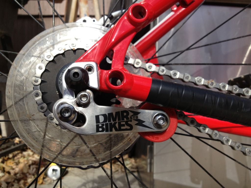

    DMR sts tensioner. very nice product! i do believe that i have to much slack, but its fine for road so far. will see with a bumby downhill tonight if it will drop. if so, ill have to buy another chain, cause ive read that SRAM chains are not very half-link friendly.

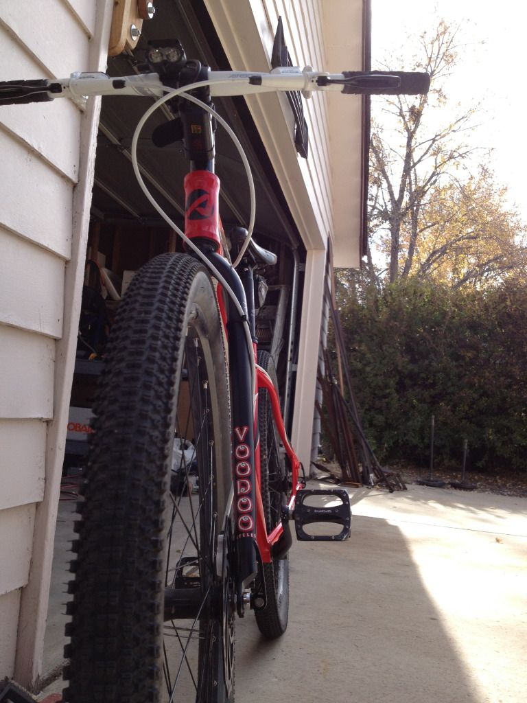

    A little night ride love! seems good on my street so far. Cygolite Pace 350

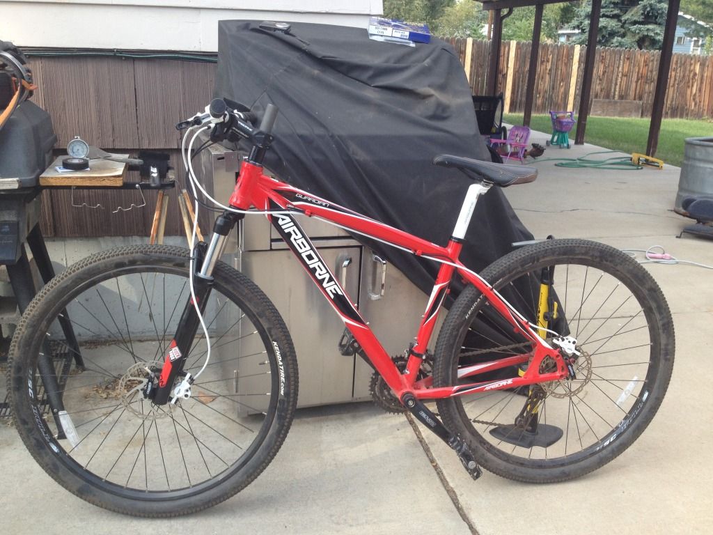

    BEFORE:

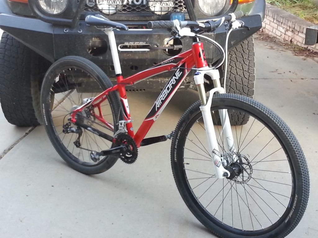

    AFTER:

    Looks good~
    Why would you need a half-link? The tensioner should eliminate that need. Looks like you need to take a full link out and you should be OK.
  • 11-08-2012
    zukrider
    thanx Jeremy. a full link is 3-4mm to short to reach. a half would be perfect! but if tonight dictates to get a 20 or 21, then i wont need the half.
    this is with the tensioner in full up position. full down was so loose the chain skipped under load. it rides fine around the neighborhood, just not sure of the trail yet!

    nice, it looks great. I'm pretty sure I was turning my crank the correct way to loosen it :) i'm sure it's just different per bike. Maybe might was extra tight whoever/whatever put it on.

    BigDaddyFlyer
    Hmm, OK. With that much slack it certainly looks to me like a link out should be near perfect with the tensioner, but photos can be deceiving I guess.

    Chain is Definitely too slack. It might not derail, but it will bounce around and more than likely skip under load. If a half link won't do, I'm sure there's a gearing ration you switch to. There used to be some sort of calculator on Sheldon Brown's website that you could punch in your chainstay length and and desired cog or chainwheel. It would return a range of gearing ratios that would fit.

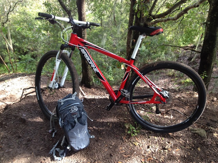

    h3hound
    goblin mods for the coming marathon/xc season
    still having fun on the Gob. lightened some components on the front end and can feel a difference. running 110+/95- in the reba but may tweak this with more neg pressure (i am about 165lbs).
    last month's changes:
    easton EA70 seatpost
    carbon riser bar
    carbon/aluminum road 90mm stem
    pro lock on grips (lighter with single lock-on collar)
    avid juicy ultimates with carbon levers
    earlier mods:
    conti race king front tire - tubeless
    kenda sb8 rear tire - tubeless
    easton havoc 80mm stem (replaced)
    fizik cx seat

    so the ride last night was fun! definitely need a taller cog, so the half-link is a none issue at this point. will try a 20 and 21. maybe even a 22. hill climbing is not real easy! should make me super strong though!
