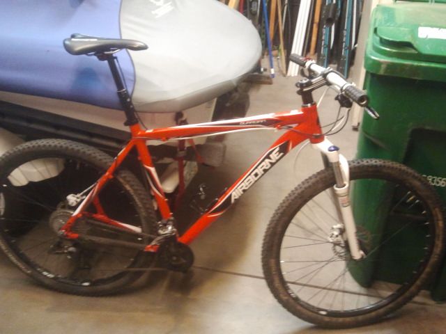

    I got an amazing deal on a Manitou Circus Expert. Just finished getting it set up on my Wingman.
    FR30 Laced to a 20mm Sun Ringle Jumping Flea
    and a Cane Creek 44/40EC headset to adapt to a tapered steerer.
    Dropped 2lbs. Taking her to the bike park tomorrow.

    Looks awesome! Did you obtain a new front hub, or have the flea laced in to the wheel?

    I had the flea laced into the stock wheel. The flange height was the same so they reused the stock spokes. Got a steal on the hub too. Not a lot of demand for 36h hubs I guess.

    Nice, I did the same thing - couldn't find a (decently priced) 20mm front wheel/hub combo...

    Yeah, and the FR30s are pretty solid wheel and not too heavy.I'm happy. The tapered steerer and 20mm axle have really stiffened up the front end, and The circus is a sweet, highly adjustable fork. I'm all about the ABS+ damper.

    This is a crappy pic, but I just got done mounting my Flow's (Tubeless) and wanted to share

    ^^^^ sweet hobgob! Whered you get the wheels from? What hubs? I have a stans no tubes kit waiting for my nerves to install on the stock wtbs. How's the bike handle now?

    Is that the flow ex/hope pro wheel set?
    I just put that wheel set on my goblin and love it. Probably a little overkill for my size (180ish) but I like the width.
    How much do you weigh?

    Quote Originally Posted by hedz0r View Post
    Sent from my SAMSUNG-SGH-I747 using Tapatalk 4
    I got the wheels from Merlin Cycles from the UK. Took about 8 days to ship to the Midwest US (MO). They are Hope Pro Evo 2 Hubs. I'd say go for the conversion. I did ghetto tubeless on the i19's and Maxxis tires easily. I moved the Maxxis tires over to the Flows and re-mounted the AKA's to the i19's. Haven't finished the AKA tubeless, but I'm sure it'll be fine. Honestly I'm not sure how the bike handles with the Hope Flows. I took that pic and posted it right after I finished mounting the wheels. And the constant rain is keeping me from riding Ill follow up when I get out on the trails.

    Quote Originally Posted by trevor_b View Post
    That is exactly the set pictured Ordered from Merlin. I weigh somewhere between 210-220 geared up. Probably still overkill for me but the arch ex's weren't in stock and I was ready to buy with their 10% off sale and free shipping. I can't wait to thrash 'em

    Finally got it right where I want it!
    -Stan's arch ex/hope pro 2 evo wheels
    -race face narrow wide chainring, set up 1x10
    -race face evolve bars
    -easton ea90 stem
    -esi chunky grips
    -wtb volt saddle
    -sram team bb
    -on my second set of aka's (the folding bead version this time), set up tubeless. Love these tires!
  99. #399

    Viking, looking great. Really like the look of the matching color grips. What type of surfaces are you riding the AKA's on? I lack some confidence in them over certain terrain... some positive reassurance might help.
  100. #400
    Reputation: 8iking VIIking's Avatar
    Dec 2012
    1,252
    Re: Post Your Modified Airborne Bikes
    I ride mostly hardpack and loose over hardpack. Forested trails so there's leaves and pine needles on the trails sometimes. I just love how those hard little knobs seem to penetrate thru the loose dust or leaves and bite into the dirt
    The tires take some getting used to, as they have a more rounded cross section than most. You can really lean the bike into the turns and that's when the tires shine.
    I feel like the tread pattern might be lacking when things get really loose (kitty litter, gravely type stuff), and they're terrible in the wet, but for 99% of my riding they're awesome!
