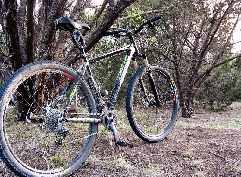

    Sleevem1
    Here's a pic with some new rubber on my Goblin. The trails are just starting to open up where I live and I'm hoping these HD's will do the trick for runnin in the slop. If not I may have to step it up and go for some Muddy Marry's. It didn't take more than a couple pedal strokes to realize the rolling resistance is a wee bit more than the Geax 2.2's
    Attachment 794303
