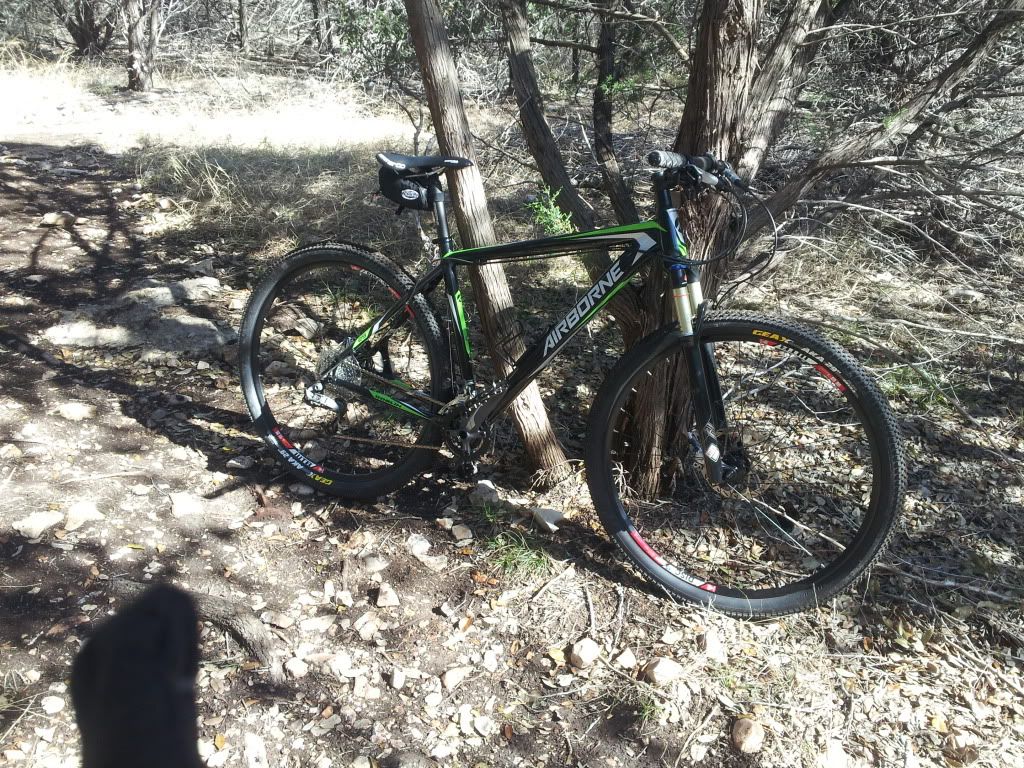

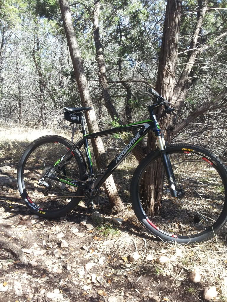

    Had a good day on the Goblin yesterday. I started off the day with 20 miles on the road bike, which is a lot more miles than I have ridden in a LONG time. So I was already tired when I decided to pack up the Goblin and head out to Chestnut Ridge here in central OH. I hit the "easy" trail with my son on his BMX bike Saturday, and Sunday I decided I would go for the "difficult" one. It was brutal, mainly because I was tired and out of shape :). I was still amazed at how slow the 29er can crrraaawwwwllll and not fall over. I also trail ride dirtbikes and can use the balance training, it was fantastic. The X7 shifts great, even under strain, and the 2x10 is also a great match to the 29" wheels. Just put 'er in low and shift the rear as necessary. Perfect. If I had to pick some nits I would say the grips are slippery when wet and the seat is hard, both of which are highly subjective and easily changed. No real complaints here. The Geax rubber was great in moderate mud and dirt, I was actually amazed at how it didn't break loose in some areas when I was really grunting on the top ring. The brakes are really strong now after my adjustments mentioned earlier, although the front squeaks sometimes so I need to look into that some more (apparently the Avids are known talkers). Overall great bike!

    I had my first ride/shake-down last night and the ride was absolutely phenominal. Hands down, the BEST purchase I have ever made!
    Airborne at 6077 feet!
