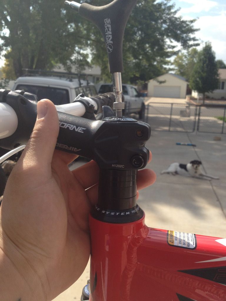

    Teardown. start by securing the bike in a bike work stand, boy i need one of those! pull the front wheel off. remove the brake caliper from old fork. then, pull the little rubber bolt cap at the top of the steerer. loosen the top 5mm hex that secures the fork to the stem, and remove the cap and bolt.
    now slowly loosen the stem bolts, while holding the fork leg up to prevent the fork just falling out. keep holding the fork, and remove the stem with handle bar assembly, lay it forward gently. pull the 5 spacers from the factory. now slide the fork out gently. the top visible piece of the headset will now be loose. dont drop it and lose it. also, there is a small plastic washer inside, it goes cone down incase yours falls out. mine was cracked, but i honestly dont see any performance issues with it.
    here comes the hard part. and if you are not confidant, take it to a shop to have them do it so you dont hurt the parts or yourself. the bottom piece of the headset is "pressed" onto the fok, and bottomed out the lower shoulder. i took a flat head screwdriver, and a hammer, and put the tip in the two slots and gave a good smack. alternating from slot to slot, smack until you get the collar to slide up a bit. then use 2 flat heads 180* from each other, pry up gently with both at the same time and shimmy the collar up. to install the collar on the other fork, i just used a flat head and a hammer and tapped gently in a criss cross pattern to move it down evenly until it bottomed out.
    again sorry for lack of pics, i planned to have all steps in pic so it was easier to understand.

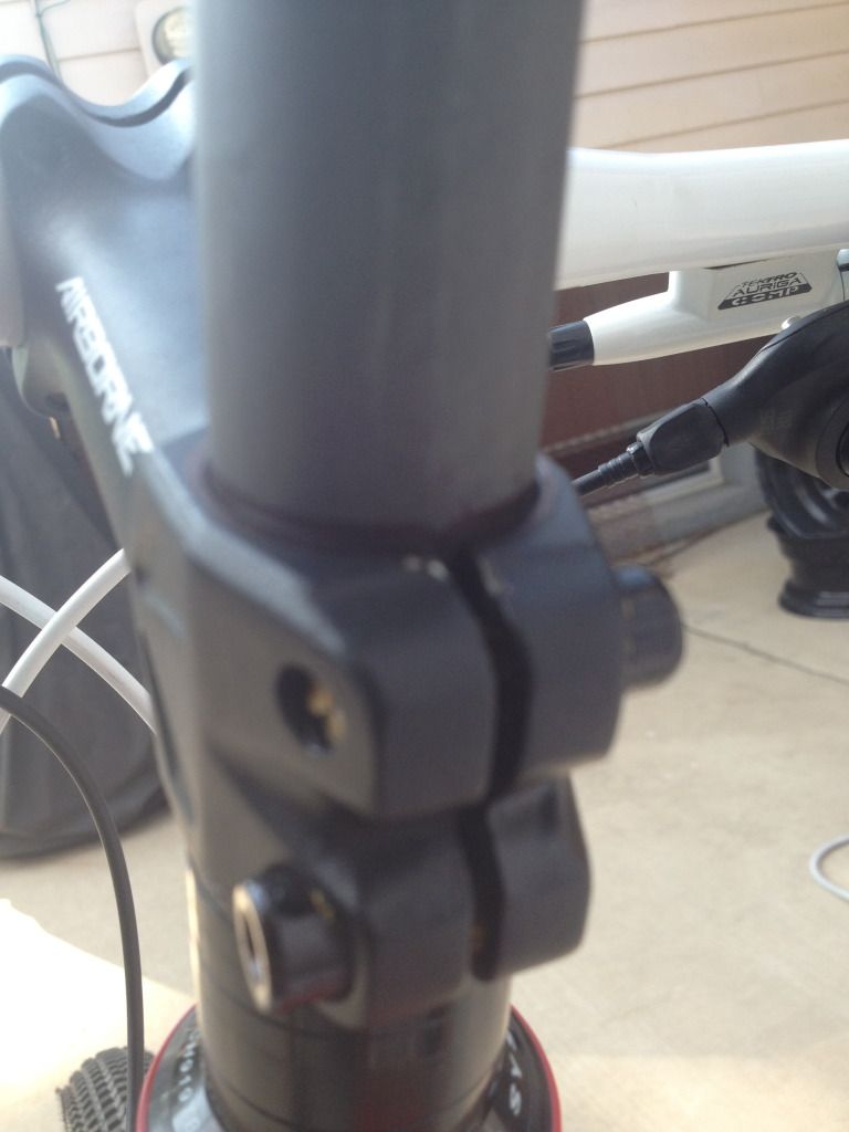

    now, reassembly. the steerer is way to long from the factory. it is this way to allow you to fit the bike to your needs. if you have no desire to change stem height at all, then just copy the steerer length on the old fork to the new, and cut it accordingly. i used a jigsaw, and would recc you use something with a longer blade. a hacksaw i feel would be more than adequate.
    should you not be sure, or plan to change, just stuff the whole thing in! reassemble the spacers and stem the same way they were, as a base for changes, loosely tighten the stem to allow the fork to stay put. install the wheel. put the bike on the floor, tires down to put weight on the assembly. give it a jiggle to make sure the lower head set is in position. push down on the stem and tighten the stem to keep it all tight. install the brake caliper and center it. make double sure it is all tight, and go for a test ride to see how it feels. dont like it? adjust the stem height and or change the stem. once it feels like you are positive the height will not need to go higher, scribe a line or use a sharpie to mark along the top of the stem. disassemble it and cut the fork steerer down.
    here is another unforseen issue i didnt expect. the top cap bolt has an anchor nut inside the steerer of the old fork. it is a pain in the ass to hammer out. then you must tweak the legs of it to be wide enough for the new fork, and beat it in so the top of legs are equal to before, bout a half inch. i think it would be a better practice to use a new nut each time, but im good with it, so no worries.
    now reassemble and go huck that *****!
