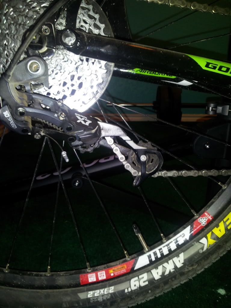

    It shifts fine, but I'm wondering what the noise is and is it increasing wear? (Ignore the awesome wall color/curtains)

    It appears to do it in at least the largest 4 cogs. I aligned the hanger last weekend and haven't knocked it since. Maybe I suck at using the DAG-2?

    Alright, I aligned the hanger as it was of a tad off vertically (I reread park tools guide so I'm confident it's aligned well).
    I then adjusted the RD, all points of adjustment and its shifting nicely.
    Now I only get that click on the big big combo only that I can tell. Any ideas?

    It doesn't click in the small big combo.
    Should the derailleur be this "stretched out" when in the big big combo?
    It still has spring to it if you manually move it forward.
    TXTony
    Guest
    No. That does not look right at all. Did you remove the cable when you aligned your hanger. Looks like a lot if tension going on back there.

    I just checked mine. It does get stretched but does not look like it gets stretched out like that much. I never run that gear combo but did notice there is a fair amount of cross chaining when it is up there on big and big. Usually in those bigger cogs in back you want to be on that smaller cog up front. The only time I ever seen a der get skewed out of whack is when the chain is to short. I know that is not your issue.
    TXTony
    Guest
    I think that gear combo is taking the chain to its limit. Basically it is as tight as it can get and us pulling the der or stretching it out like that. It really is not designed per say to be run in that gear combo. Usually you use your larger gears in back in combo with the smaller one up front. Use the large ring up front with the smaller ones in back. Prevents cross chaining. Where your chain gets out of alignment with the gears your running. You want to run your gears and attempt to keep the chain as straight as you can from from to rear. Once you get some cross chasing you start hearing the grinding of the chain rubbing on the front der. Right now you have your chain stretched out to its max. Riding it like that may cause it to break.

    I never removed the cable when aligning the hanger or doing the RD adjustments.
    I thought cross chaining wasn't a big issue on a 2x10 setup and it was ok to be in the big big combo (not the small small combo due to a lot of chain slack)?

    Think it is...I checked mine last night and pretty much looked like it can produce some cross chaining..my rear der was stretched out which is normal in that gear combo but as I never run it in that combo really never paid attention..on the other bike I am running a 2x10 I do not have that issue with the drive train but it is a totally different bike..full suspension and different geo and chain stays..on my cross bike which is a 2x10 I checked as well and it really has some cross chaining going on in that gear combo..It has been a long time since I have had a bike on the big gear combo in front and rear so really never have paid attention to it.
    I think if it is shifting good in the proper gear combos your good to to go..those(big to big) gear combos pretty much take your chain to their limit length wise..so it is as stretched as it can get..thus putting a lot of torque on your rear der causing it to stretch out like that...usually it is just the top 2 maybe three gears on the back with the big chain ring up front where you start seeing it becoming and issue. Pretty much the opposite of small to small...all the slack has been pulled out and now it is tight as heck..another thing you could consider if you are wanting to ride in a gear combo like that maybe down the road putting bigger chain rings on up front...I have yet to ride my Goblin on the small chain ring up front..have not found a need for it..I have event thought of ditching the second ring and going 1x10 on it,,

    When I've previously undone the cable at the RD and connected it back I would just use my fingers to pull the cable snug then tighten the bolt.
    How could I check if the tension is too tight? Would I have to redo all adjustments or just indexing?
    It could be cross chaining but why would it just recently start making that clicking noise?
    Tony, are you a beast of a climber? Lol. I rarely go into the small ring up front but a lot of the time I'm in the big big combo for climbs (especially rocky technical climbs). I've certainly thought about going 1x10 in the future as well.

    looking at your pic please check out your b tension screw. SRAM reccomends 6mm between upper pulley and largest cog with small chainring up front

    It turned out to be a chain that was too short. I spoke with Jeremy earlier this week and he said that it was possible sram sent a chain to the factory that was too short and wasn't caught during assembly.
    He said to take it to a shop and have them cut a chain a link longer and they would reimburse me any out of pocket expense. I definitely wasn't expecting him to say that since it wasn't really airborne's fault. So once again, airborne amazes me with their exceptional customer service.
