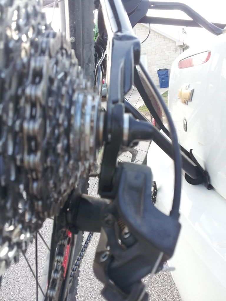

    Does it look bent to you guys?
    If so that would make it bent two days in a row. First time (yesterday, then went for a ride and had to bail and the bike landed on the non drive side) I paid a shop $20 to realign the hanger, then today I shifted into the largest cog and it threw the chain off the cassette into the spokes (or into that plastic protector thing). I then checked the hanger and it appears bent to me but I wanted other opinions. I won't pay that much to have a shop realign it again. I might just break down and get the DAG-2 unless you guys have another idea?

    Looks bent dude. Usually the rear derailleur goes into the spokes though when it is bent..when it gets tossed off the cassette into the spokes sounds like the limit screw may be letting it got to far over..but that does look a little bent

    That's definitely bent.
    The shop should have adjusted the L screw when they worked on the RD hanger. Obviously they didn't, because the RD shifted past the largest cog and got hung in the spokes, which bent the RD hanger once again. It's designed to bend in that situation.
    It's not bent very much. You should be able to bend it back (gently) by yourself then check the L limit screw. Set that correctly and it shouldn't shift into the spokes again.
