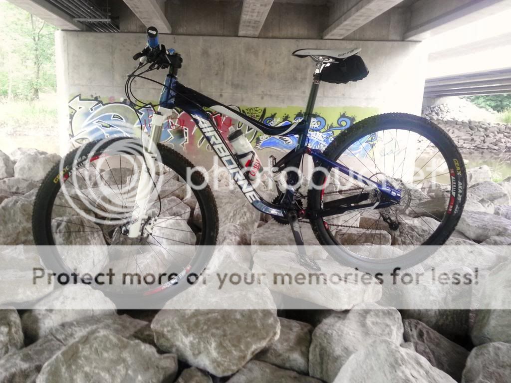

  19. #344
    Jul 2013
    66
    We the people ...
    Got my 17" HobGoblin X7 today! got it all assembled and slightly upgraded (carbon bar, carbon seat post, chain stay protector, lock on grips, shorter stem (white stem is ugly imo). Had to tweak some settings on the front and rear derailleurs since both seemed to be off. And I'm still trying to dial in the reba fork (dual air is confusing...) and monarch shock. I have it set pretty well now but i know some more tweaking will happen before the weekend. I did get a short ride on it today (5 singletrack miles) and it was like riding on a cloud compared to my hardtail.
    I think I will be very happy once all the tweaks are made.
    Thanks Airborne!
    -EDIT: I hate the avid elixir 3's... stopping power on the front seems lacking. Hopefully some XT's or SLX brakes are in the works, but that will have to wait until next month when i have spending money again
