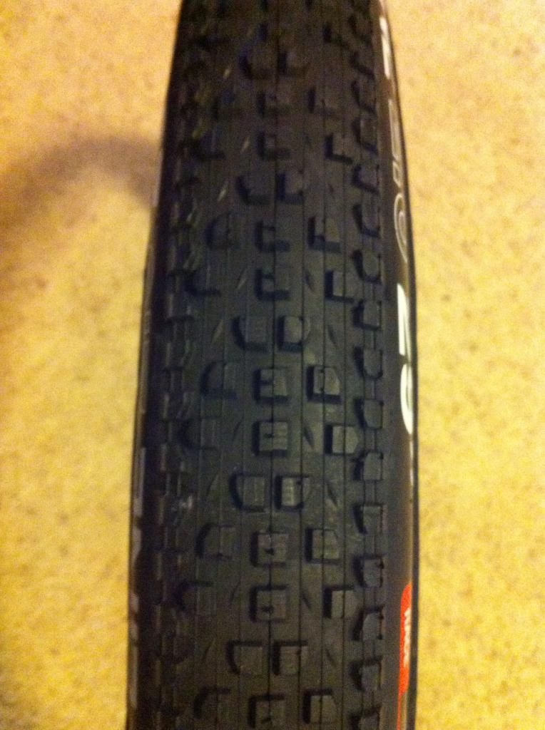

    Well the Nineline arrived today, at 2.0 wde its a pretty small tire, no where near the Racing Ralph in terms of volume.
    The tread and size does remind me of the ikon a lot.
    Weighed in at 535 grams which is lighter than both my last Ikon and racing ralph (impressive).
    Im expecting much in the way of rolling and grip of the similar Ikon. I will report back after its maiden voyage...

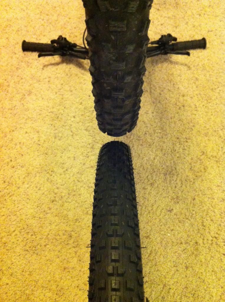

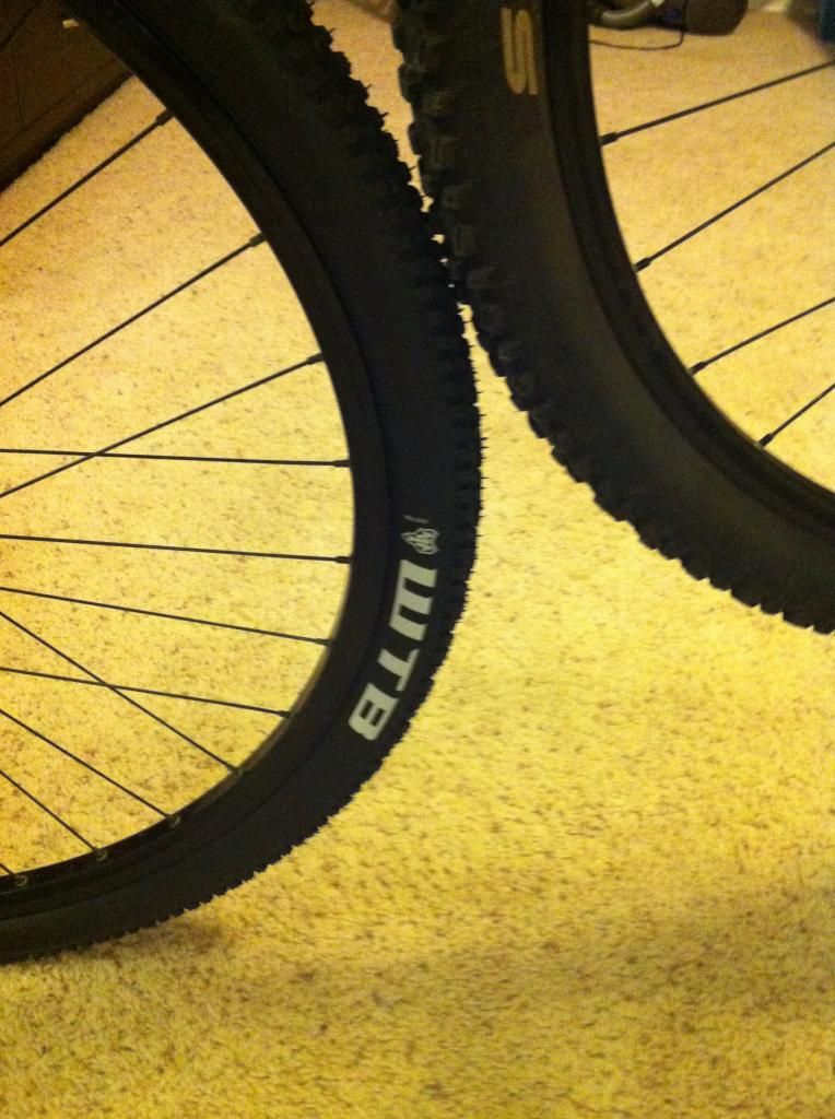

    Sorry to say but the Nine Line will not make it as far as my local trails
    Trying to air them up tubeless was a total bust. They are the only tire I haven't been able to air up tubeless even with lots of sealant, just wouldn't stay put, ended up blowing about an ounce of sealant out of the bead before I quite (leaked like a siv).
    Ive run 2.0 tires before and still never had one this tiny before. This tire make my 2.1 Ignitor look like a high volume! It literally looks like a baby tire compared to my 2.25 RaRa and NoNi. The pictures below don't even do it justice how much of a difference in volume, but you get the idea...
    So for me its just not going to work, This baby is going back to where it came with prejudice.

    Not a tubeless tire and comparing a 2.0 with a 2.25? Your results are what I would expect.

    And this tells me more about the size than the 2.0 nominal width:
    TIRE SECTION WIDTH: 50mm
    TIRE OVERALL WIDTH: 48mm
    http://www.wtb.com/products/nineline
    When the tread is narrower than the casing they always look smaller.
