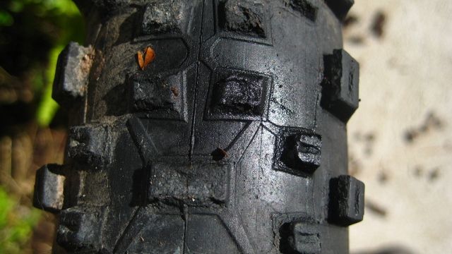

    i'm going to post a pic-it's waaaaaay too uniform to be a bead weep, plus if I wipe it down and away and go for a couple of rides it's back again
    Reputation: bikeface.killa's Avatar
    Oct 2012
    16
    okay, here's a close up-mind you that it is ALL THE WAY around the tire-both sides. I haven't put in any stans in at least 8 rides. Notice that there is none on the bead-only the sidewall.

    It's coming from the inside of your tire, I'd bet a paycheck on it. Clean it up, add 10 psi (or more if you're slogging it) next ride and see if it happens.
    Process of elimination rules out everything else: No suspension linkages, derailleurs only on one side, cassette only on one side. Pedals, maybe, highly unlikely, do you have any lube leaking out of your pedals? The pattern follows the tire deformation. It's not coming out of thin air, that's for sure.

    okey doke, but I'm only going to add 5, hardtail with my light belly =ping pong.
    you're probably right, I did notice that the deformation lines were the same.

    I think these tires were made on a Friday. The inner threads were contaiminnated with oil some how and now it is bleeding through. Check out this video.

    It's Stan's sealant. I have a similar appearance with small thorn holes on my rear tyre. I'll take some pics tomorrow. By the way, it looks like you've been running the pressures too low which causes the diagonal wear marks. Unusual for the rear though.

    It's sealant coming through thin spots in the casing.

    Yeah I got those on a Maxxis Ignitor, both front and rear....Stans is the culprit...
    But I got em worse on the rear drive side and my chain does slap the tire, on downhills...even though I run dry lube as well it still gets on the tire.

    Stan's sealant coming through small cuts. No discernible pressure drop.

    Your captains are not UST tires are they? Common with non ust tires, especially Specially tires.
    Casing weep.

    My Specy tires do the exact same thing..just sealant making its way through the casing.

    I have the same issue. Nothing to worry about. Go ride

    I had the same problem on both my Captain control and Fast trak when new.

    The bumps are not the same thing as the OP is talking about; this is just weeping sealant.
