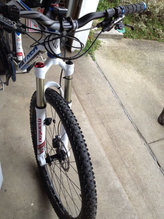

    I just got the Manitou Tower Expert in my hand. Hopefully I'll have it installed and riding tomorrow night but if not, definitely by this weekend.
    Jul 2013
    148
    Any updates from you guys upgrading to Mantiou's?
    I just installed a Manitou Tower Pro on my Felt 29er last week. Put about 14 miles on it last weekend on the trails. It feels like a totally new bike. The Tower is super user friendly, adjustments are straight forward for rebound and dampening. The ride is great and I like the lockout feature for those rare miles I do on pavement. It doesn't totally lock out like many others do, it's more like about 90% so it leaves just a little travel for those occasional little bumps you might encounter on the hard surface. It really responsive and the travel is very smooth. My Suntour fork that I took off the bike felt like a boat anchor compared to the Tower Pro. I'm really pleased with it.

    Just got my 13 marlin back with the new fork!!!
    Attached Thumbnails Attached Thumbnails Upgrade 2013 Trek Marlin Fork?-image.jpg
    If you hear banjo music, pedal harder...

    Quote Originally Posted by Jason2slow View Post
    how did you get hold of a g2 fork?
    RAKC
    Reputation: tigris99's Avatar
    7,128
    go to your trek lbs or get lucky enough to catch one on ebay. g2= 51mm offset
    Reputation: johnj2803's Avatar
    174
    Re: Upgrade 2013 Trek Marlin Fork?
    Quote Originally Posted by tigris99 View Post
    Thanks! I was able to get a RS XC32 solo air in G2 thru my trek retailer.
