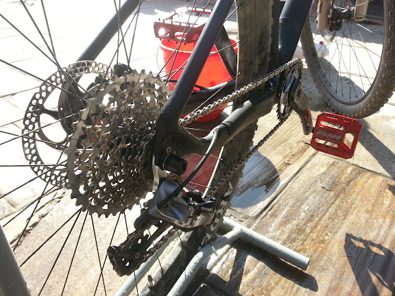

    After >80km, I lost the chain for the first time and it was my own fault. A half-inch-diameter stick found its way into the drivetrain. Here are a few pics of it mounted on my Chinese carbon 29er hard tail.
    Sent from my Nexus 7 using Tapatalk HD
    Rob, that's cheating and doesn't count as losing a chain in normal conditions. No, just kidding, seriously...I don't read something was damaged so lucky you! Would be a pity if you had to change de RD already....

    I don't know exactly what route it took, but it ended up trapped between the spokes of the rear wheel and the rear derailleur. It took quite a bit of twisting, wiggling, and finagling to get it out. The rear derailleur had to have taken a decent hit.
    Sent from my Nexus 7 using Tapatalk 2
    So there is hope it wont get shredded on first contact with pine branches.
