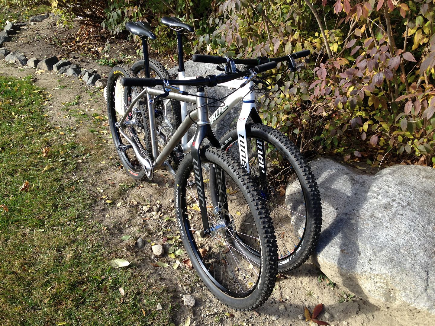

    I am running a Niner carbon tapered fork on both my mountain bikes, a Kona Raijin and a SC Highball.
    No problems for me, although have not ridden either bike with a 100 mm fork.
