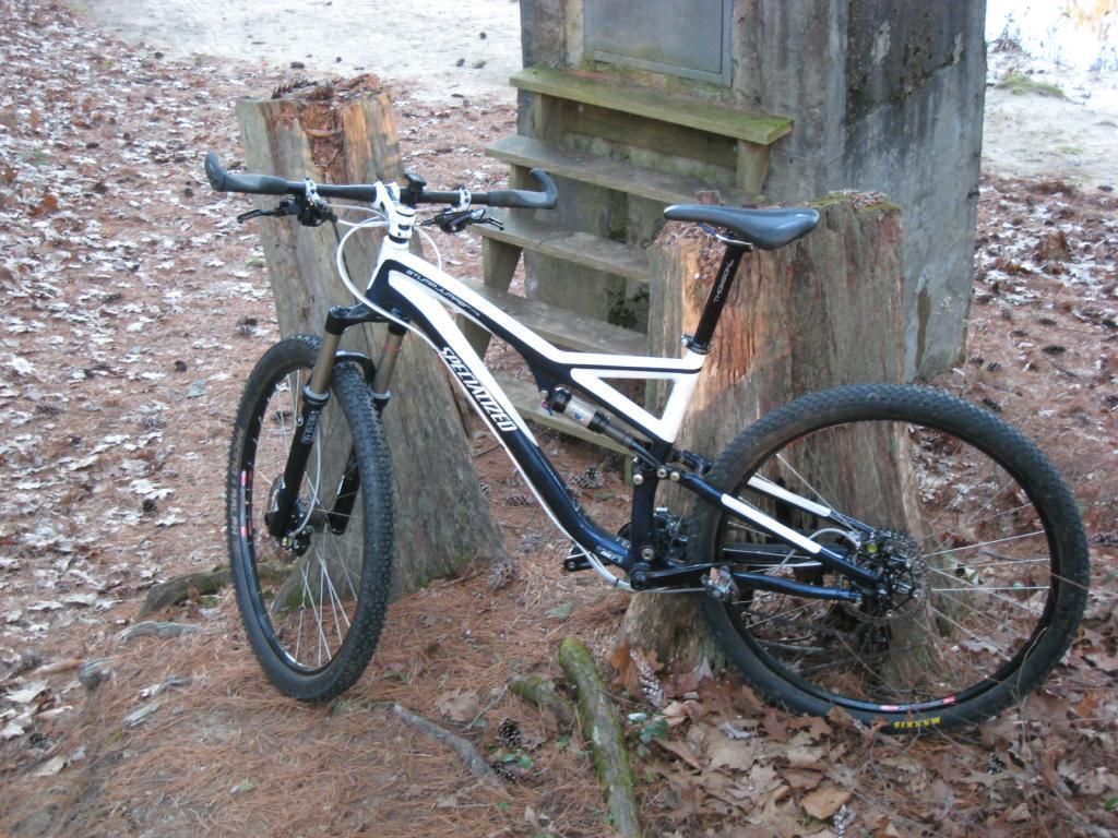

    Are you uploading the pics from your computer, or linking from a sharing site like Photobucket? If linking, all you have to do is paste the link, and then add your description below(or above, before you post the link), leave some space so that there's a break between the pics, and then paste the link to the next, then add the description, and so on.
    Will probably want top break the pics up into five or so separate posts though.
    As in:
    Here's a pic of my Stumpy
    And then, here's where I could paste another pic in.
