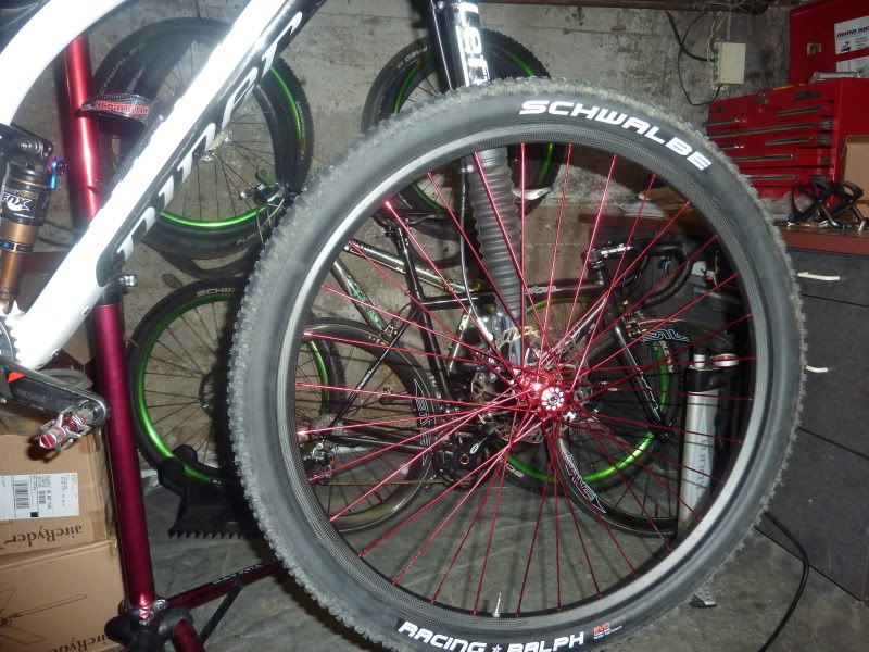

    As for LB's prebuilt quality, here is my very recent experience. I bought a set of 26" rims to build up myself a while back for my main bike, i liked them enough (as well as hearing everyone elses experiences) to buy a set of the 29" prebuilts for my rigid ss. I kind of wanted to see how the quality was and at the same time Id save some money over how i would have built them. I went with 881/882 with 9/10mm thru bolts and the standard bladed spokes they use. Just got them last week, and while not terrible, im kinda wishing id just bought the rims alone. The spokes on the rear were the wrong lengths by 1-2mm, with the drive side being on the long side and the nds being on the short side. Tensions also seemed a little low and not always uniform, which was an easy enough fix.
    I emailed nancy just to have it on record in case these spokes start failing, she said it was ok, that they have built hundreds this way. Im not all that worried about it, i went into it planning on upgrading hubs down the road anyway and will get new spokes at that time, just hope its not sooner than expected, or if it is LB will take care of me
    difficult to get a good picture
    Attached Thumbnails Attached Thumbnails (Cheap) Chinese Carbon Rims?-wp_000369.jpg
