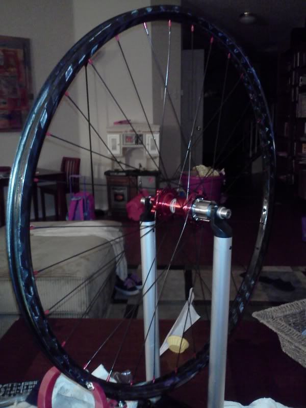

    I just built up my rear wheel, I am about 1mm out of true radially and laterally so I have to smooth that out. I do not feel it is too bad for my first effort. My question is I am not quite sure what tension to use. I have read through the thread and it looks like most people are around 120 kgf. I am a bigger guy, so is this an acceptable target for me using Sapim lasers? According to my park chart that should be 18 on the scale and that's where I am at now. Thanks for your guys help.
    The wheel is not tensioned in this photo for you sharp eyed folks

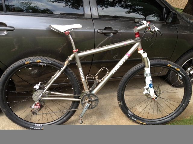

    Just took my first pavement spin on my new wheels. 32H UD matte wide AM rims beefed up for heavier riders, CK hubs with DT Comp spokes, alloy nipples, laced up by mikesee. They weigh in around 1800g, but feel extremely solid relative to the cheap hub, Arch combo I had on before. Hans Dampfs blew up with a floor pump and yellow tape, and after sitting on the bike for a while, the bead security is great. I had to take it down to sub 5 psi in order to snap the bead off. I will have the Rhythm strips just in case different tires don't work as well.

    Quote Originally Posted by Adim_X View Post
    Make sure you get it round before you do your final tru. It needs to be round 1st, then tru. A little hop in the round is o.k, but not big ones. Try and get it close. Also, pre stress the wheel often. Either grab 2 parallel spokes and squeeze, all the way around the wheel. Or take the wheel out and flex the rim. Google it to see how it's done. I can't really explain it in writing.
    Also, on the rear, I believe the drive side should have a higher tension than the non-drive side. It should work itself out that way when trued.
    Looks good, good luck

    My wheels are coming together well. I will give a ride report as soon as my other Chinese import project shows up, slow custom paint process.
    Build:
    12k Gloss, with extra material for Clydes
    Sapim Lasers and Sapim Nips
    Hope SS and QR Hubs

    I love it! "Made it Chine" on a $$$$$$$$$$$$$$$ US made frame, post and stem. Love the red accents.
