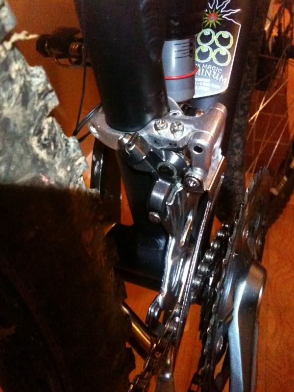

    Does anyone have an up close shot of a front derailleur on a '10 model? I put my x9 on and it doesn't seem to want to work. I detest how many different front derailleurs there are available these days!

    You need a top pull high mount front derail
    Yep, like this...
    That's just what mine looks like but it doesn't want to pull. It might be a bottom pull. I'll have to take a picture later.
    I am digging the bike though. It's almost ready to go. The shock and XX fork are really nice. The lockouts work great and I can't wait to get it on some mud!

    generally, if the screw is in the back and out by the chain/Driveside of the bike you have a top pull, if it's out on the non-drive side or back by the tire it's a bottom pull
    Wow, thanks Thom. I think I have a bottom pull.

    Quote Originally Posted by thechez View Post
    where'd ya get it? most places will allow an exchange... make sure it's not a dual pull as their mount screw is that same as the bottom but have a little cable guide which will convert it.

    It's an x9 I've had for ages. I know my Yeti has a dual pull XTR on it. I might swap it over just to try it out. Maybe I'll move the x9 to the Yeti as I know it works on that bike. I'll really get some detailed pics tonight after work. I really would like to get this out on the trail tomorrow but if not, no biggie.

    So these are my two current choices. Looks like I have a top mount top pull with a 34.9 collar. I also have an slx bottom mount bottom pull 31.6 derailleur. Looks like I better start looking for a top/bottom 34.9, no?

    ya, Like I said before, you need a High Mount, top pull,.. with the tube diameter (can't remember off hand but I believe it's 34.9..? (someone correct me if I'm wrong)
    this basically,.. need the top pull..
    Sram X.9 Front Derailleur High Clamp 2011 at Price Point
    Going to try and bring Trail Tire TV back. go take a look... http://trailtiretv.blogspot.com/
    I really wanted this done. So, I grabbed my dual pull off my AS-R. Why there are so many options is beyond me. I'm just gonna try to find another dual pull derailleur as a 34.9 to avoid this mess in the future. Thanks for all the help!
    Here's how it all turned out. I don't have the Stans wheels on yet as I need rotors for it still. So I'm using the Laser Discs with centerlock rotors(which, in my mind are the superior rotor design). It's been raining like crazy up here so it's gonna be a mudfest.
