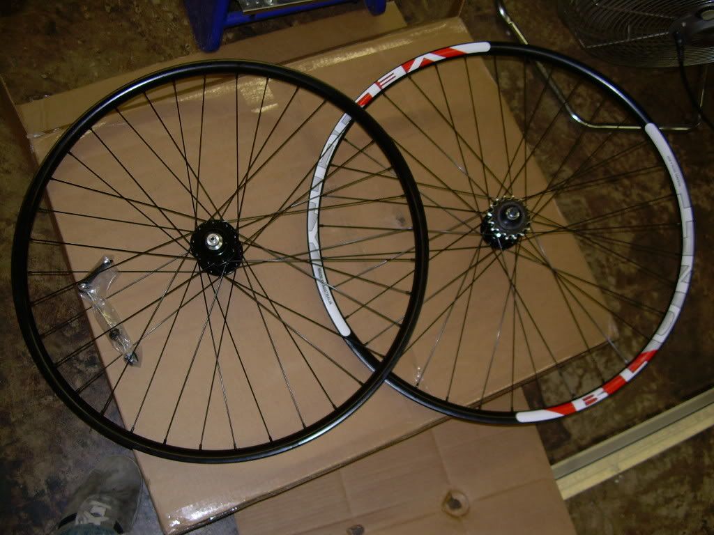

    these new Velocity Blunt rims are supposedly around 480g each. They look really strong. This set is mounted on my new frame, just waiting for a crankset to come in...
    any LBS can call up Velocity and order directly from them. The Blunt rim is not listed on their site yet.
