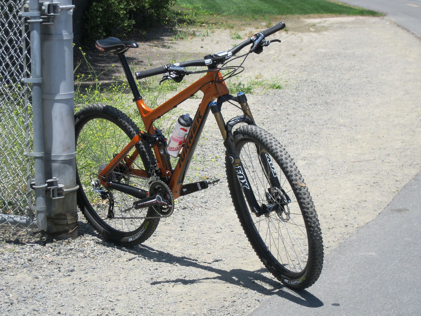

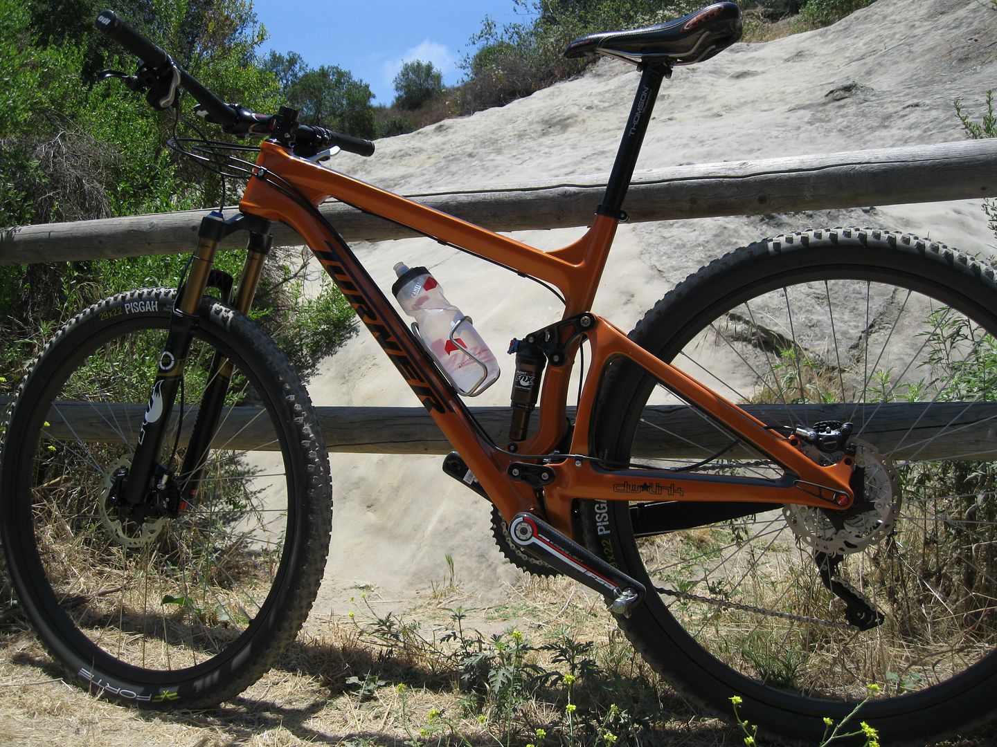

    Turner Czar Build Thread
    I got it!!!! I got one!!!!! I'm pumped! This is a very sexy bike!

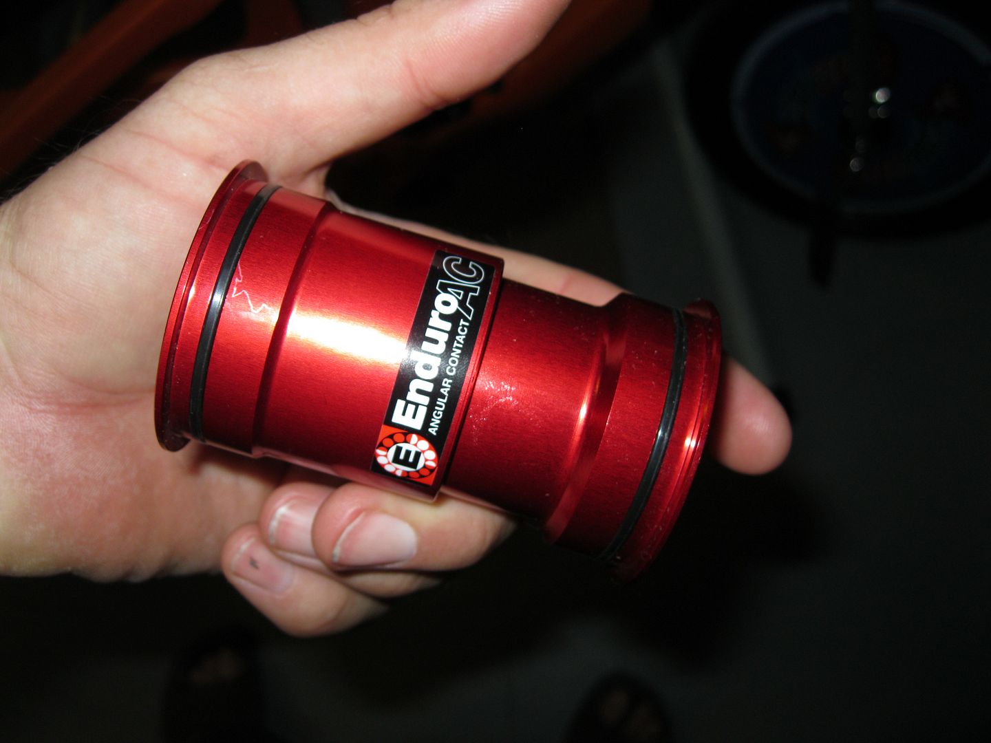

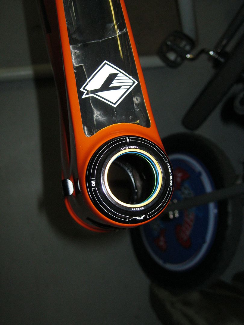

    So I'm starting the build thread at the bottom bracket, I'll post pics as I go through the build, if anyone has questions, post up, I'll do the best I can to answer them.
    Oh, frame details, it's a large, and on my digital scale, it's 5.57 lbs. That includes all the hardware that comes with the frame. Three of the screws, for a dropper seatpost, I wont be using.

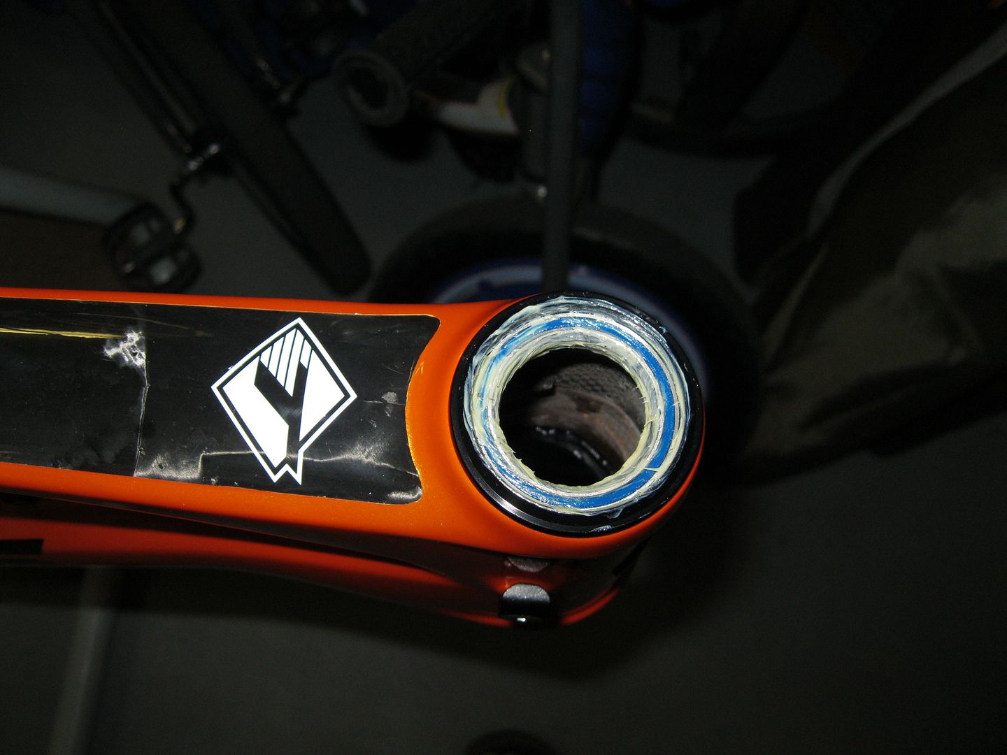

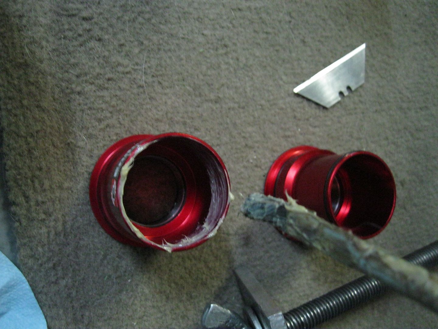

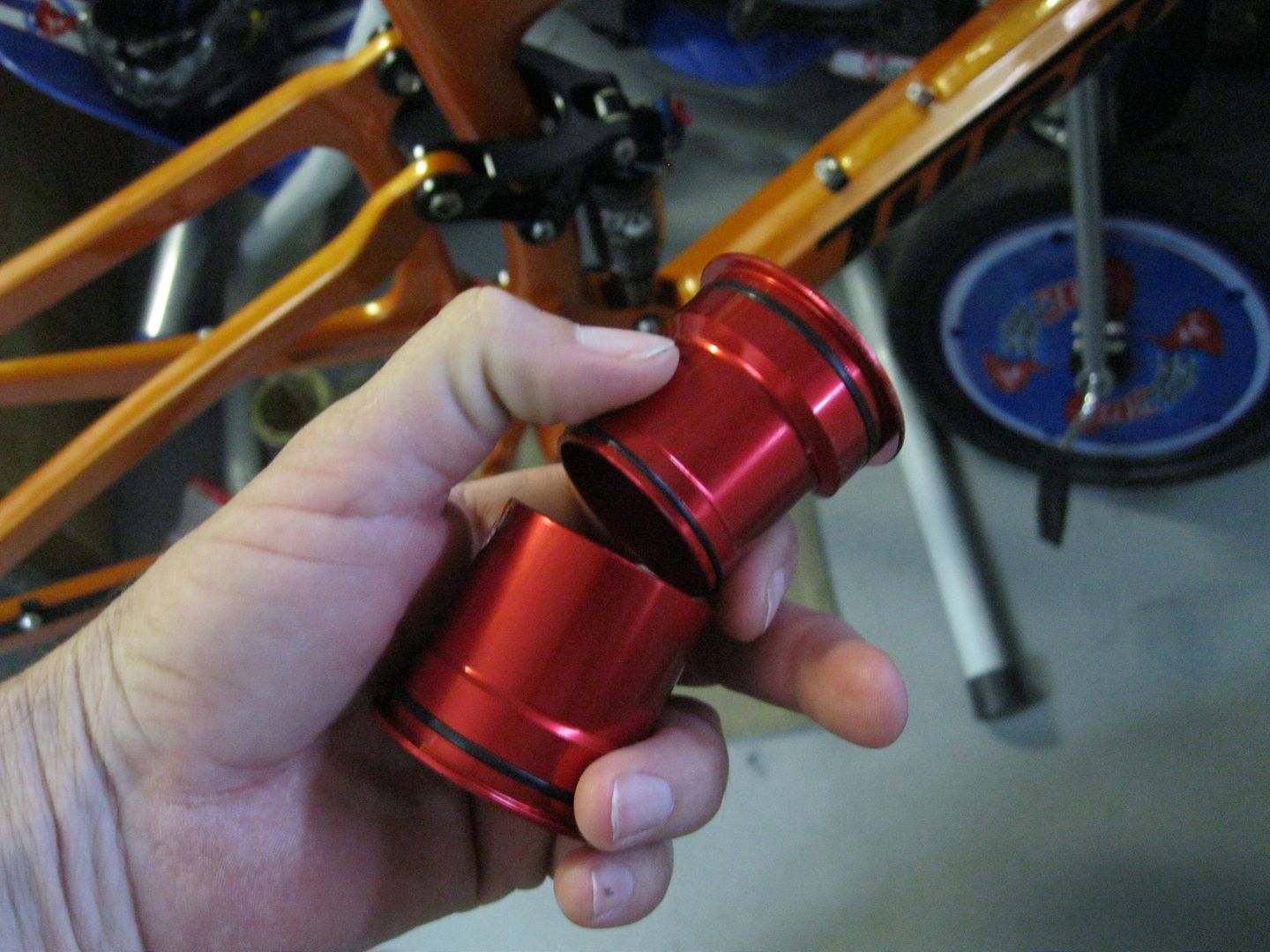

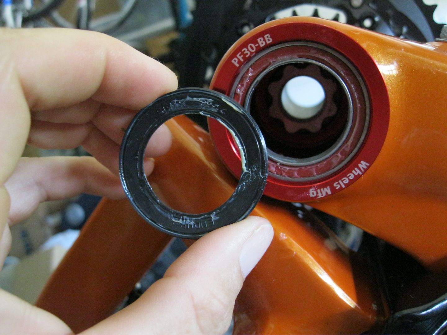

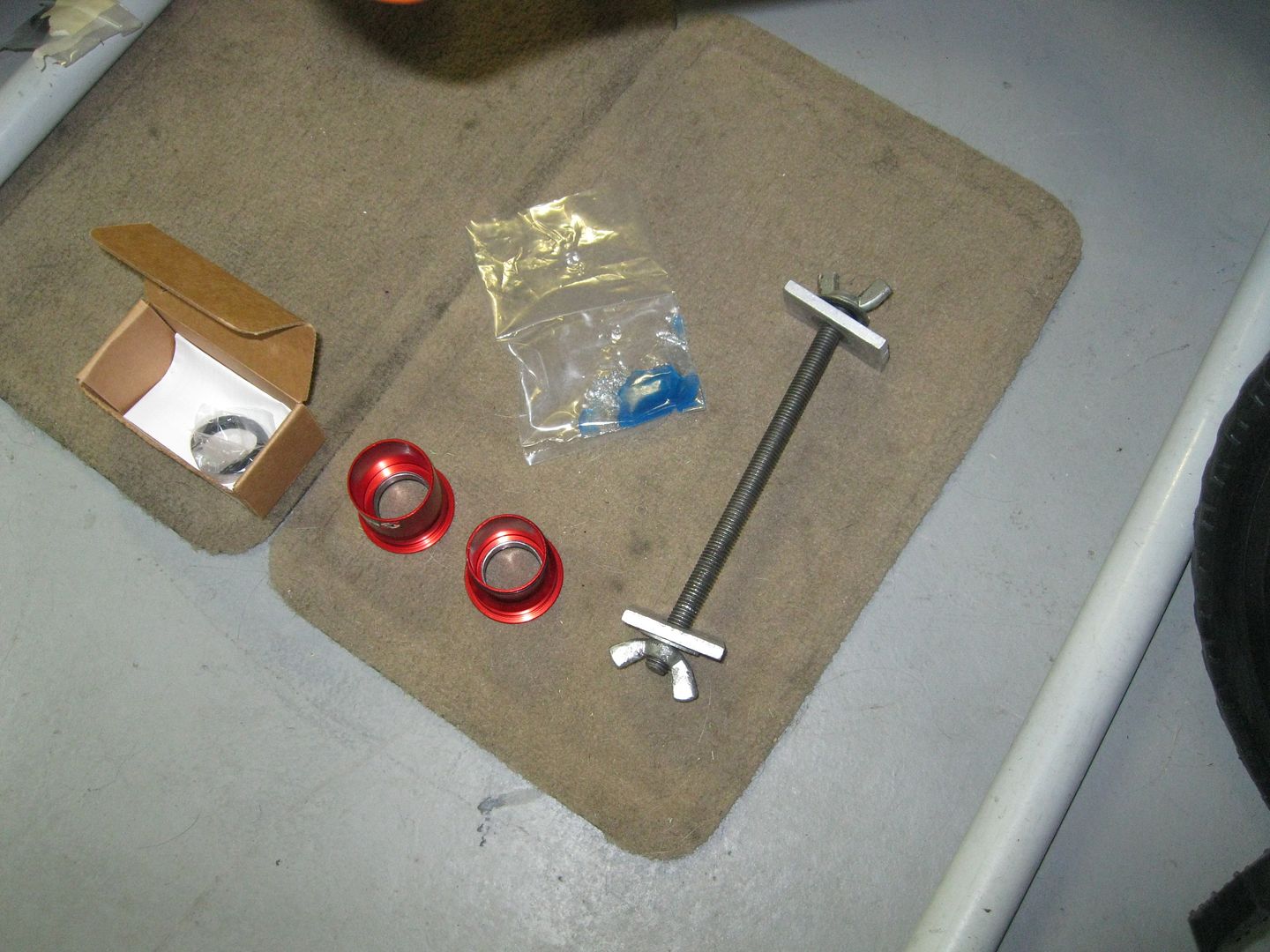

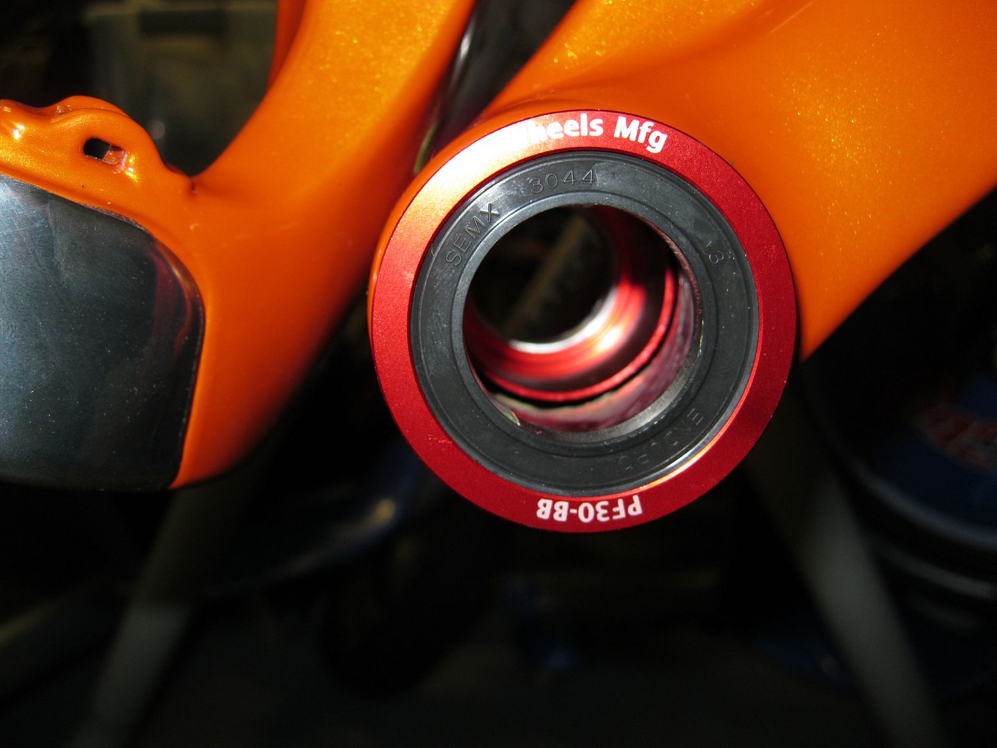

    So here goes, the Bottom Bracket is a PF30. Press fit 30.. Not a BB30.. There is a difference as I discovered. This is the BB I decided to go with..
    It's sealed too..
    So here's what you need to install one..
    That blue goop is like a sand filled grease. I guess the idea is that it "bites" into the carbon to keep it from slipping/creaking.. It'll go on the bottom bracket surface area, the headset, and the seatpost. I actually do have some experience with this on my roadbike.. without this or a carbon paste, seatposts slide down, and EVERYTHING creaks! With, it's all good.
    Formerly of Kent
    Reputation: Le Duke's Avatar
    9,133
    I'm fairly certain you are NOT supposed to put this anywhere near a pressed in part, such as a BB.
    Death from Below.
    Reputation: YamaDan's Avatar
    Mar 2011
    194
    I've discovered over the years there's more than one way to skin a cat.. That being said, I personally like a creak free bike. Headsets, BB's and pedals are often the culprit, and most the time, I track it down to a dry contact area. So, for my personal bike, I like the lube. But, I've been wrong before and I'm sure I'll be wrong again..

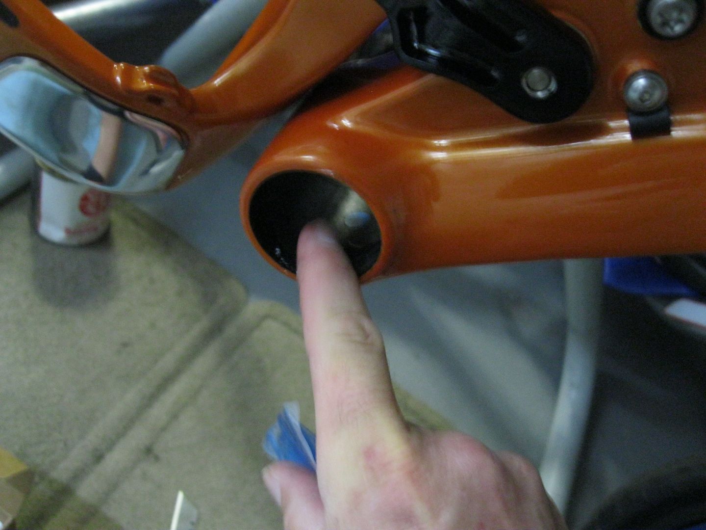

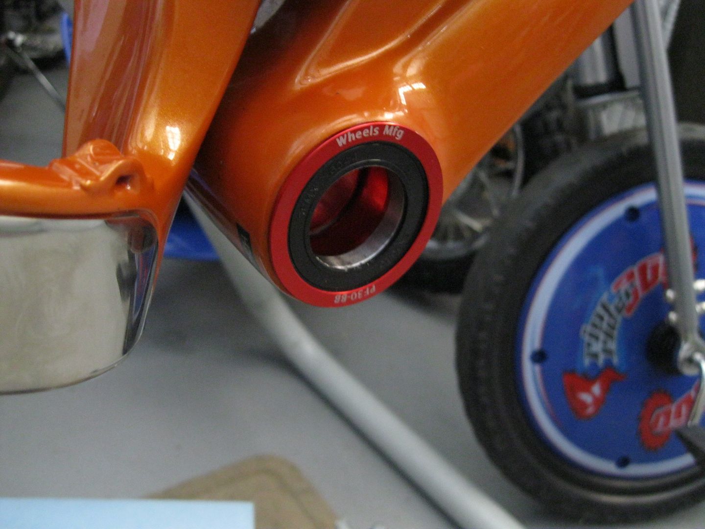

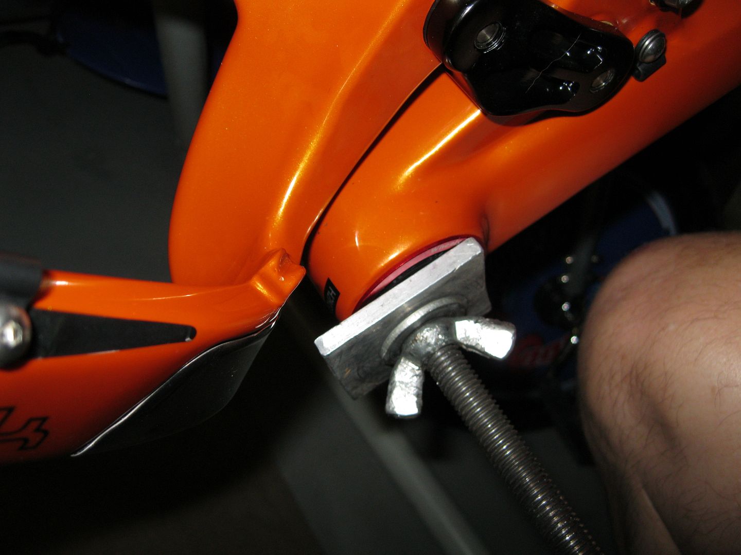

    So here, I prep the BB Shell with a little sandy lube...
    For the BB Shell, it is "sealed" with an o ring.. I still like to add a little layer of white wheel bearing grease. Makes things smoother and when you're pressing in the shell, you're not fighting the two halves.
    I like to line up the writing on the outside to where I want to see it.. it's not moving once it's in there..
    Make sure the shell of the BB is fitting over the other side, you don't want them pushing against each other..

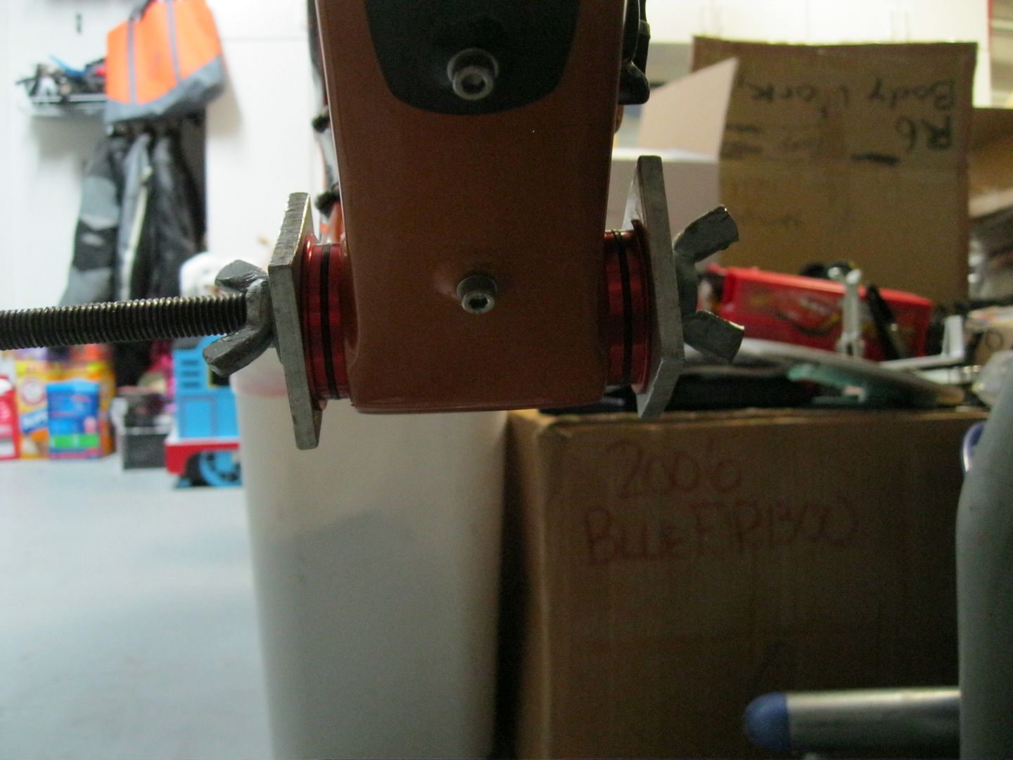

    Then take your handy dandy headset press, and line it up.. make sure the cups are going in nice and straight..
    At the end, they should be nice and flush..no gaps around the outside. If you have pressed in a headset, you can do this bottom bracket, it's pretty simple.
    Ta Dah!!!!

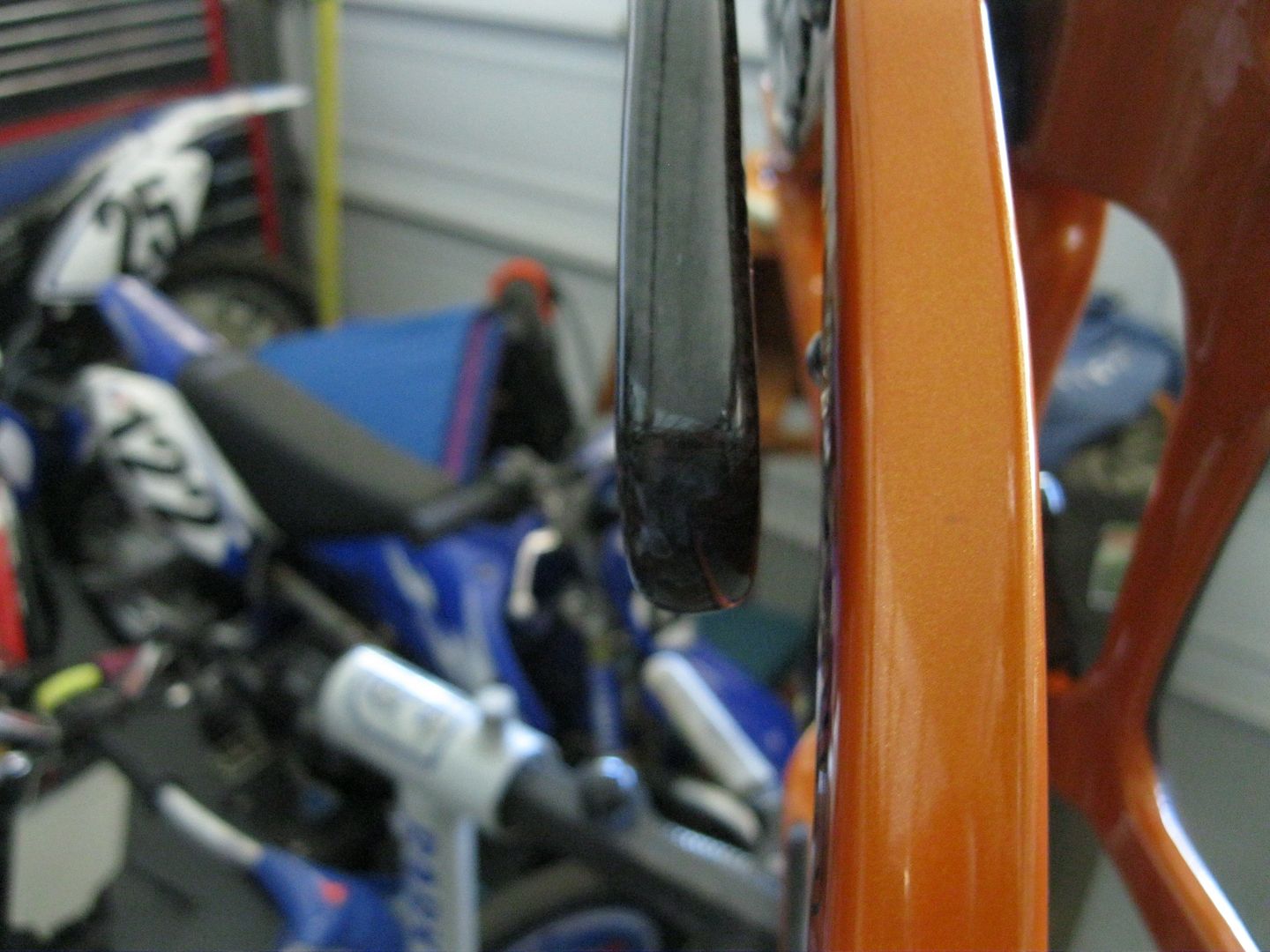

    Mar 2011
    194

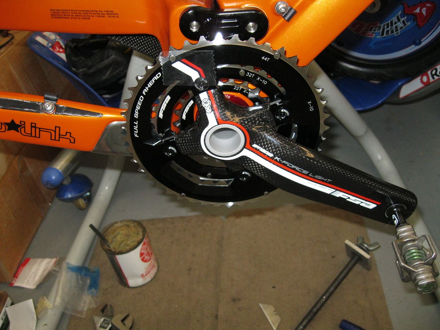

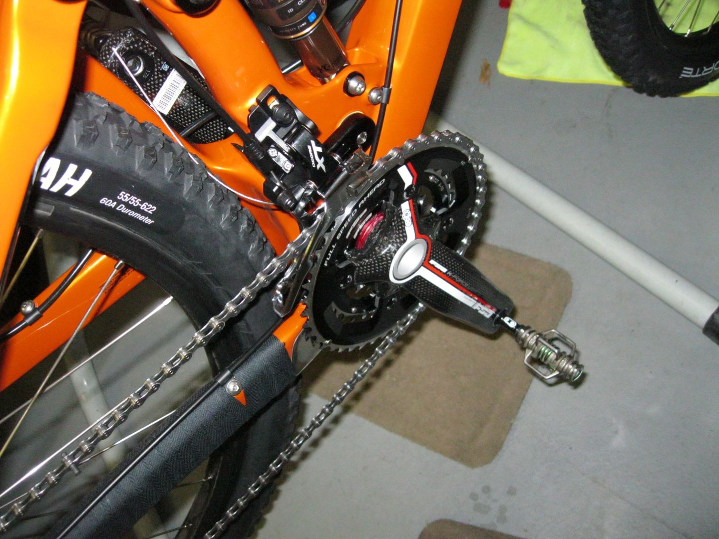

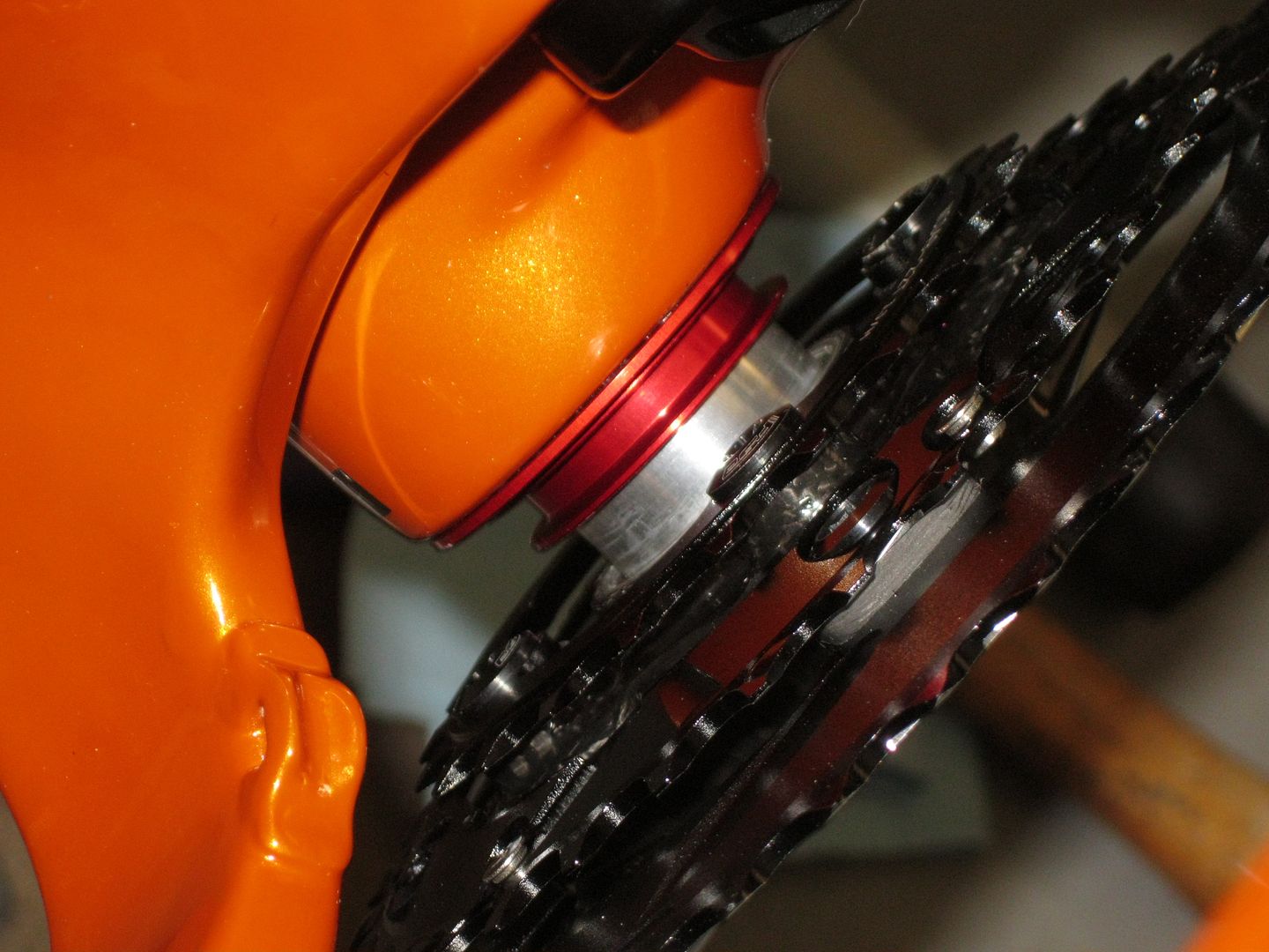

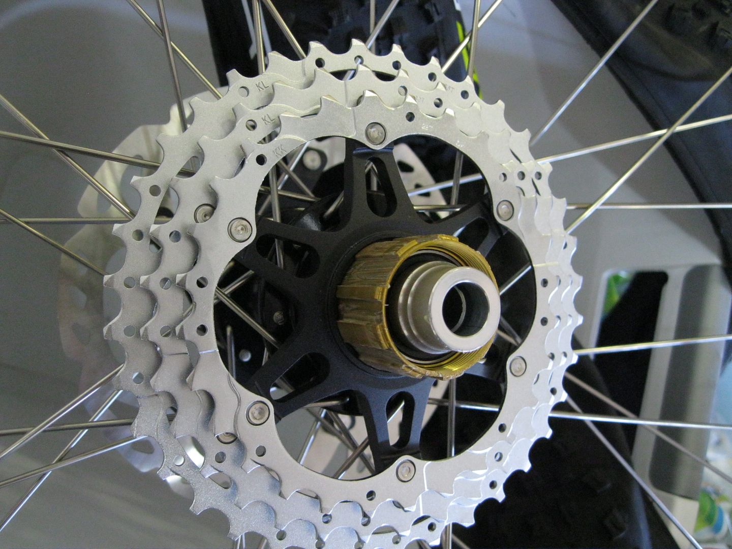

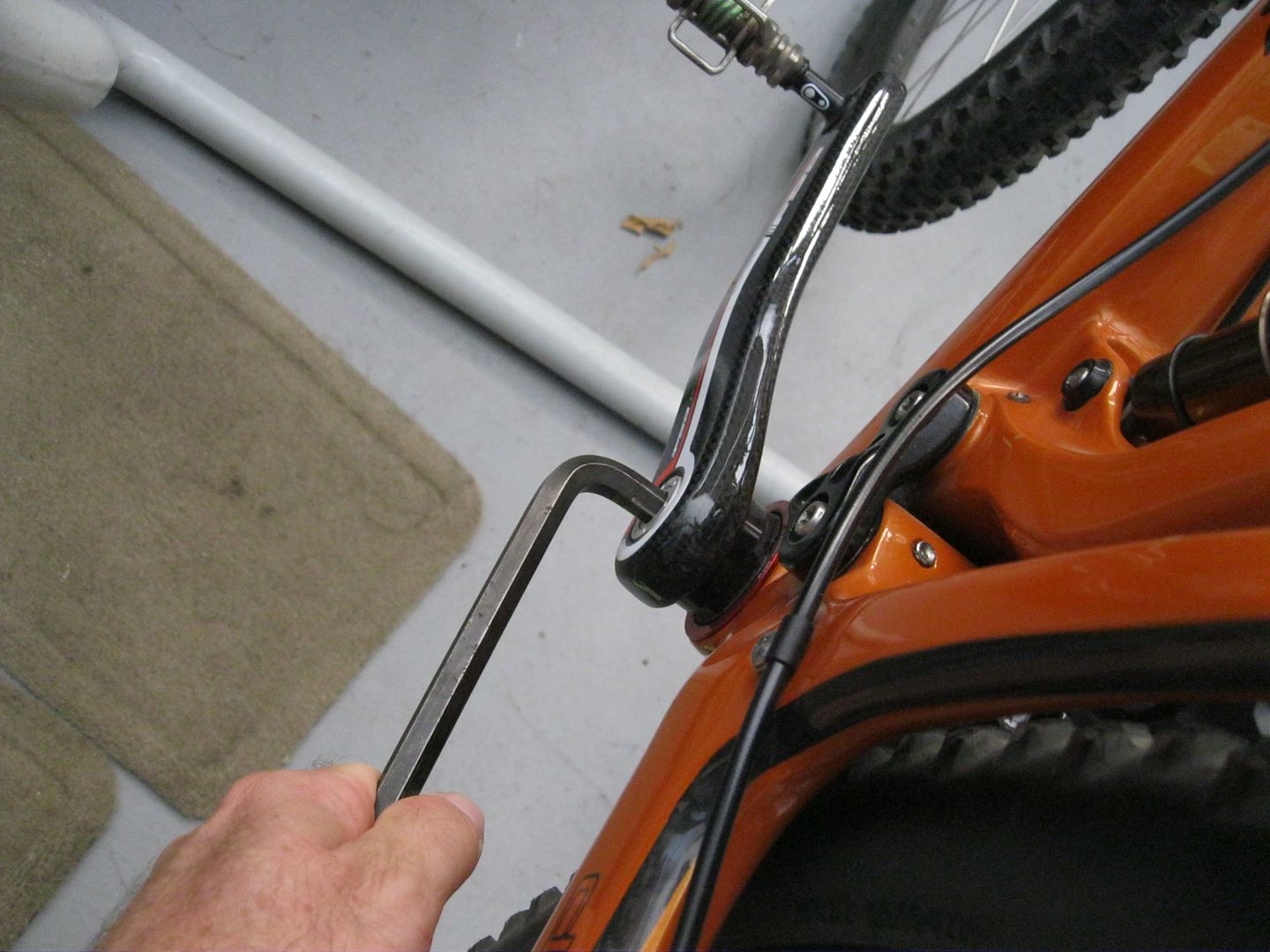

    So I got the cranks in the mail today.. here we go..
    First, if you're putting a BB30 crank on, check to see how it goes in, it will save you some time, you-tube has a ton of videos. The Enduro PF30 has dust seals, if you're using the FSA cranks, these need to come off. The FSA cranks have a step in their version to seat on the bearing race.
    And make sure you put the supplied spacer on..
    Here's what the step looks like..
    That spacer does not go on this set up, just the driveside spacer.
    Lots of grease, slide it through, tighten up the bolt on the non drive side, and tighten the little allen to keep the non drive adjustment tight.
    I was a little shocked at how tight the cranks felt, but, after spinning them a bit, they did loosen up. They have good clearance on both stays and look great!

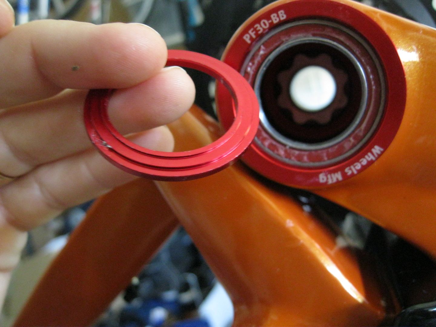

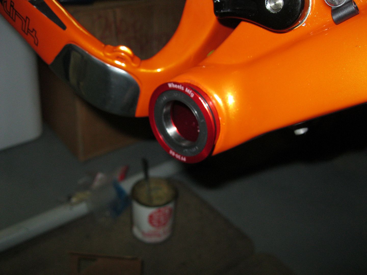

    6,281
    I went with a Shimano double, and it fit perfectly using the Wheels Mfg/Enduro adapter without any spacers.
    I was skeptical of any adapter system, but I've put over 50 hours on it, and not a peep.
    I used the lightest coating of Bel-Ray waterproof grease for assembly, which probably violates all sorts of rules, but it was what I had (and what I've used for decades for everything), and I was itching to get on the trail that same day!

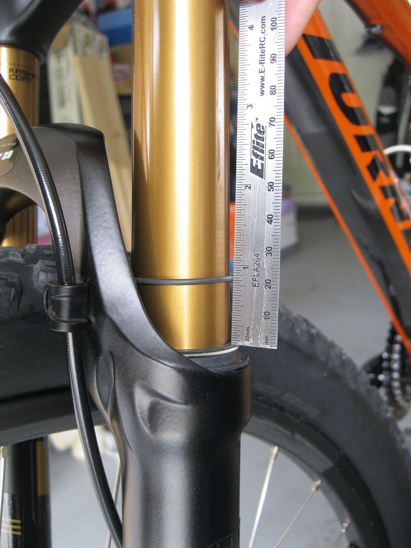

    On your fork, are you using one with a 51mm offset? (The one patented by Trek but is now on the new Ibis Ripley also. It allows for the slacker head angle but keeps the wheelbase shorter and more responsive). I'd read a couple of articles where it was mentioned that the Turner Czar was going to use it too but I didn't see it on their website.

    Nope, Basic Fox CID 120.. The one thing I really liked about this Czar when taking my little test ride is it was nimble and quick with out any aftermarket changes. Soon as my headset arrives, we'll get to the front end!

    120, huh? Please report back on that. I find mine so perfect at 100, that I had kind of decided not to even test at 120. But it's easy to change that!

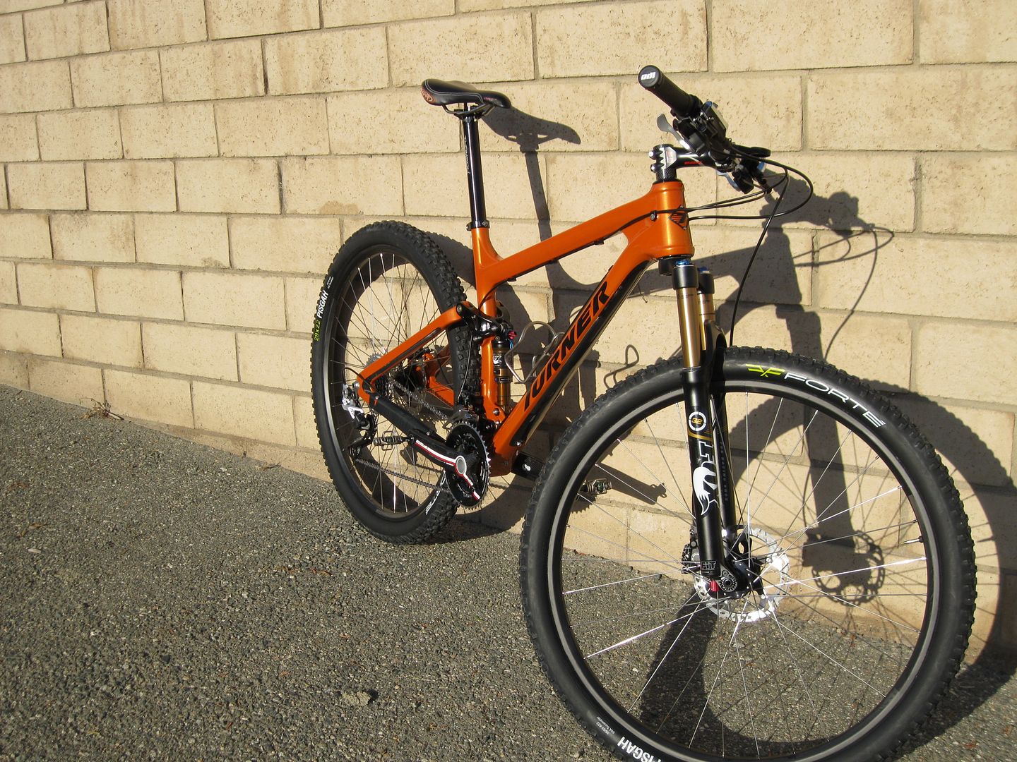

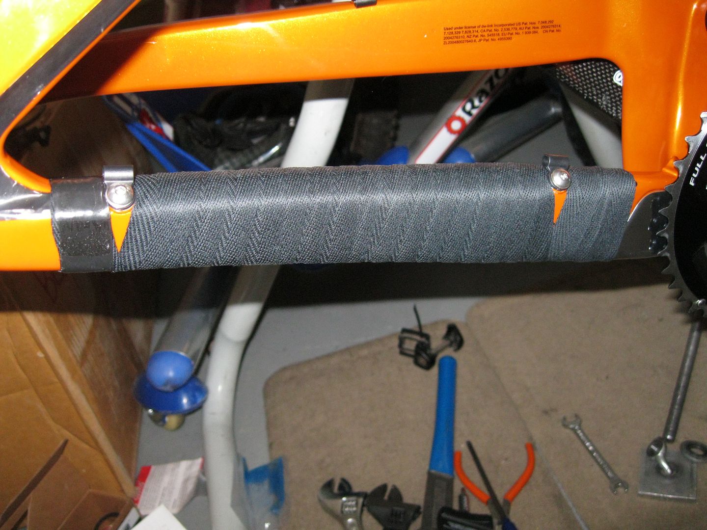

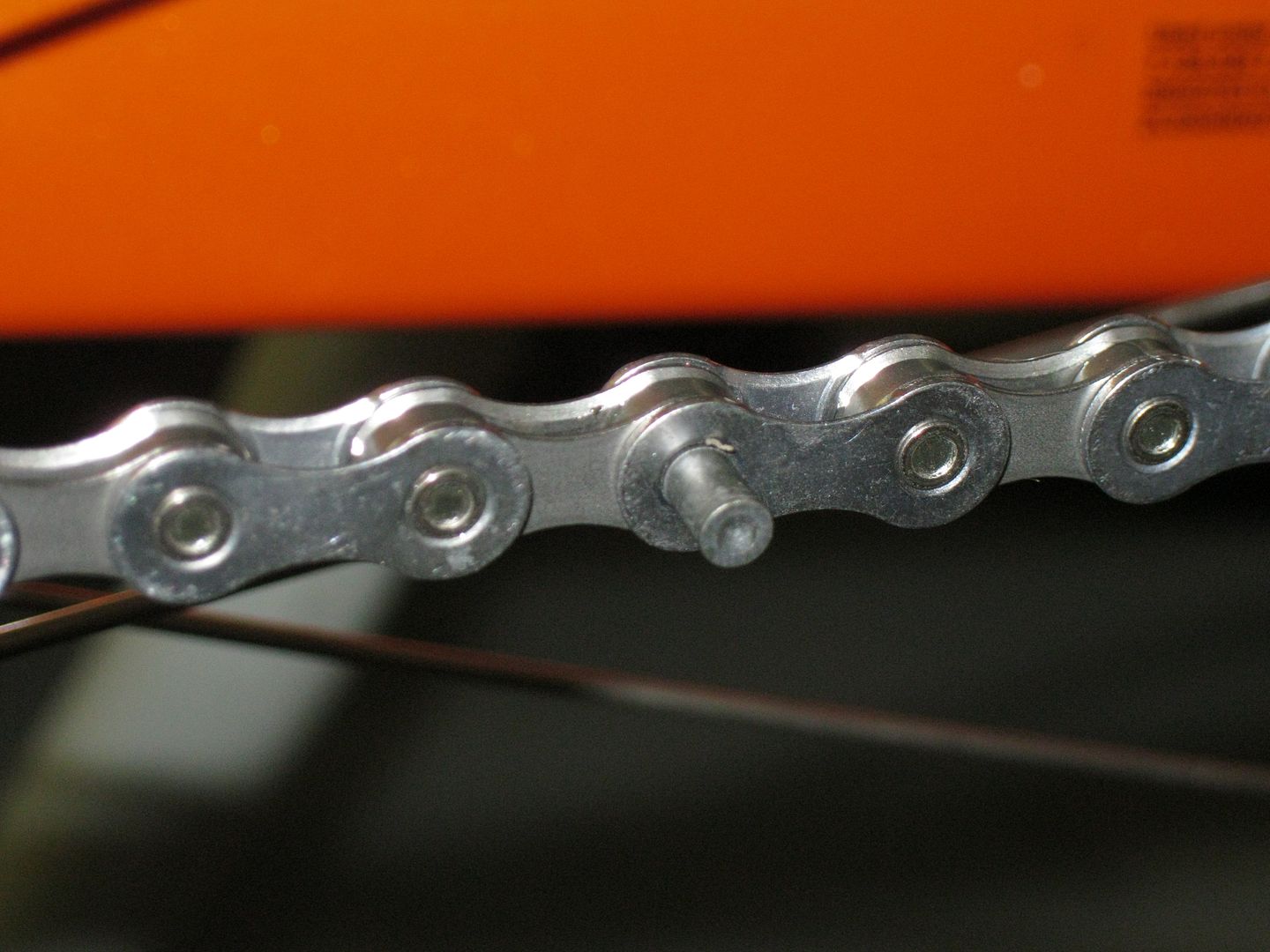

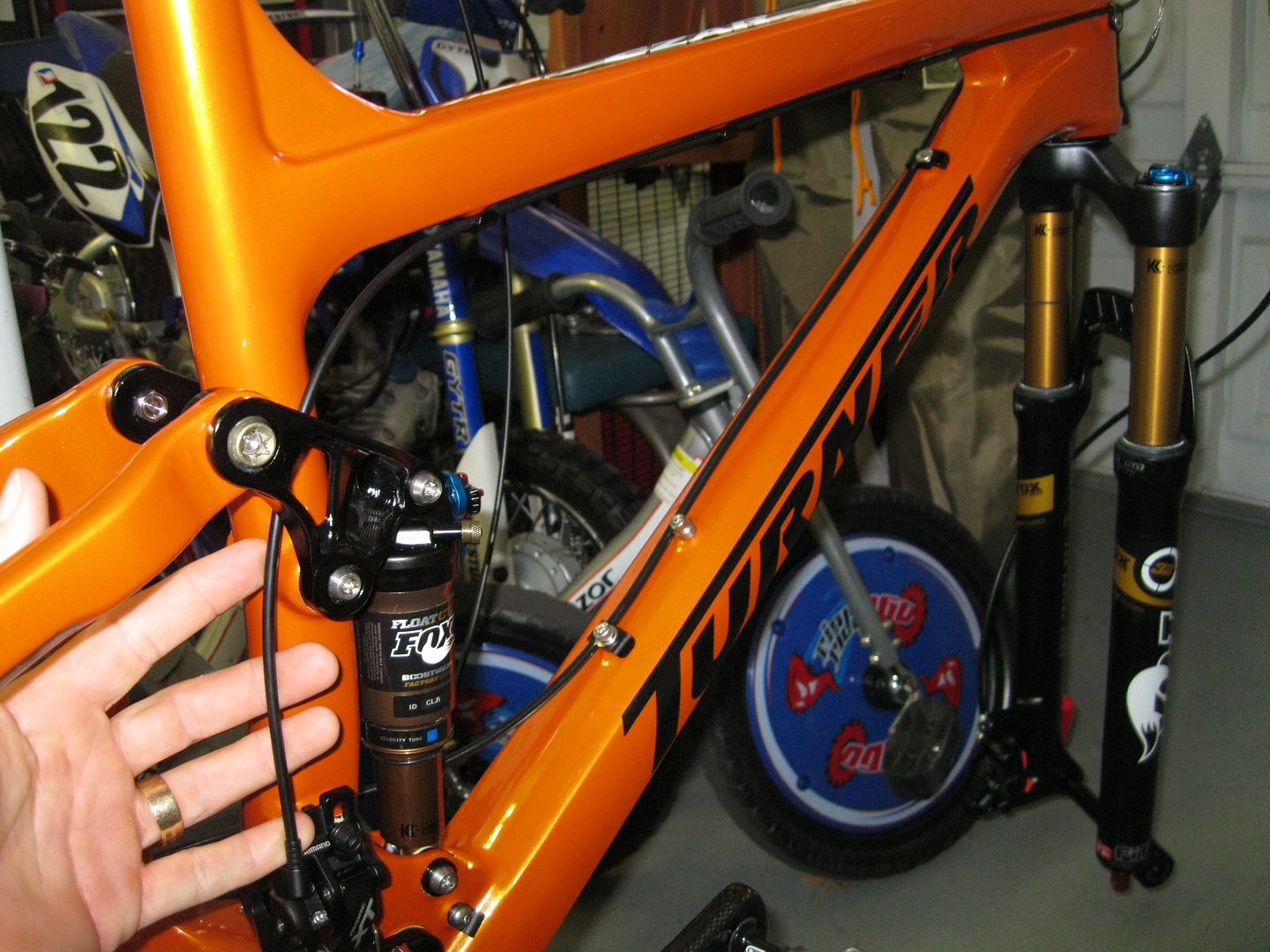

    Been a whole lotta waiting for parts.. so, I did do one small buildy thing.. So, until the Headset arrives...
    I like a quiet bike. I don't like chain slap, don't like the damage it can do. I know a lot of guys will wrap the chain stay with all kinds of things, there clear tape, Carbon fiber stick on stuff, tubes! I personally like Cotton handlebar tape.
    This stuff...
    Here's the trick though... Soak it in warm water before you wrap the chain stay. It'll give you a nice clean look. Start up by the crank, loop over the tape once, and wrap towards the rear axle. When you get to the back, tie off the tape with a couple wraps of electrical tape. Take your time, and it can look like this..
    That will protect the chain stay, keep the bike quiet, and lasts for many many miles!

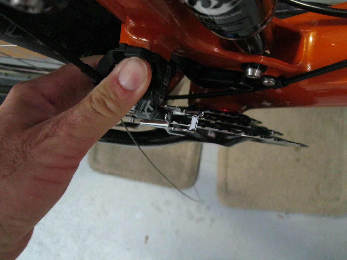

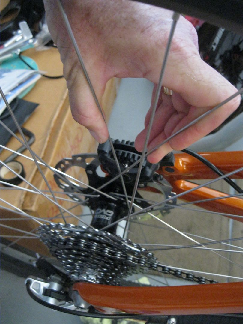

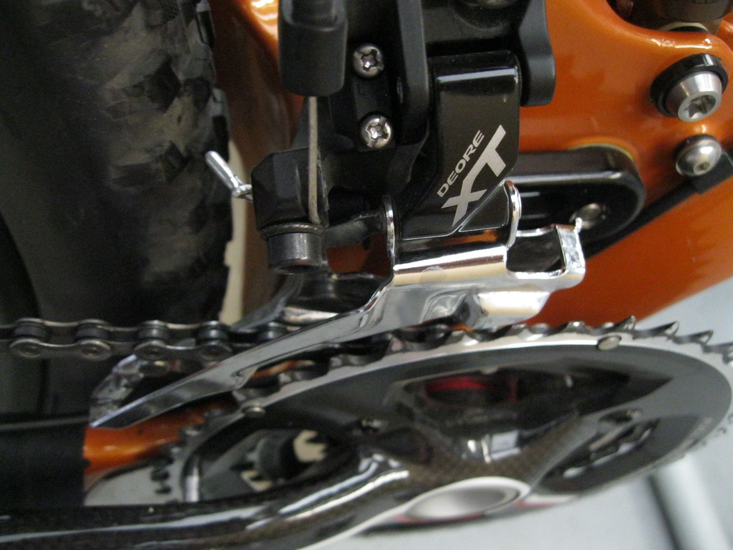

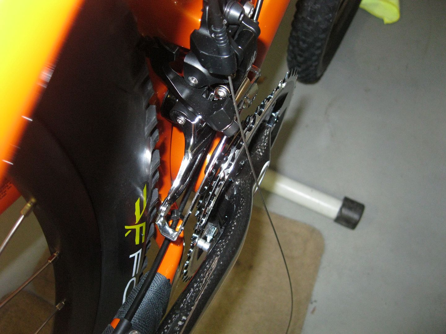

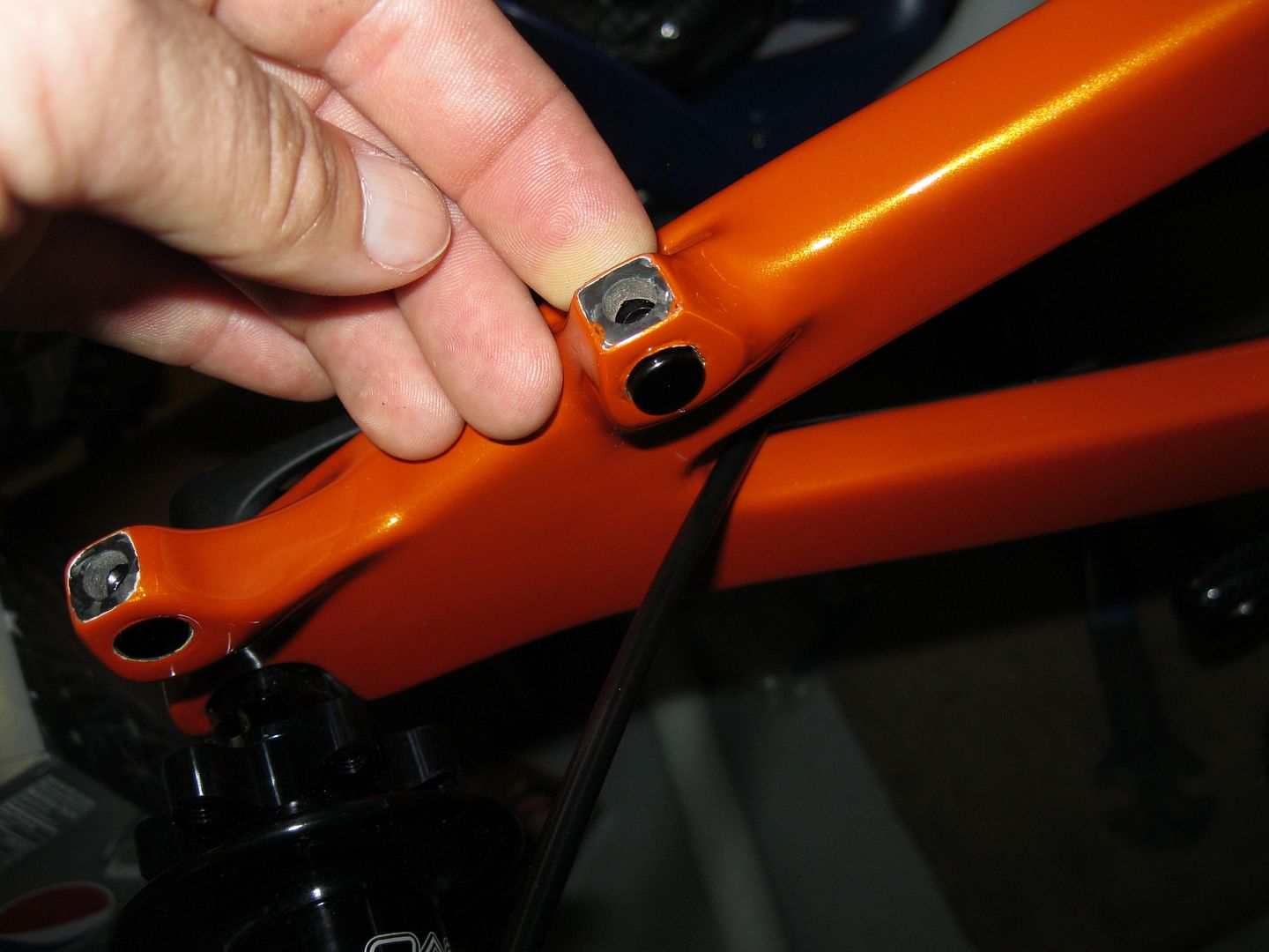

    Derailleurs.. pretty simple to mount really.
    Front is direct mount, throw some grease on the threads and mount. the height should be about a MM from the high tooth on the outer ring when the derailleur is in that position..leave the green barrel in for now, and follow the sticker for reference..
    The Rear, throw on some grease, and mount... only caution is make sure the little tab on the back is where the recess should go, it should rest flush on it, too high and the derailleur won't shift right, too low and you'll cross thread the little bugger..
    Too high...
    Just right!!
    Ta dah!!

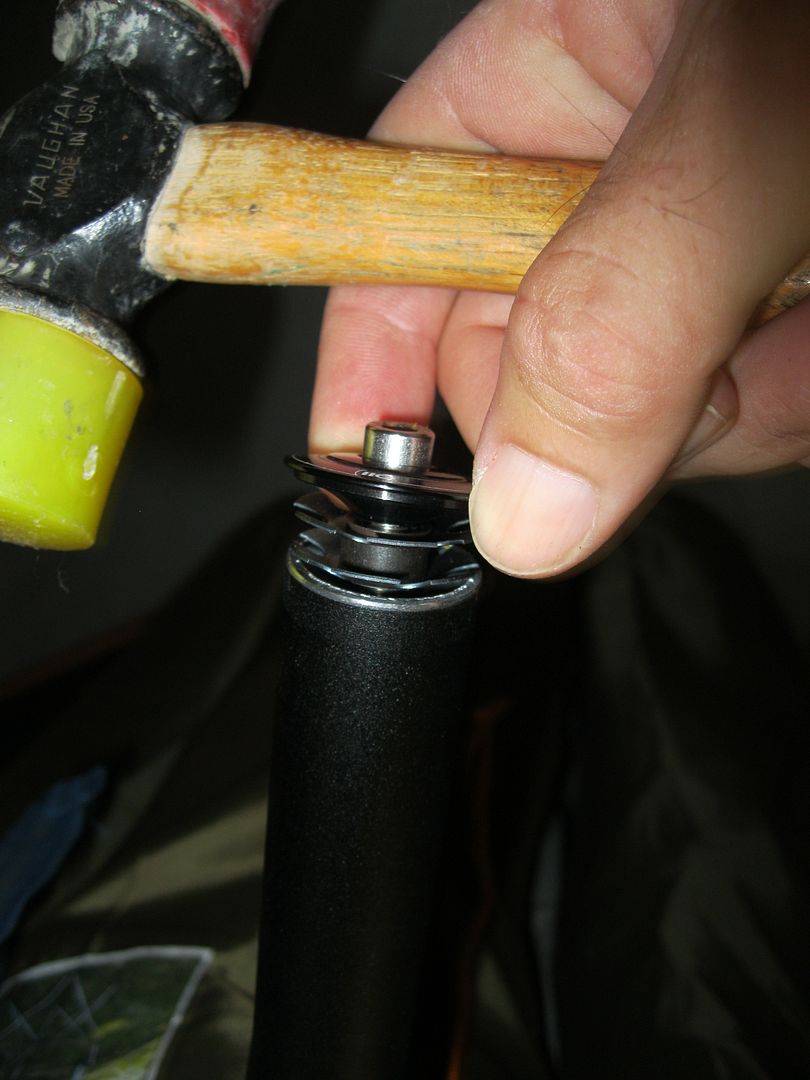

    Mar 2011
    194
    Guess what I got in the mail today!!

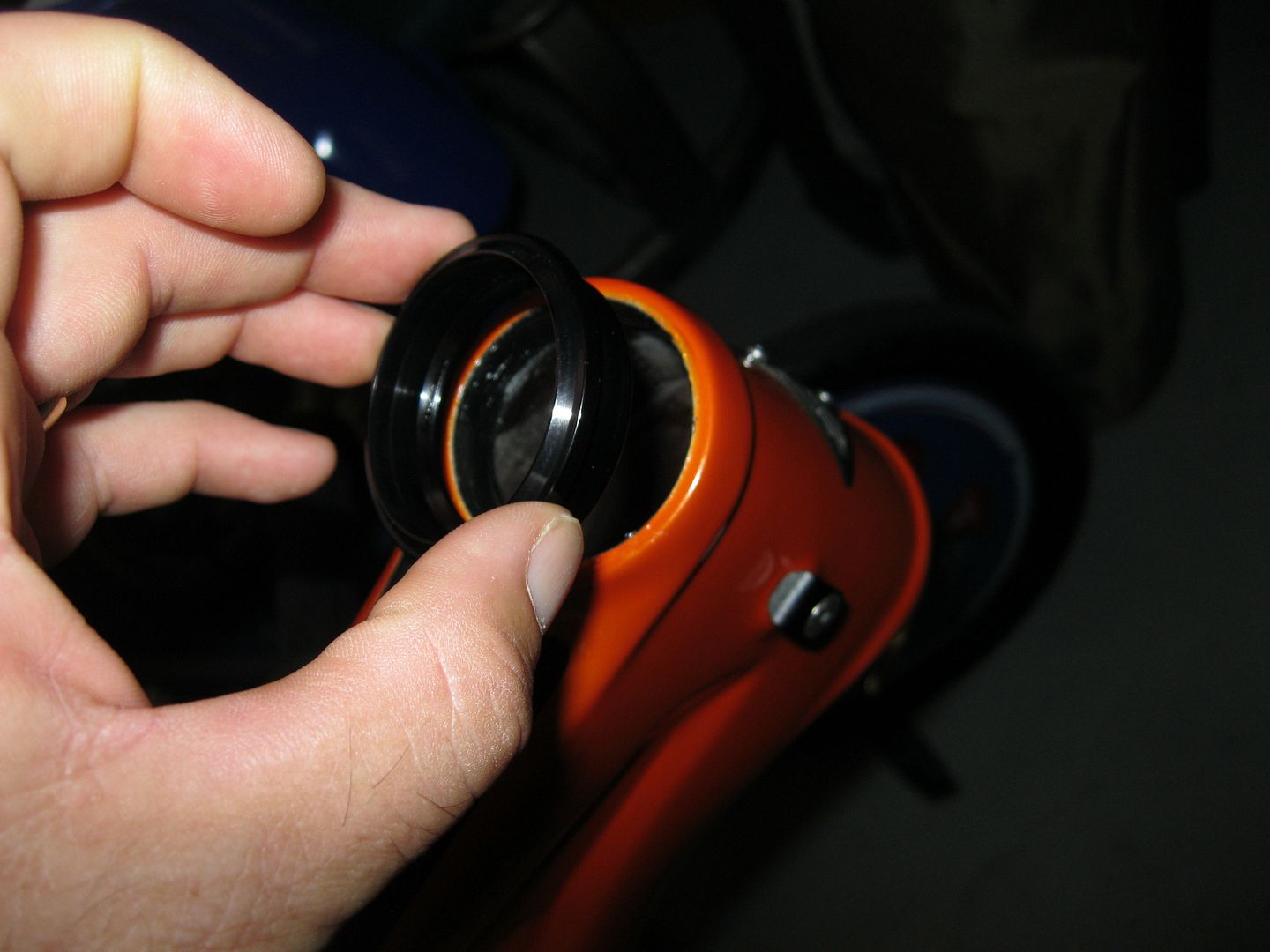

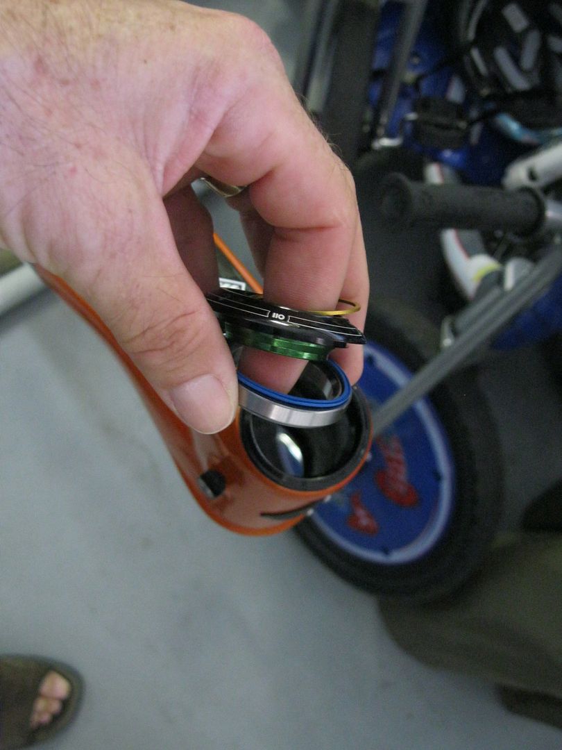

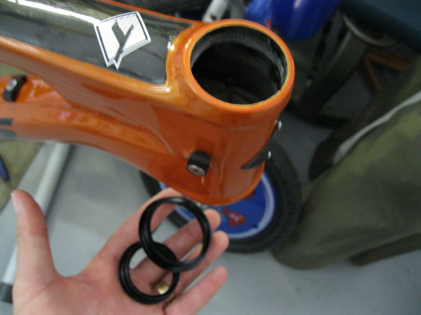

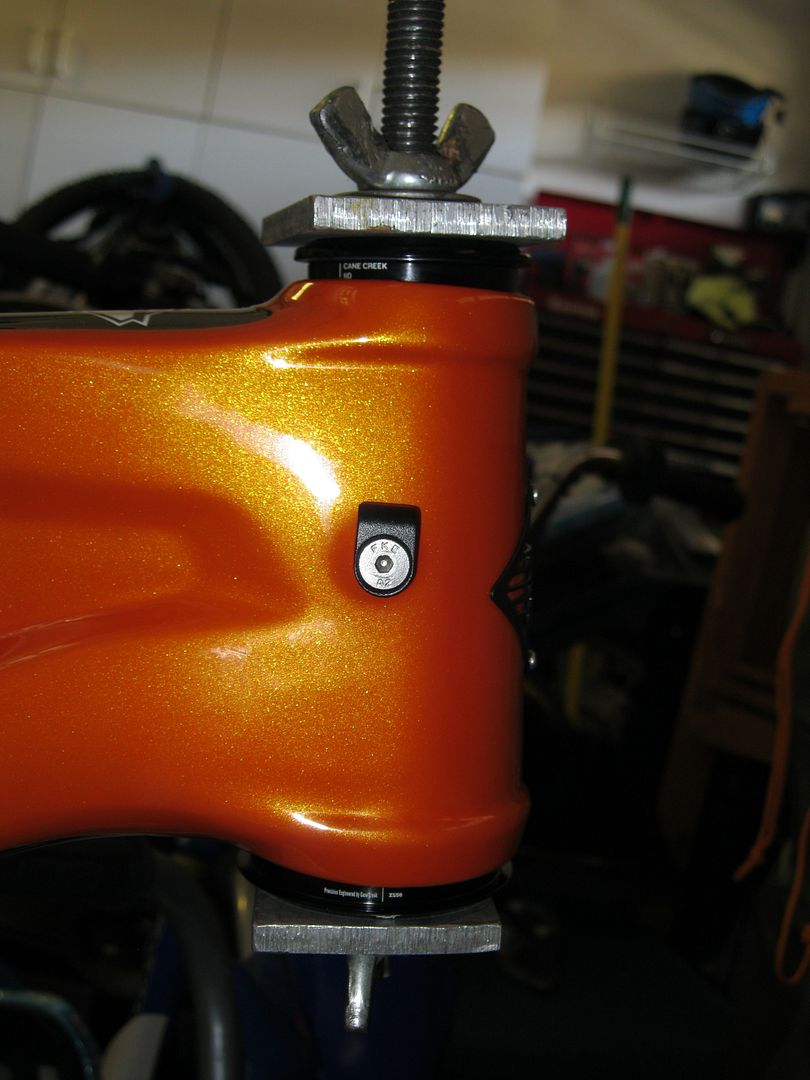

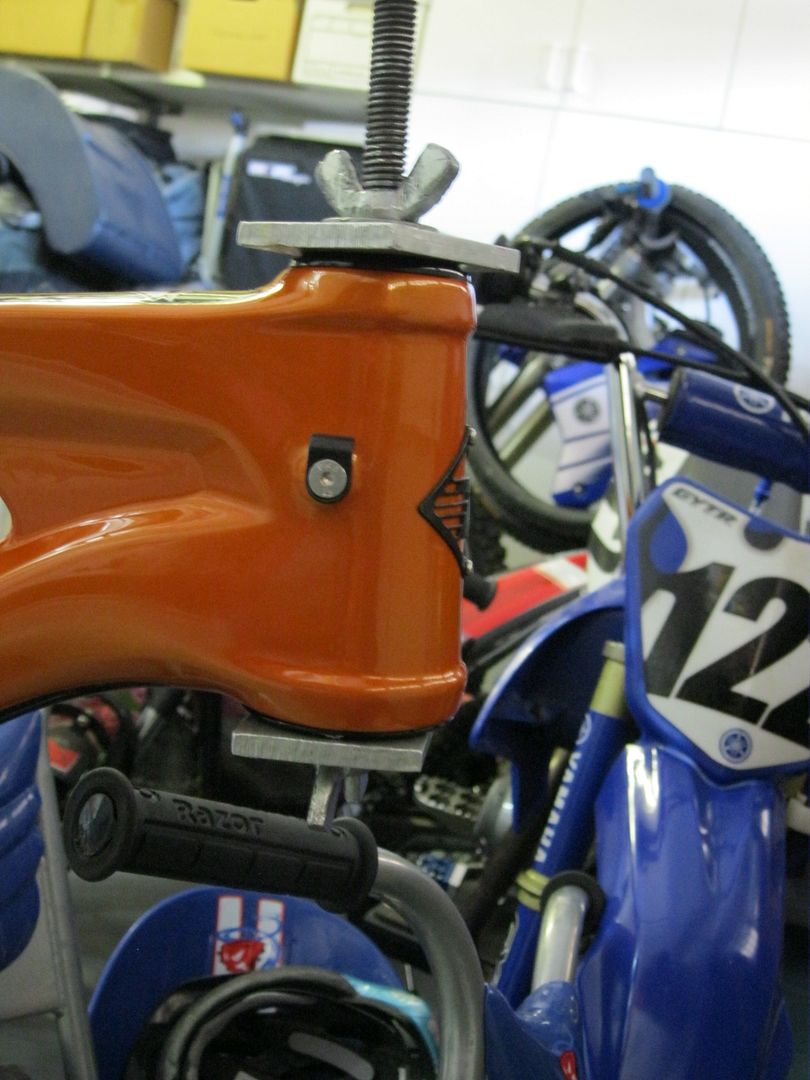

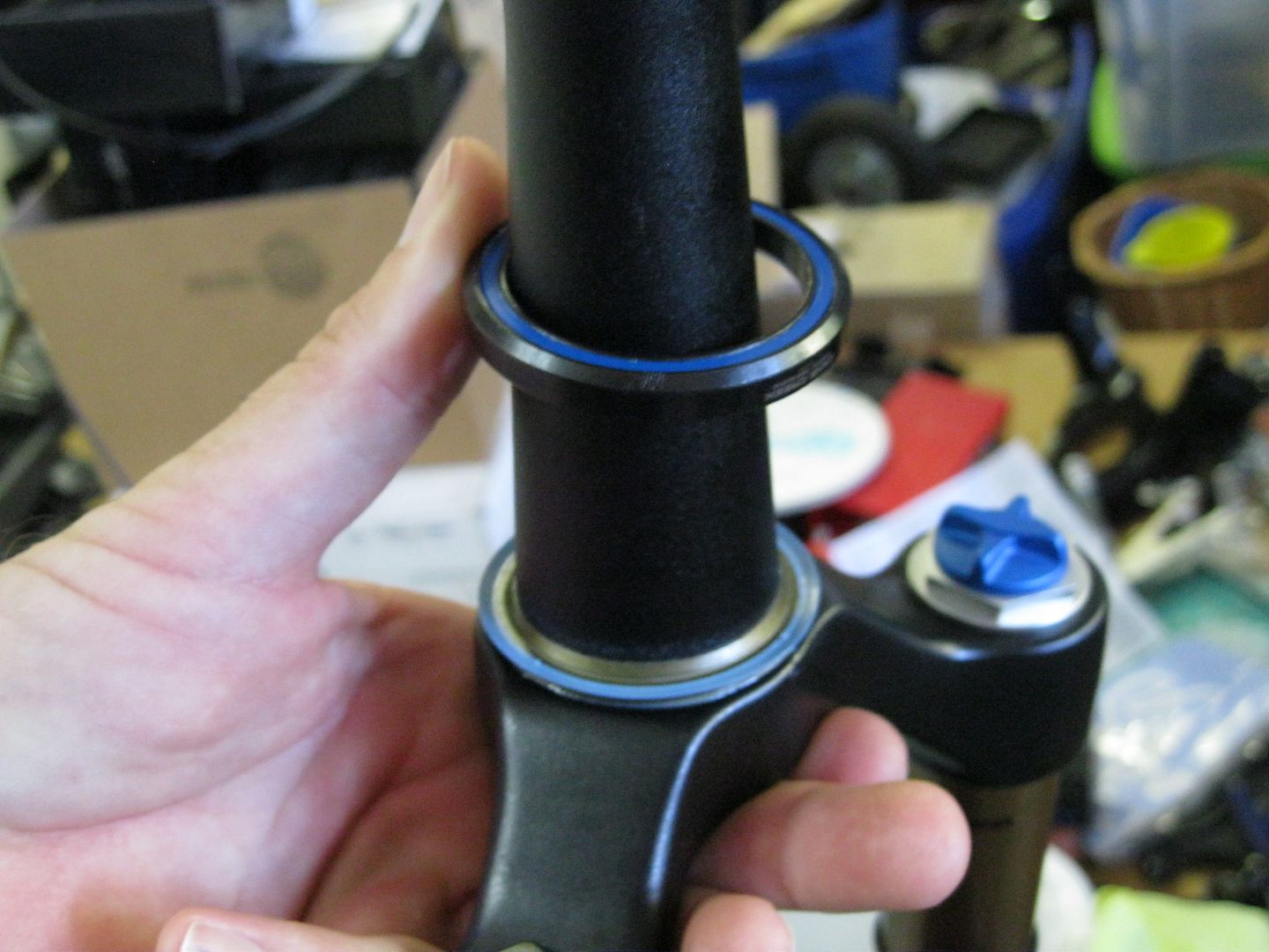

    These are the two headset cups.. so, there has been a lot of debate, and I'll give you the choice.. the basic consensus is grease for the PF bottom bracket and the headset. Now, I do know a couple bike techs that prefer the sandy grease for these two areas, which is why I went that way, but there's also a large group that say no. So, grease how you'd prefer, but grease the cups, and set them up in the frame. line them up the way you want them, they aren't moving.
    Get out your headset press...
    Make sure you press it all the way in. It should be flush around the edges.

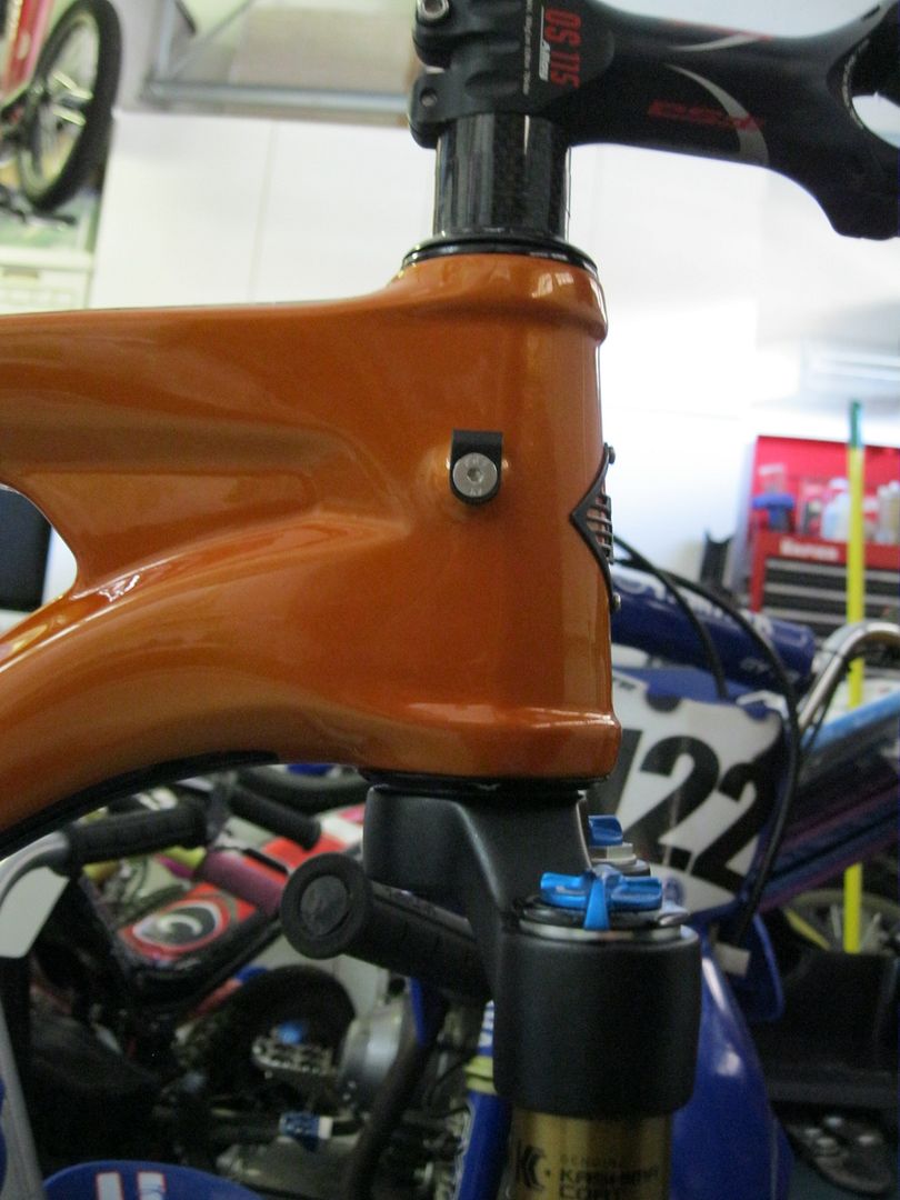

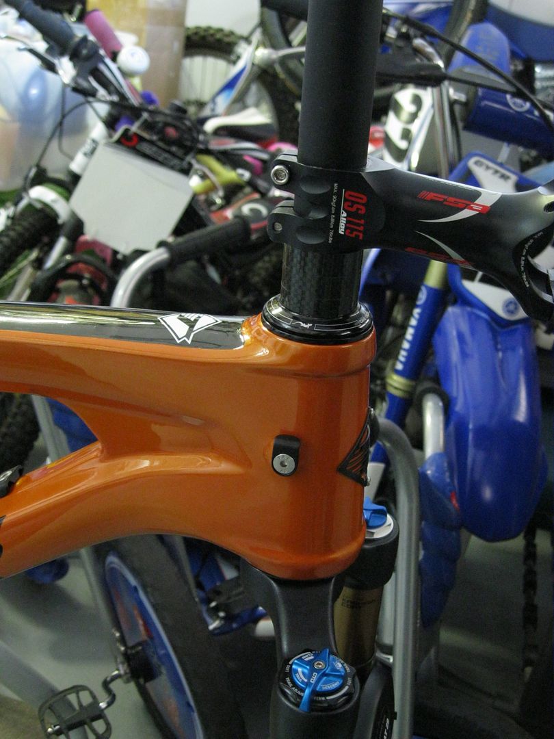

    Here is the top stack sequence....

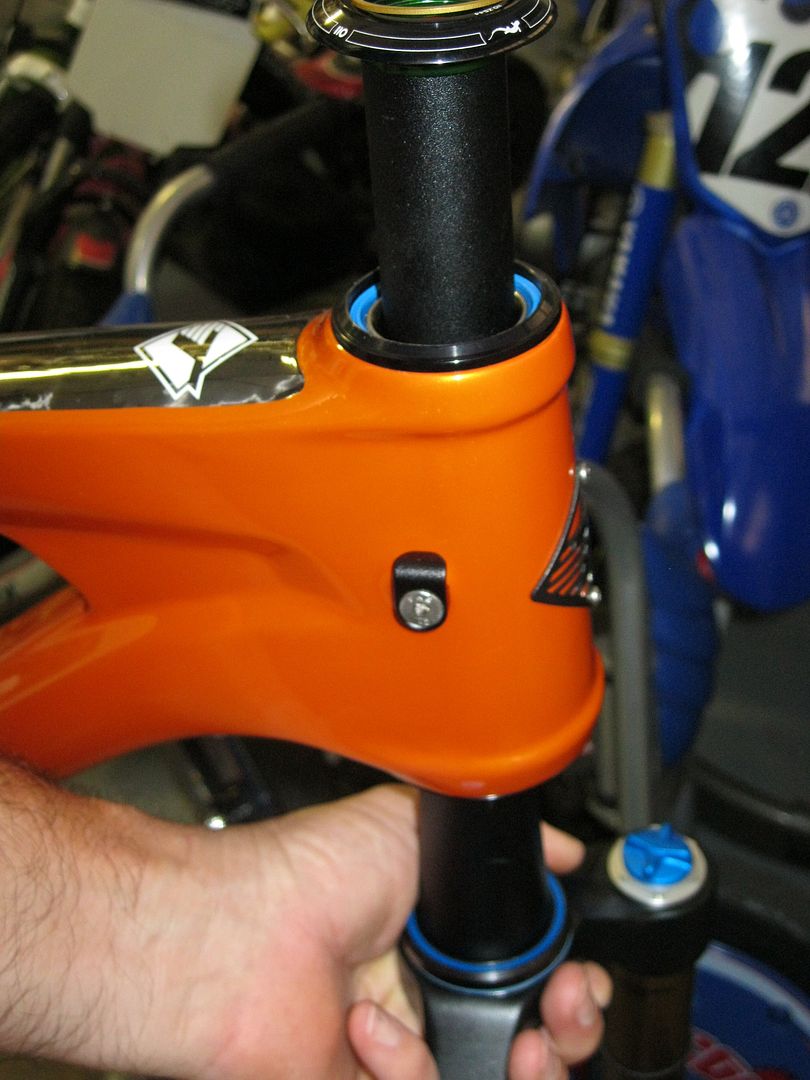

    Don't worry about grease just yet, we need to measure the steerer tube first.
    Take your fork, put a layer of grease around the bottom, and slide the race in place. make sure the correct side is up.. it's the side that fits smoothly in the bearing..
    Use a slide to seat it on your fork. the grease should ooze out the sides..you should hear a sound change when the race seats.
    DO NOT BANG THE FORK ON THE GROUND TO SEAT THE RACE!!!!! You'd be surprised what I've seen.
    Put the fork on...

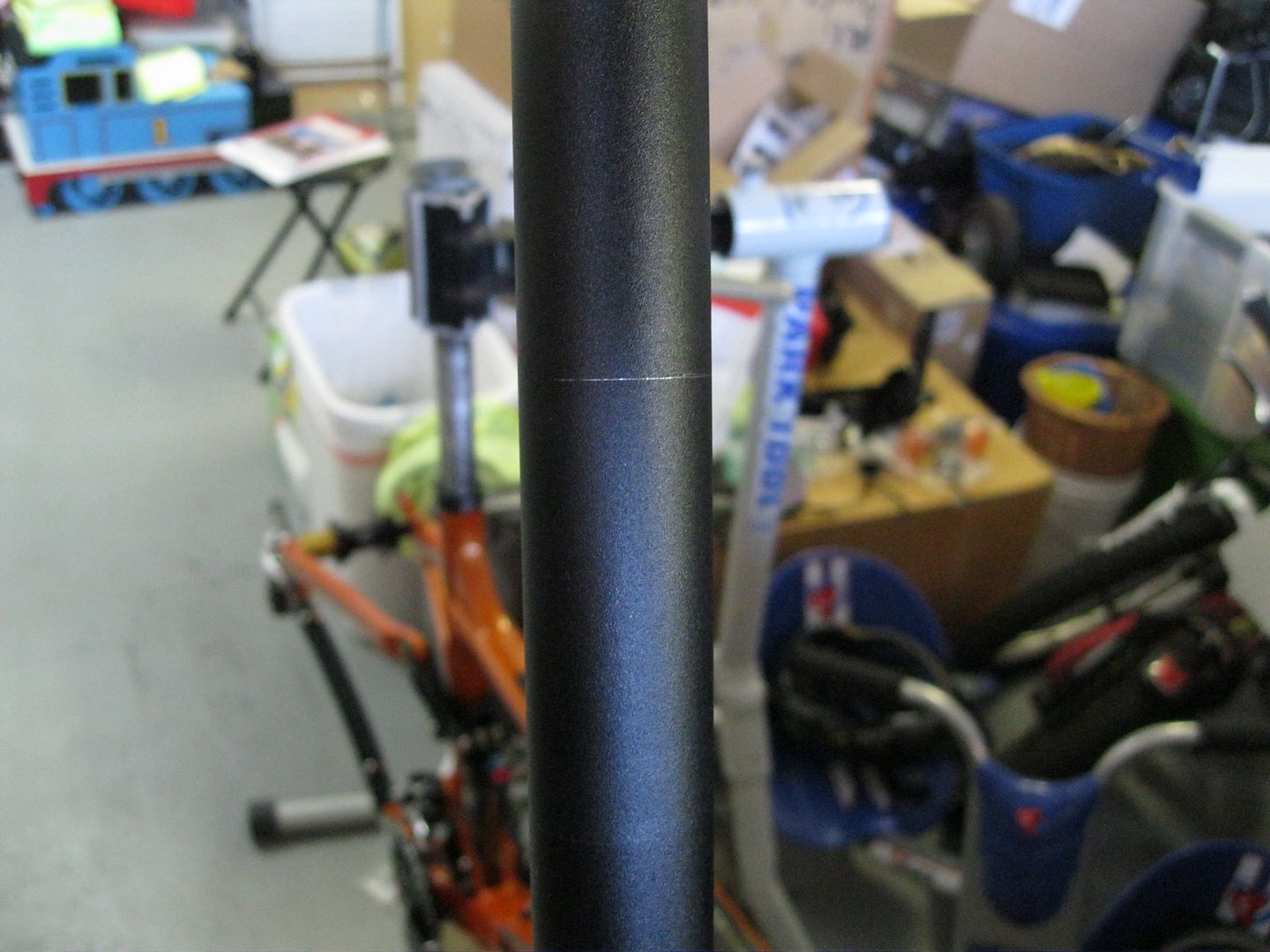

    Put the stem and extra spacers on.. give yourself some room...you can always cut more..
    Make sure the fork is snug.. the bottom should be in there as well..

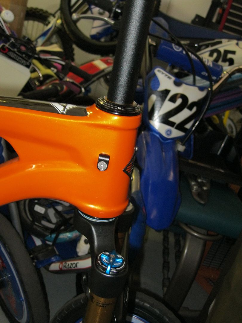

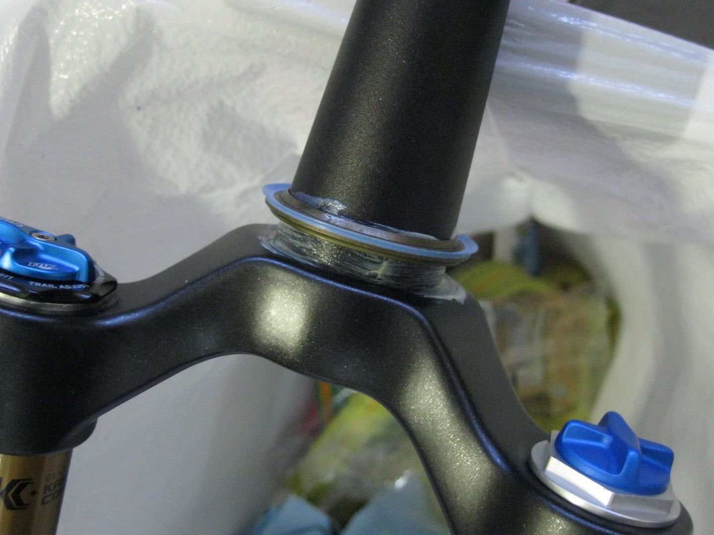

    I then mark the top with a razor..
    Pull out the fork, and here you go..

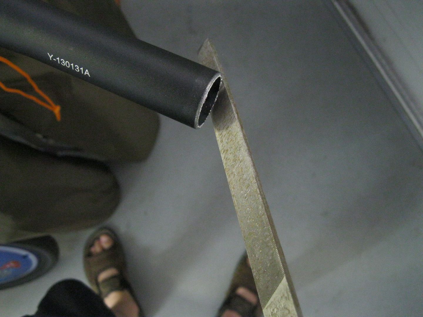

    I like to use a pipe cutter... It's simple and effective.
    I cut about a 1/8 below the top line.
    File to clean up the edge..
    Debur..
    Next is the Star nut..
    Bang!!!
    Now grease up the cups and the bearings and reassemble!!

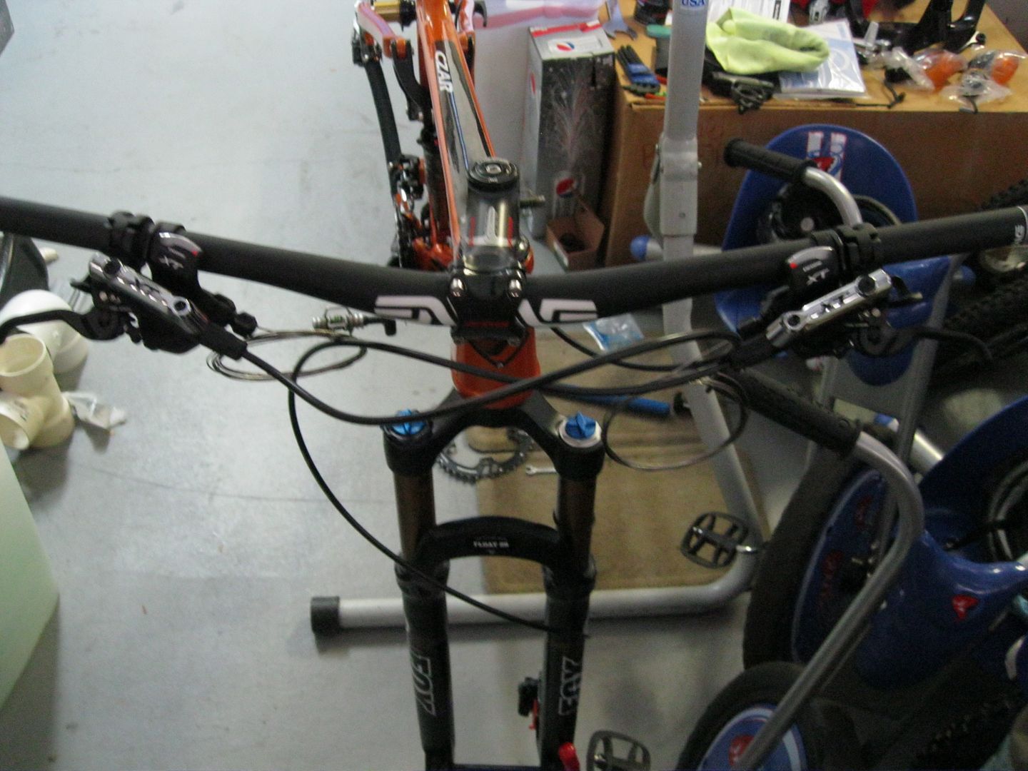

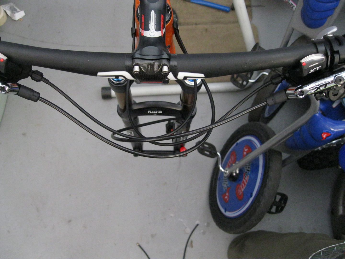

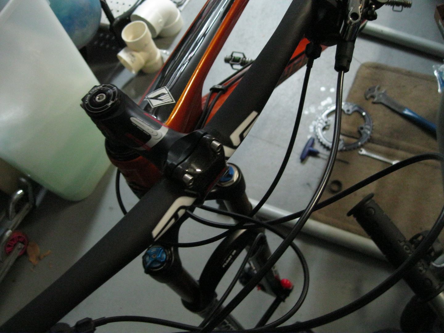

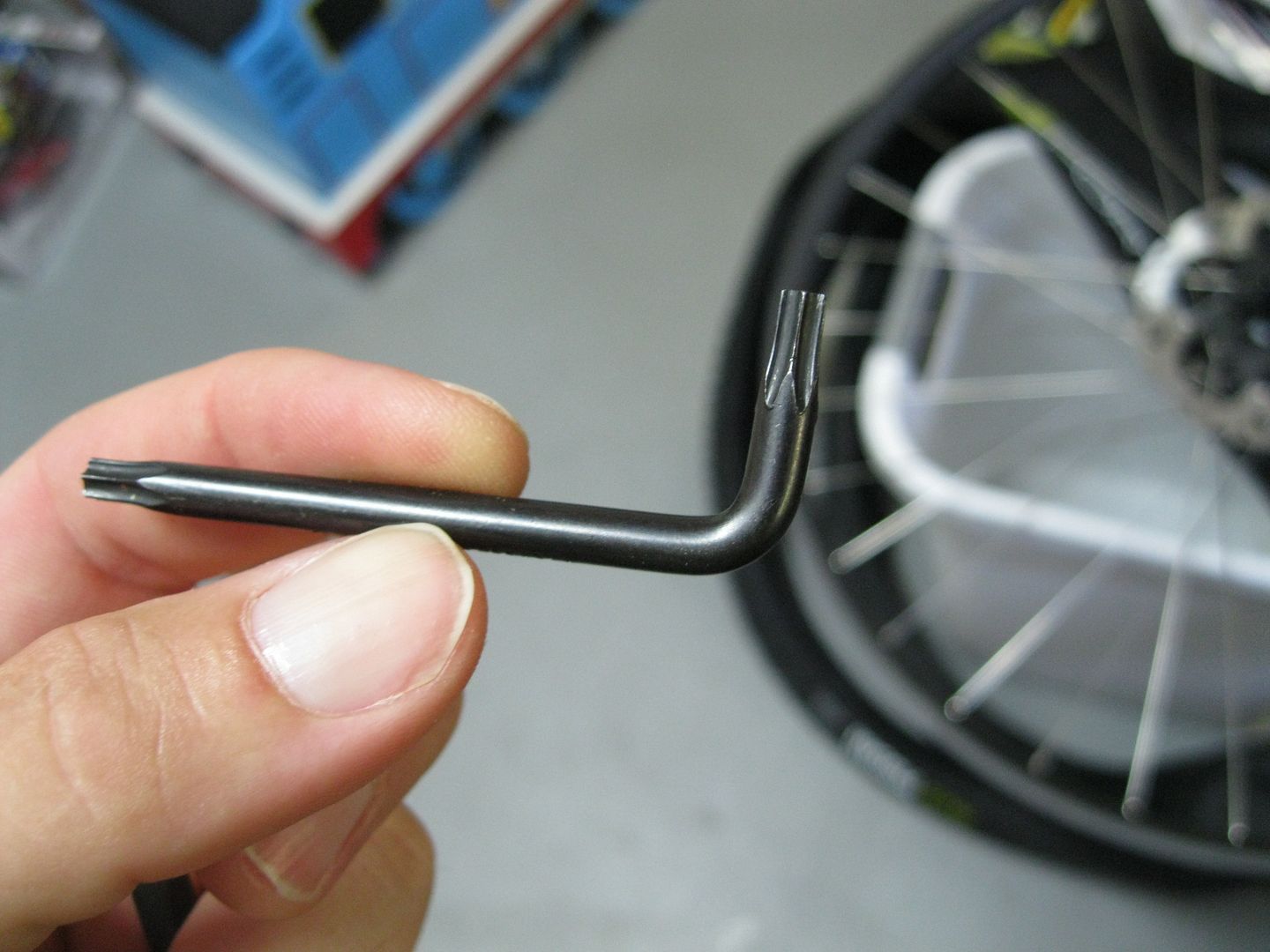

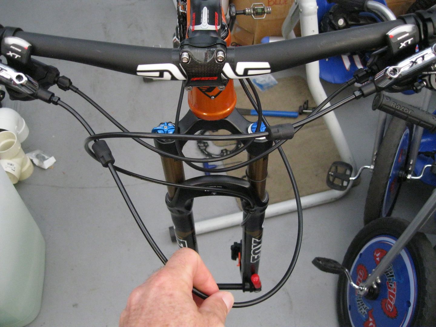

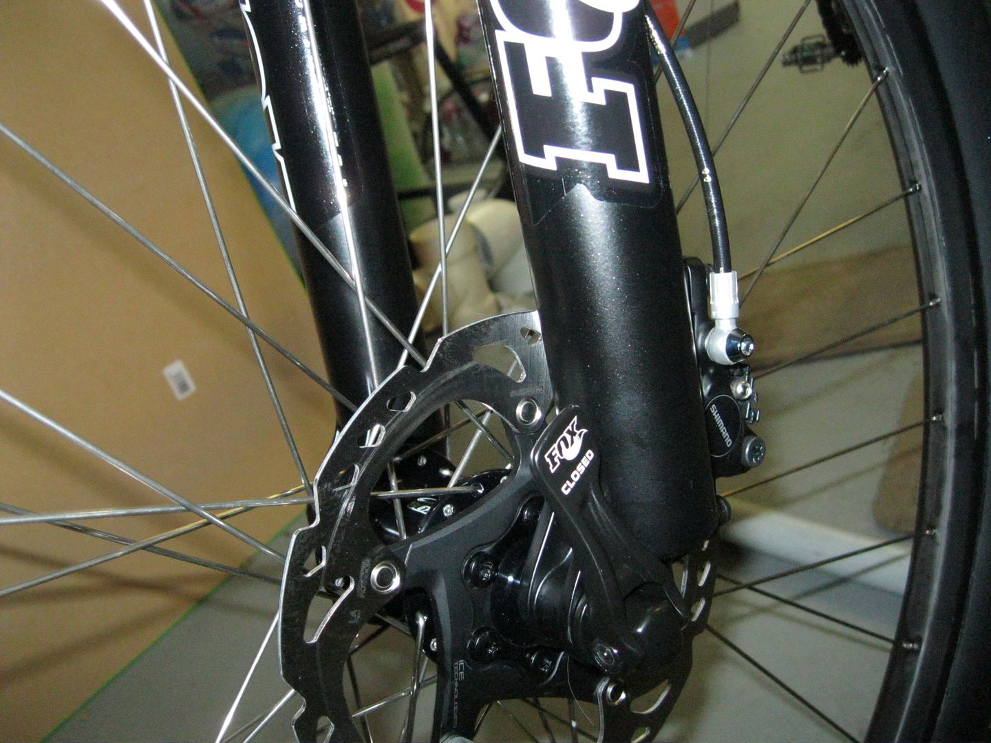

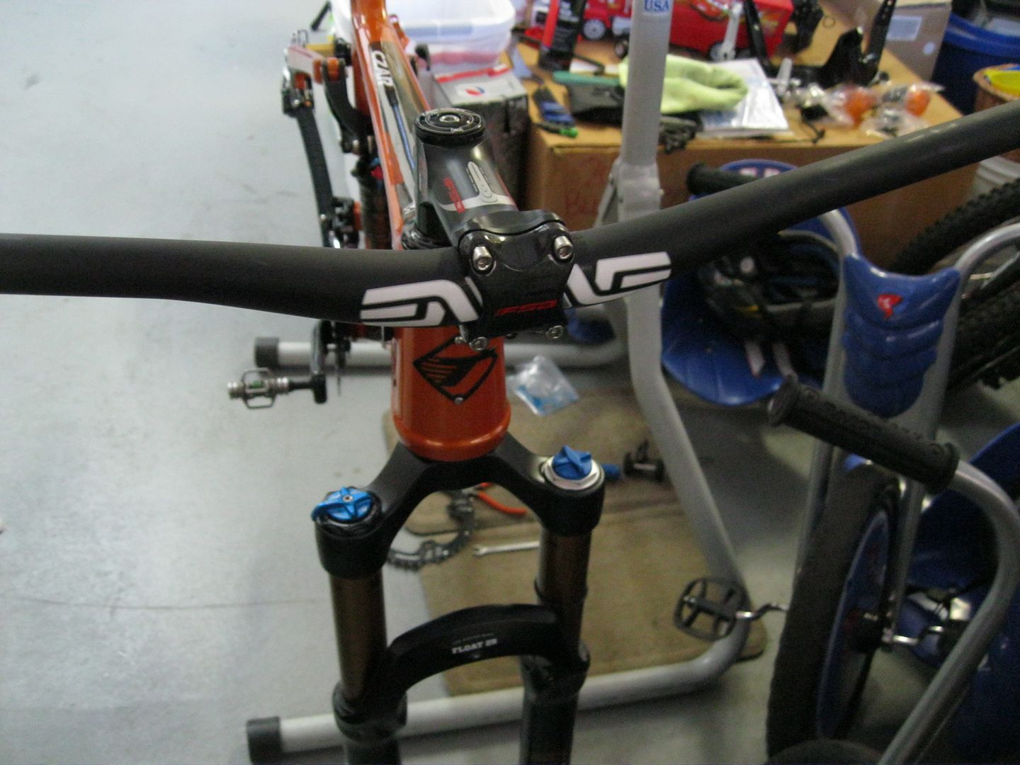

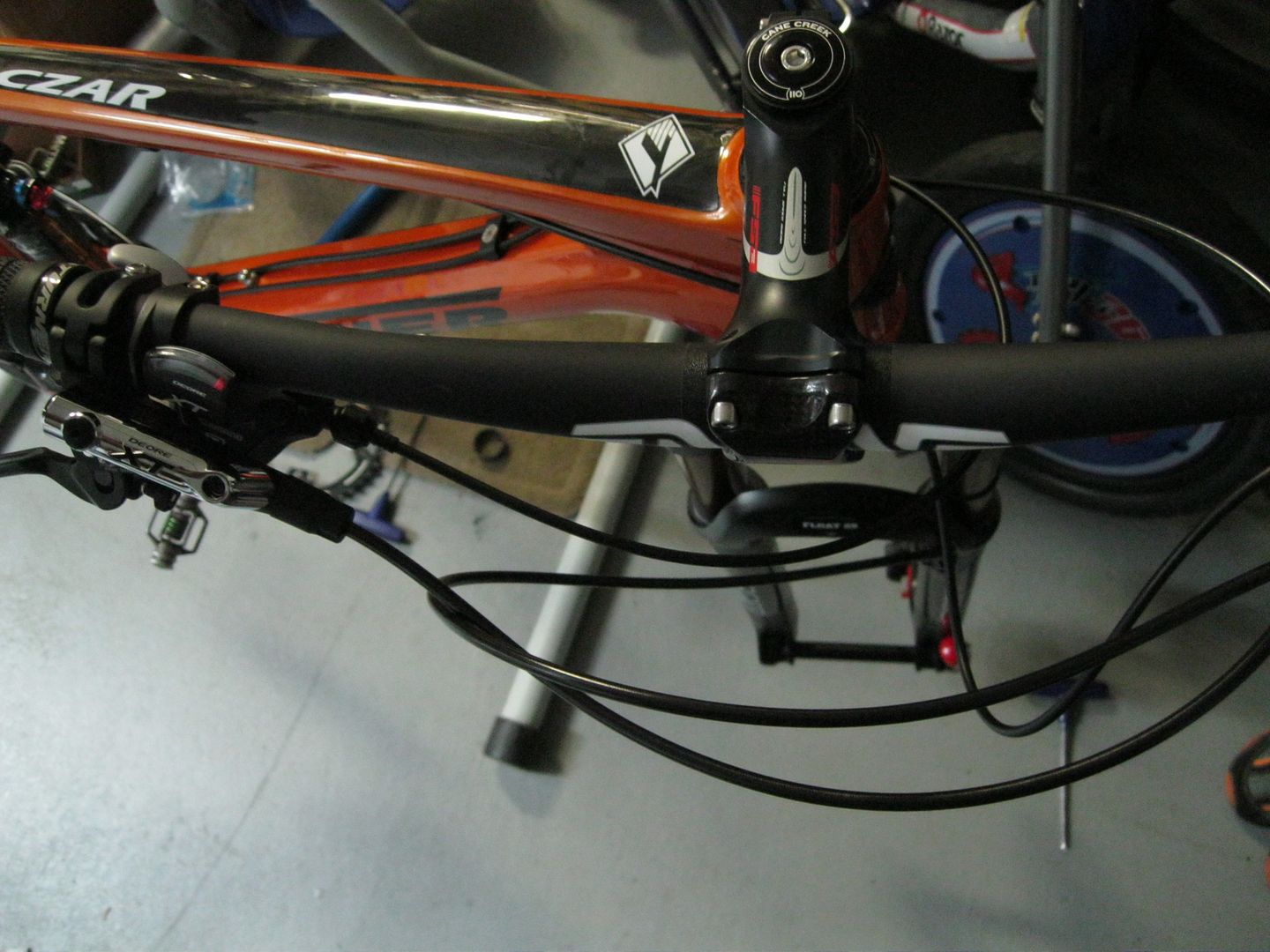

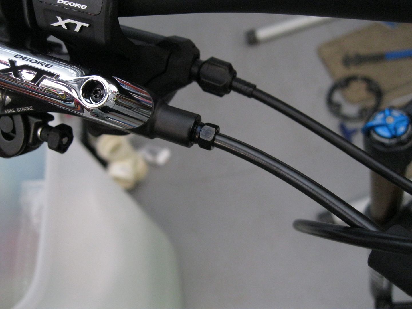

    So next is the bars. Pretty simple here, remove the faceplate, put on the bars, replace the faceplate. No need to crank down the bolts just yet, they just need to be firm. Chances are, when you have the bike all together, when we set up fit, the bars will get moved, once in a good spot, then you'll tighten then to 5nm.
    With the turner you get these black barrel nuts. They look like the ones you get for IKEA furniture, but way nicer. They go in the rear disc break mount...

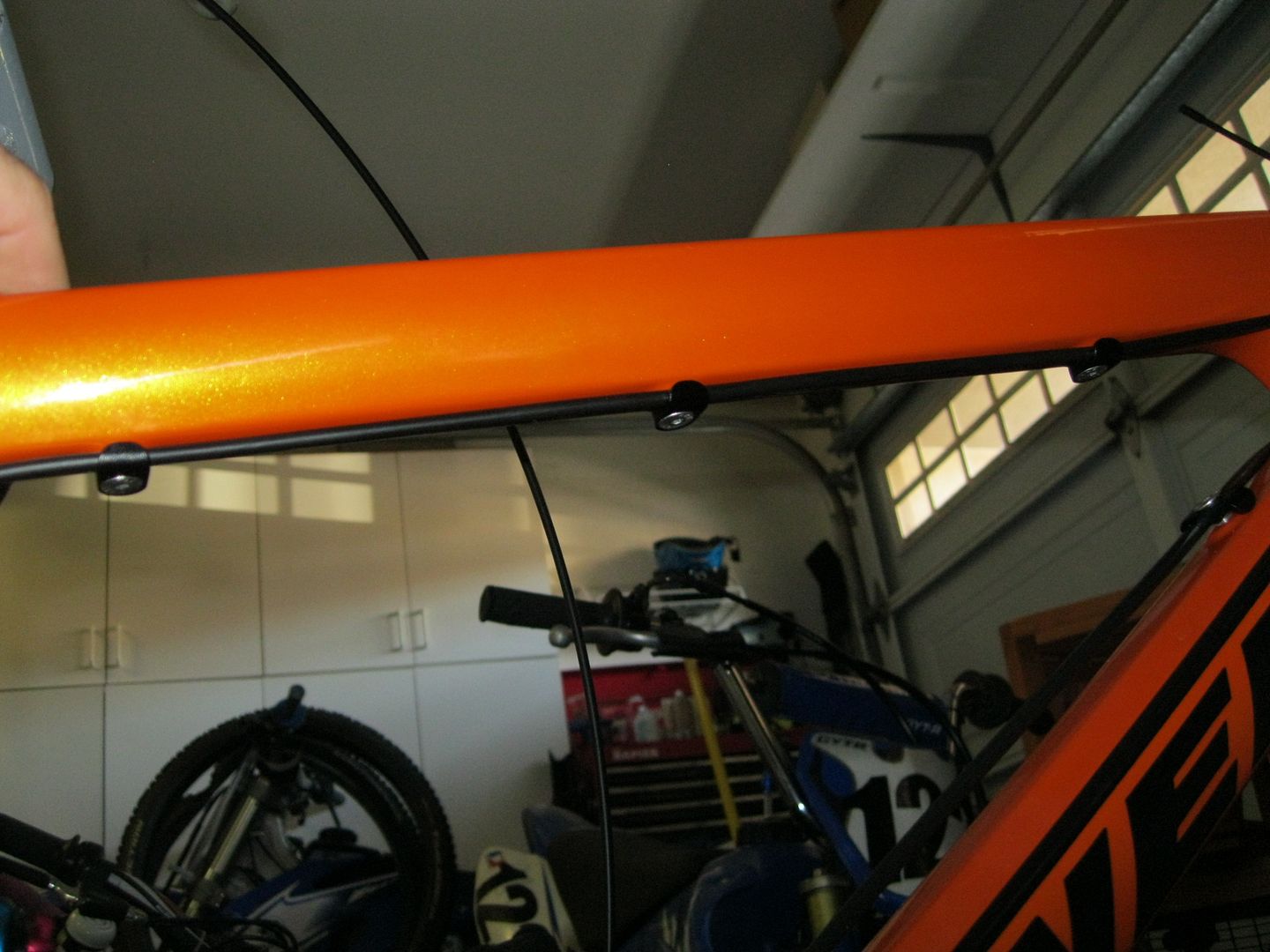

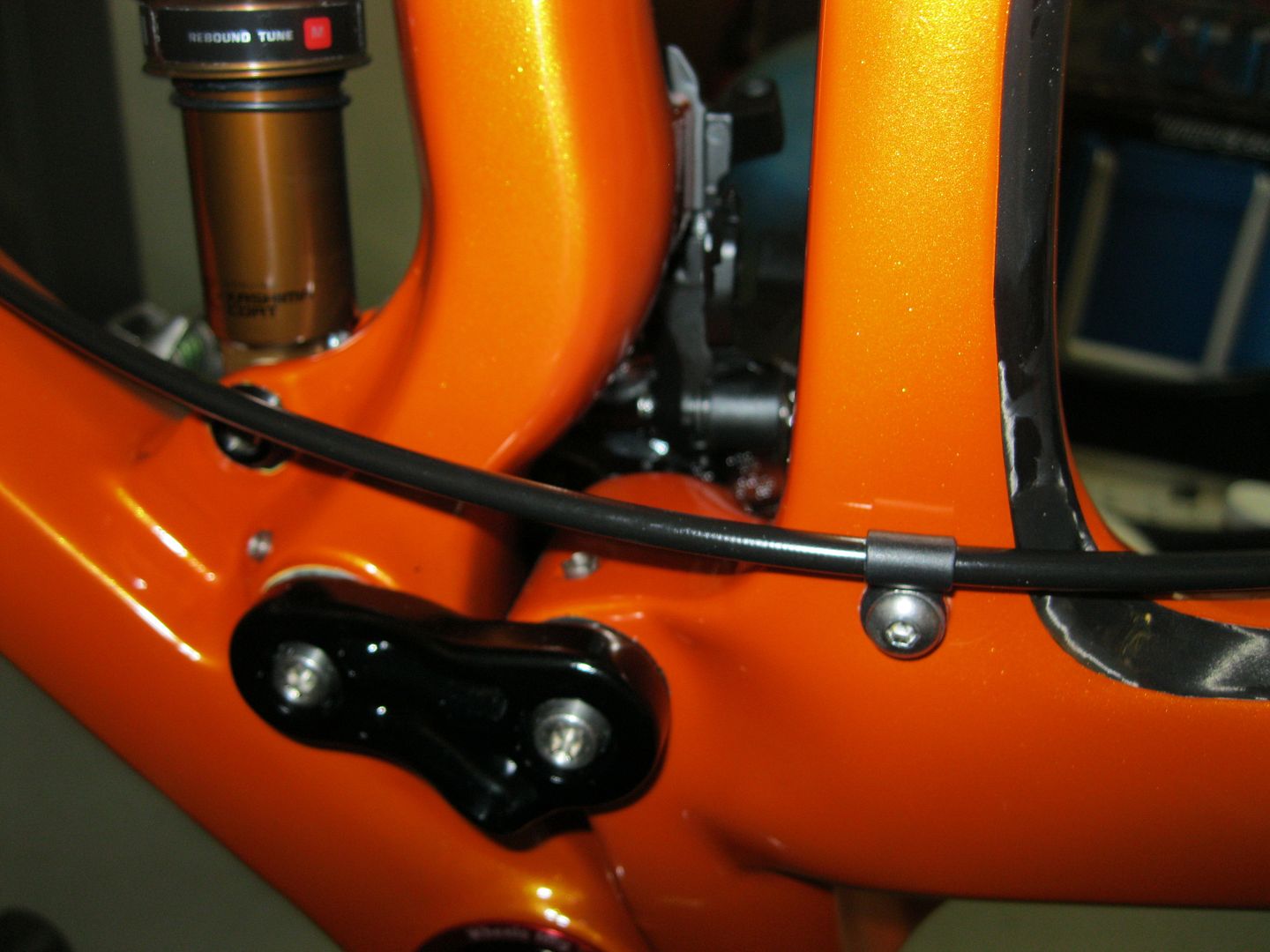

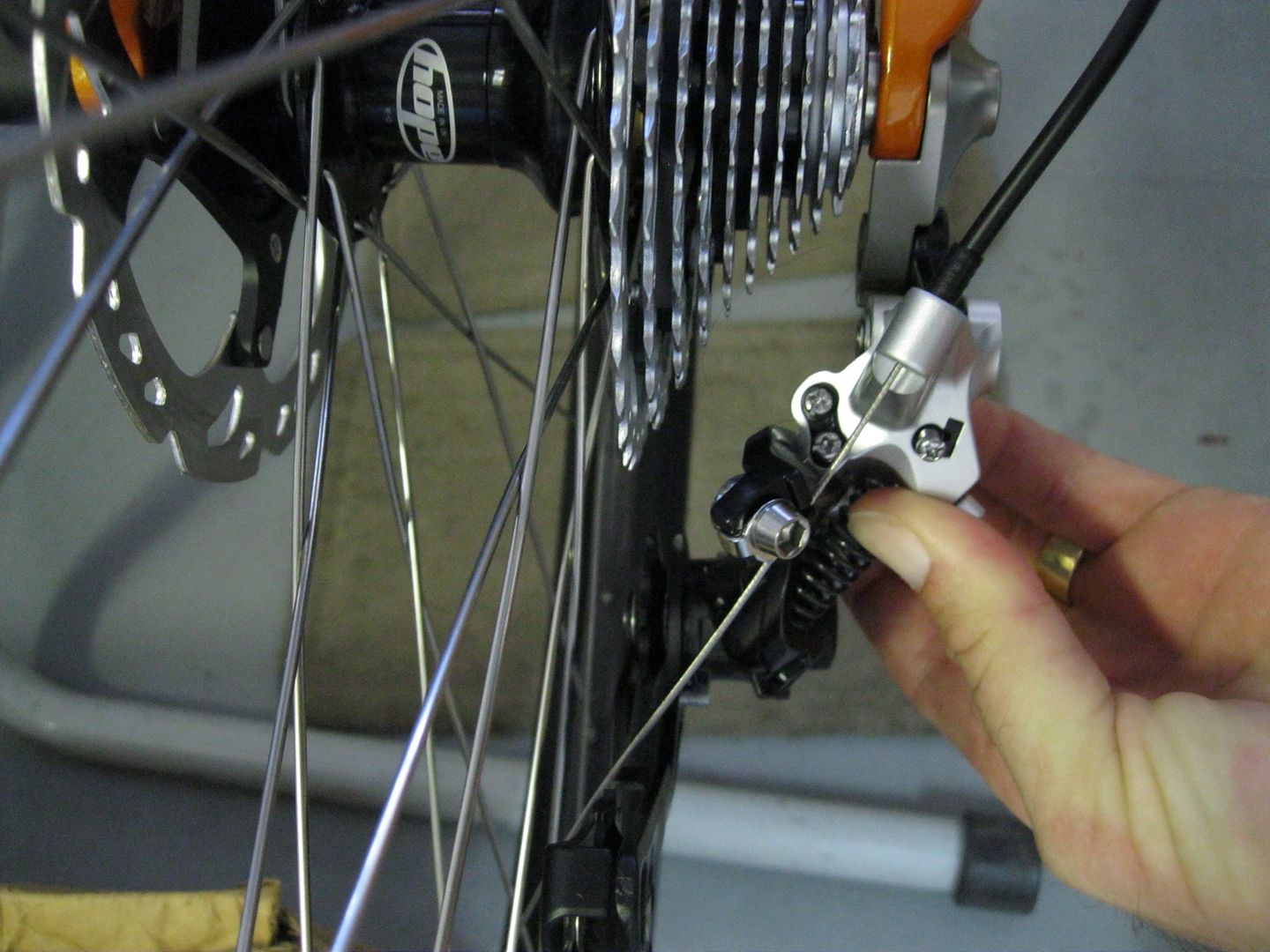

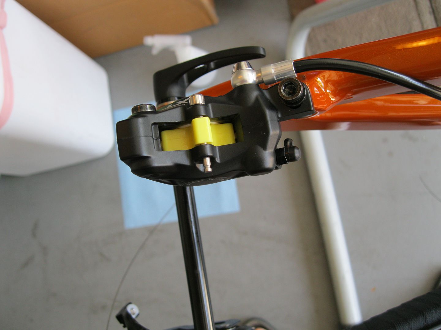

    The rear disc caliper mounts with two bolts, 5mm allen head, and wraps to the inside of the seat stay, well, like this..

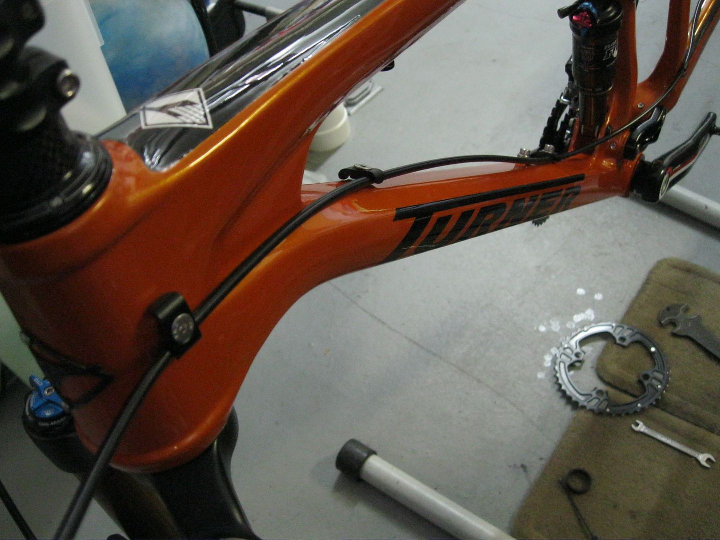

    Here is the brake line routing..
    Go ahead and hang your controls on the bars..

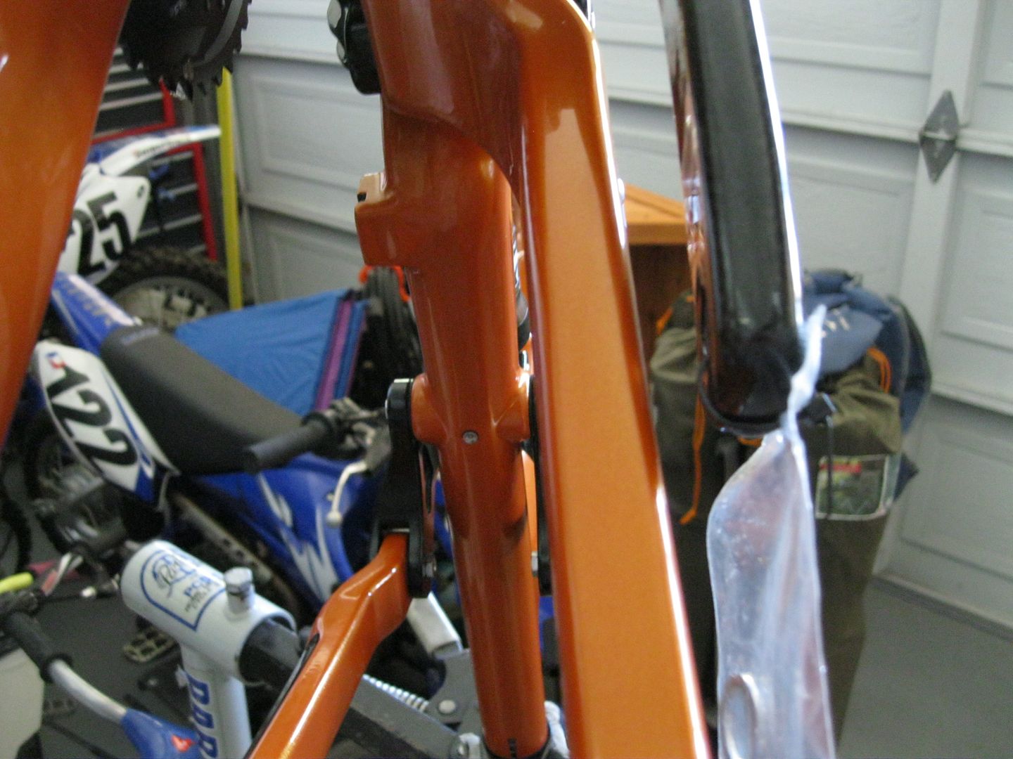

    Front derailleur housing goes in here..
    Mar 2011
    194
    Rear derailleur housing runs here..
    By the crank, there is a zip tie mount. Just one zip tie, pulled snug, doesn't need to be tight. Needs to allow for some flex as the suspension moves through it's travel. Just snug..
    Front brake caliper mounts like the rear, two bolts, wrap to the inside, avoid chance of scraping a rock and damaging the line...ask me how I know this little tidbit!
    238
    Sweet sweet build...oh man
    Mar 2011
    194
    Thank you!

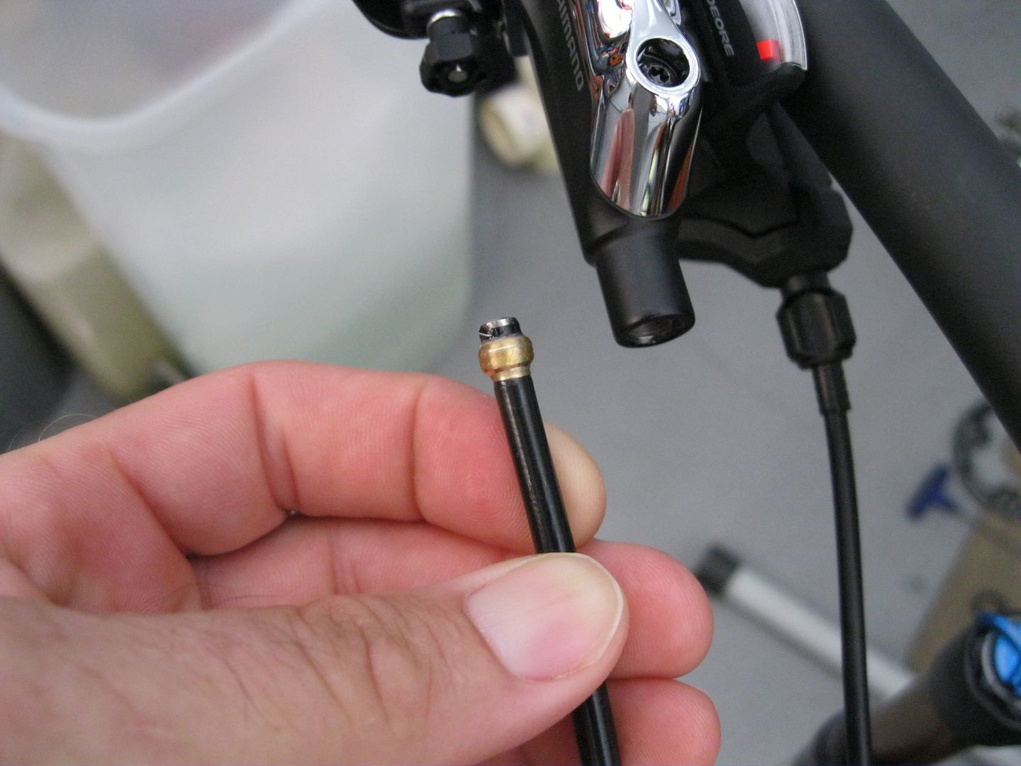

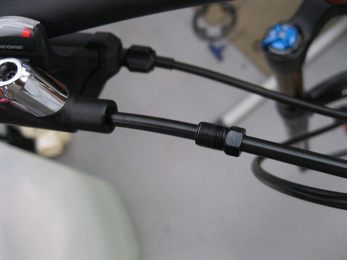

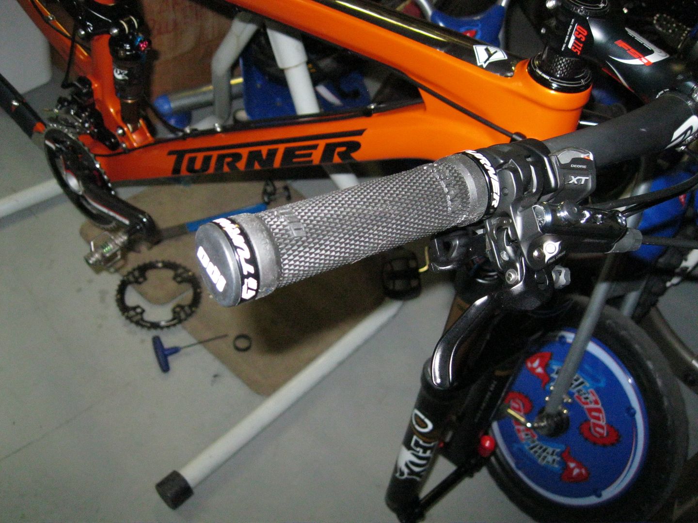

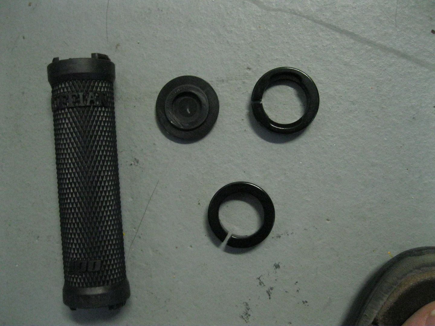

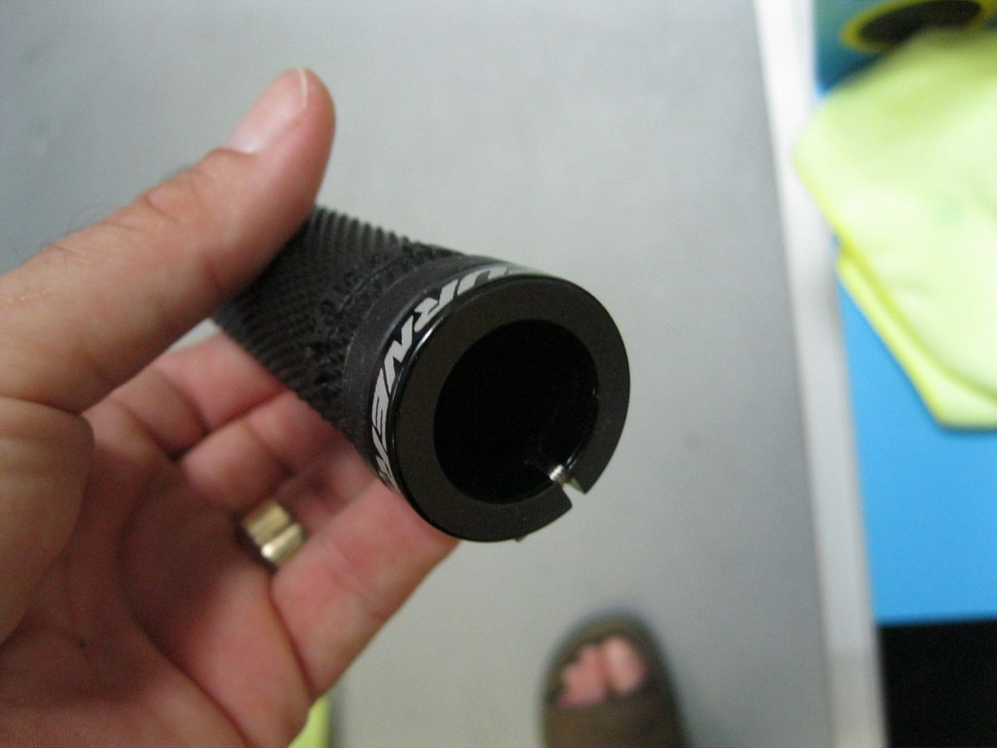

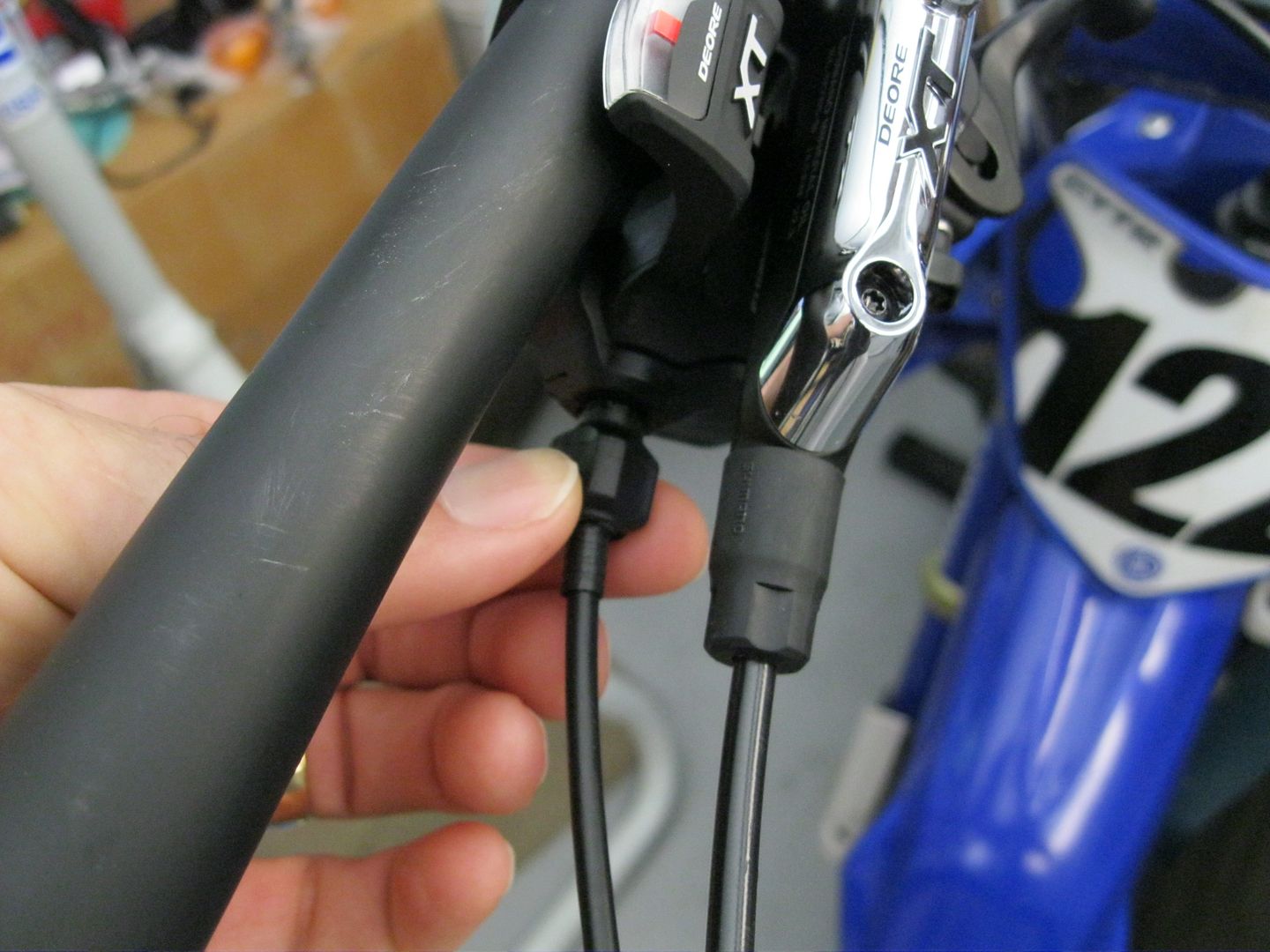

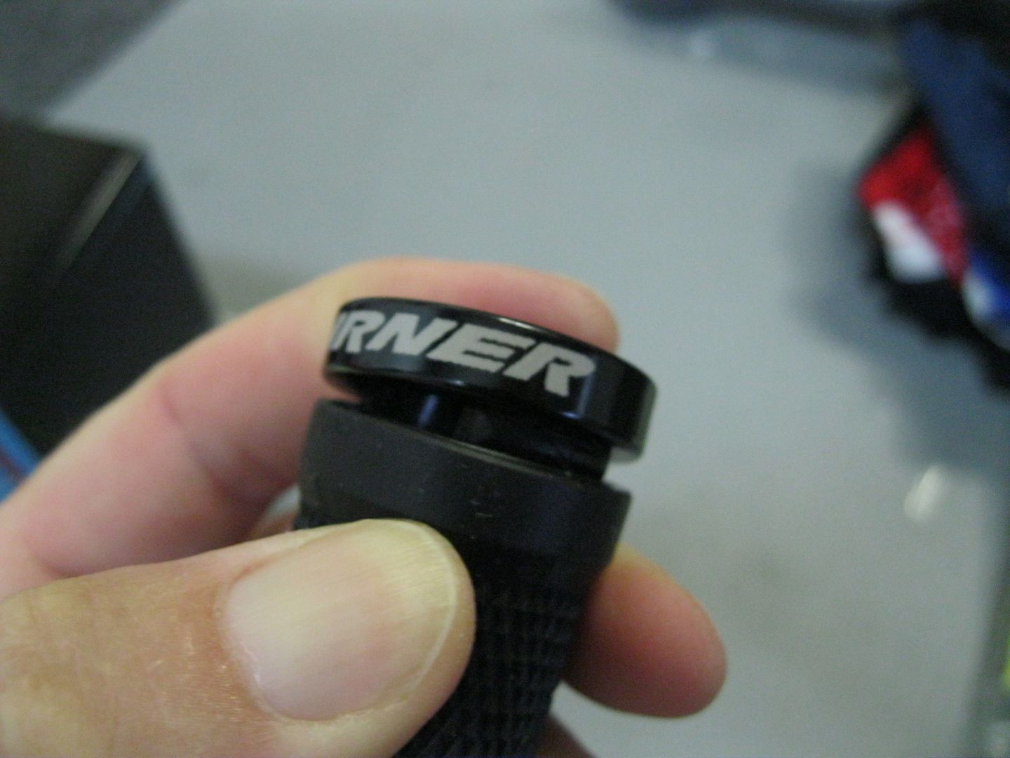

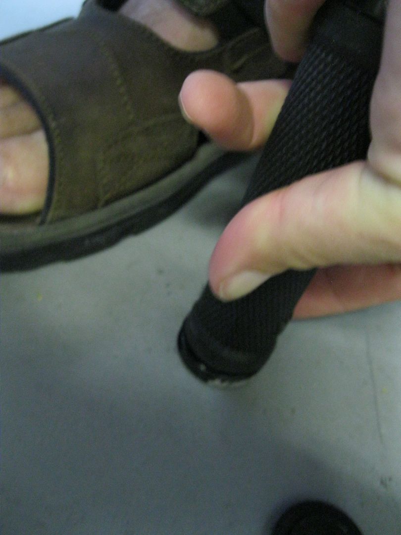

    Ok, so back to the controls, I really like the ODI lock on's.. They're simple, and effective..
    Snap the rings on before you put the screws in, and, make sure you have and "Up" side and a "Down" side.. I use the floor as leverage to pop the end caps on..

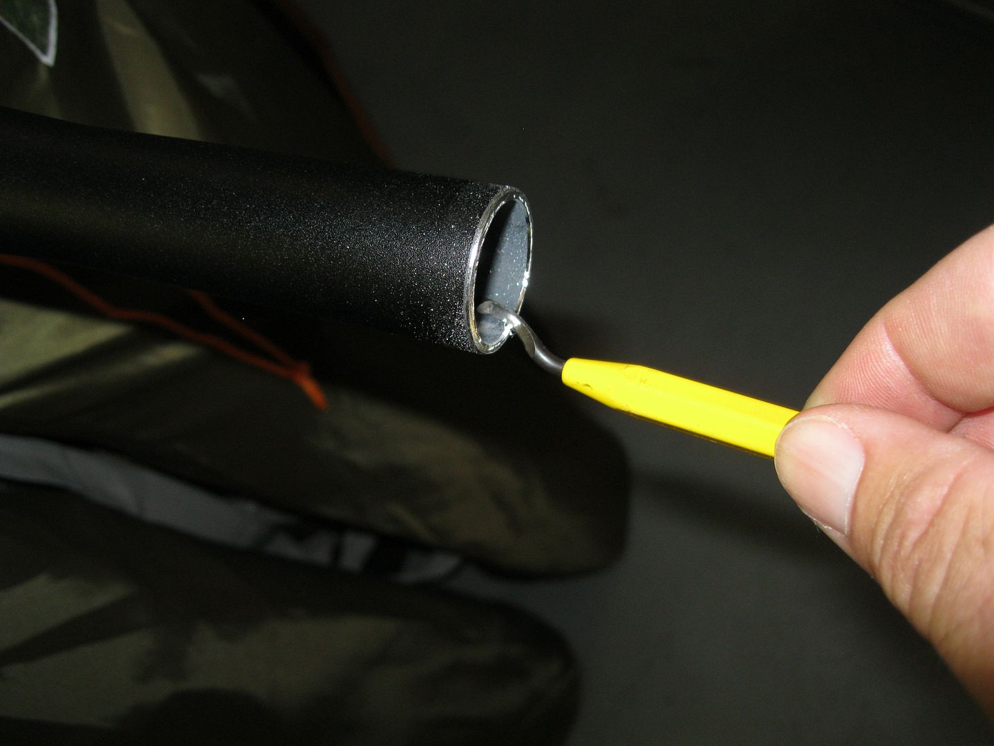

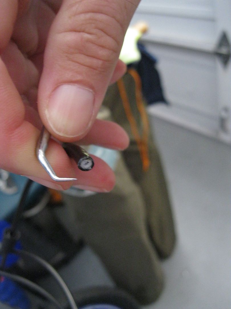

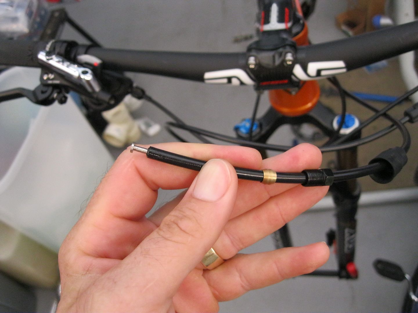

    On the shifter cables, the ones that come from Shimano are REALLY close.. But, I like a nice clean look. Once the grips are on, you can position the brake levers and shifters where you want them, then snug them up... they don't need to be "Mongo" tight.. I like to be able to move them if twist them hard.. in the event of a crash, they turn instead of braking. Turn the bars lock to lock and give just enough cable housing to allow without binding. Clip the excess off with a cable cutter, check the housing to make sure the inner sleeve is open, if not, use something pointy to open it, put the end cap back on, and run your cables.

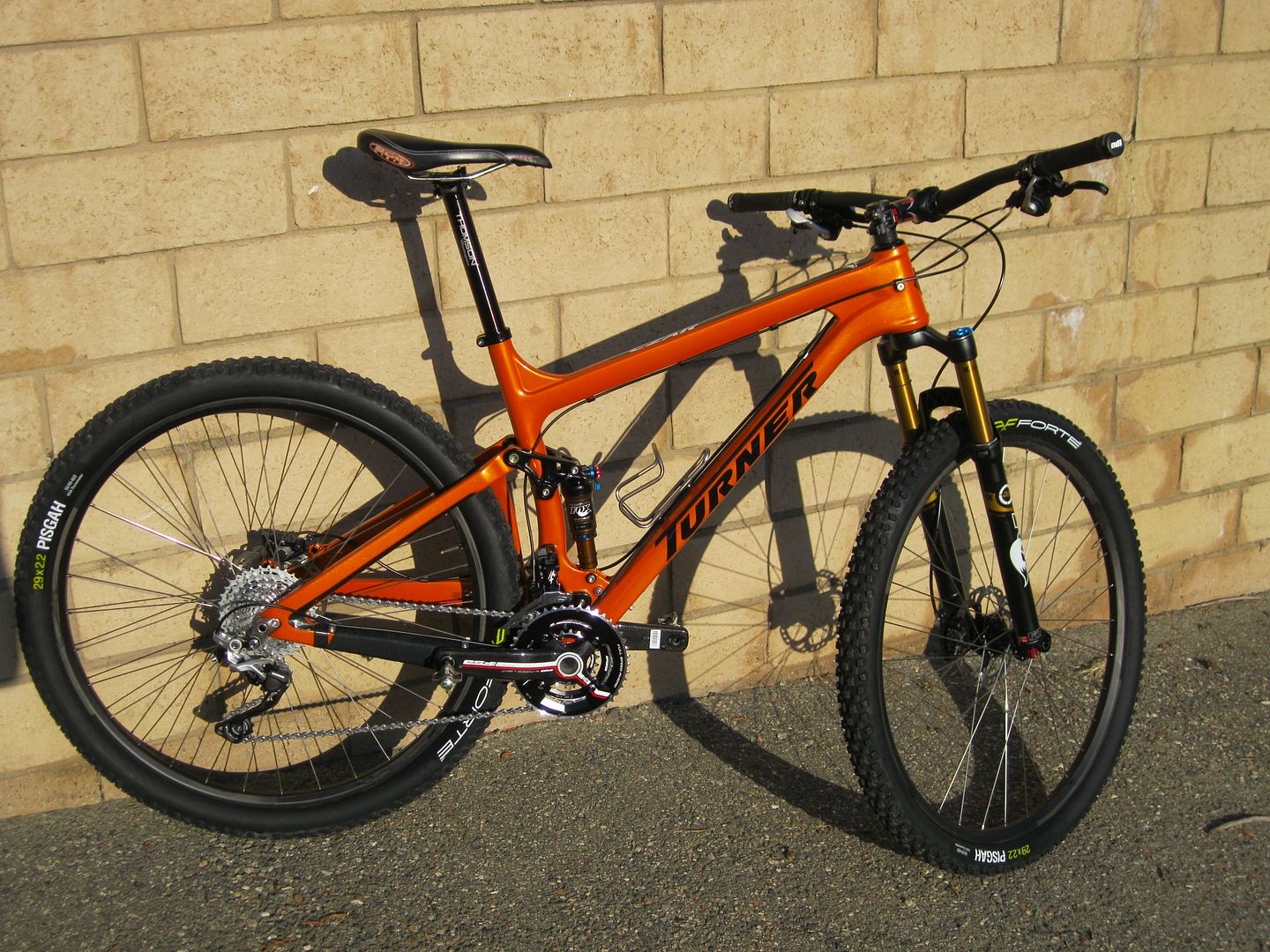

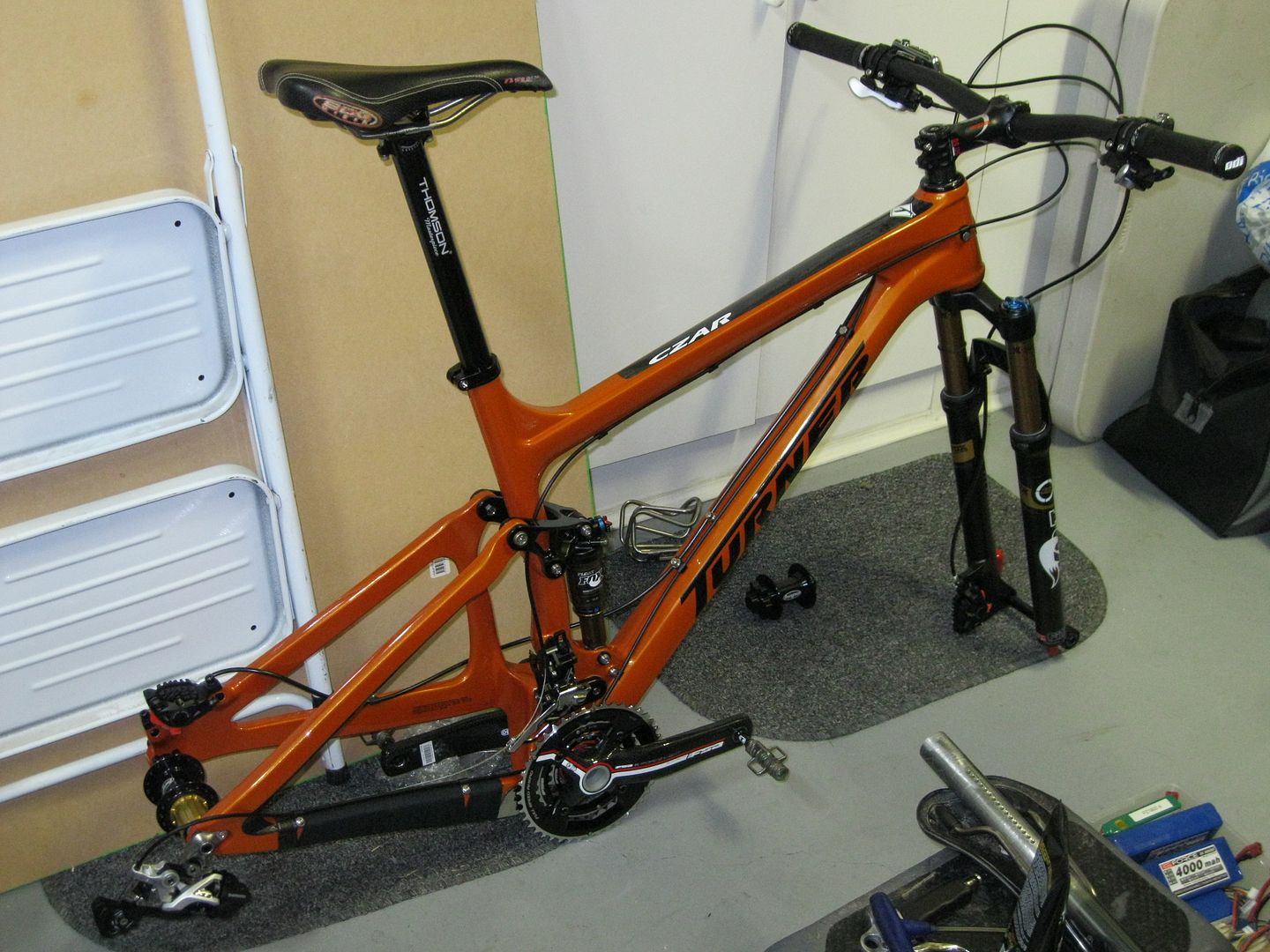

    So here's where we're at so far.. pictured here, 17.5 lbs.... the wheels and chain won't be too heavy..
    Can't wait!!
    Next I'm gonna shorten the brake lines.

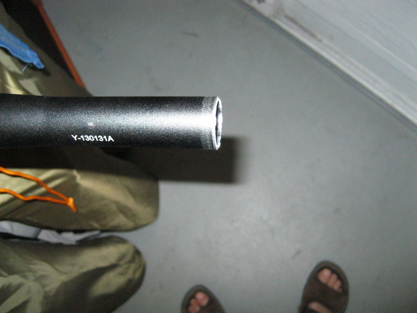

    I hope you didn't get any deadly sharp aluminum shards in your sandals!

    When I threw a leg over the Czar, it didn't need any fixing through suspension. It was awesome the way it was set up.
    So, on to the build.. I looked at this, and said yuck!
    So, time to cut the cables! Measure two or three times before you cut the cables!!
    You'll need these things..
    And a 8mm box end to loosen this ..
    That's what it looks like removed.. figure out how much you need to cut, move the bars all the way to one side, think full on crash without pulling the bake line out.. and cut the cable. Take something sharp, a pick, and open up the end a little..
    This is the order of things..

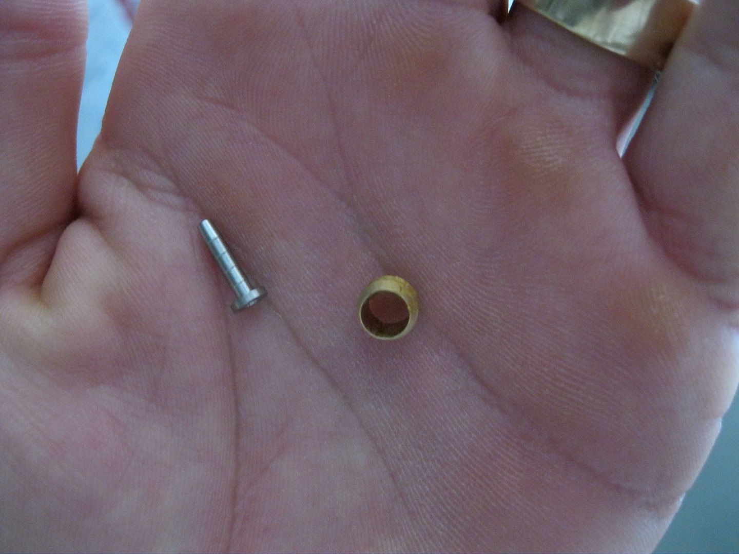

    Tap this in with a hammer, softly, no need to kill it..
    Now put it back int the brake lever, and tighten the Ferrel nut snug..
    Do the same with the other side... Now, doesn't that look better!
    Don't forget to bleed the brakes after shortening the cables. And to keep your pads working well, remove them and put in this spacer before bleeding.. I have many friends who have spilled oil on the pads while bleeding them, the pads will be ruined if they get oil on them, so, get them out of there.
    There's a ton of XT brake bleed videos on youtube, watch one of those first if this is your first time. Much more helpful than pictures.

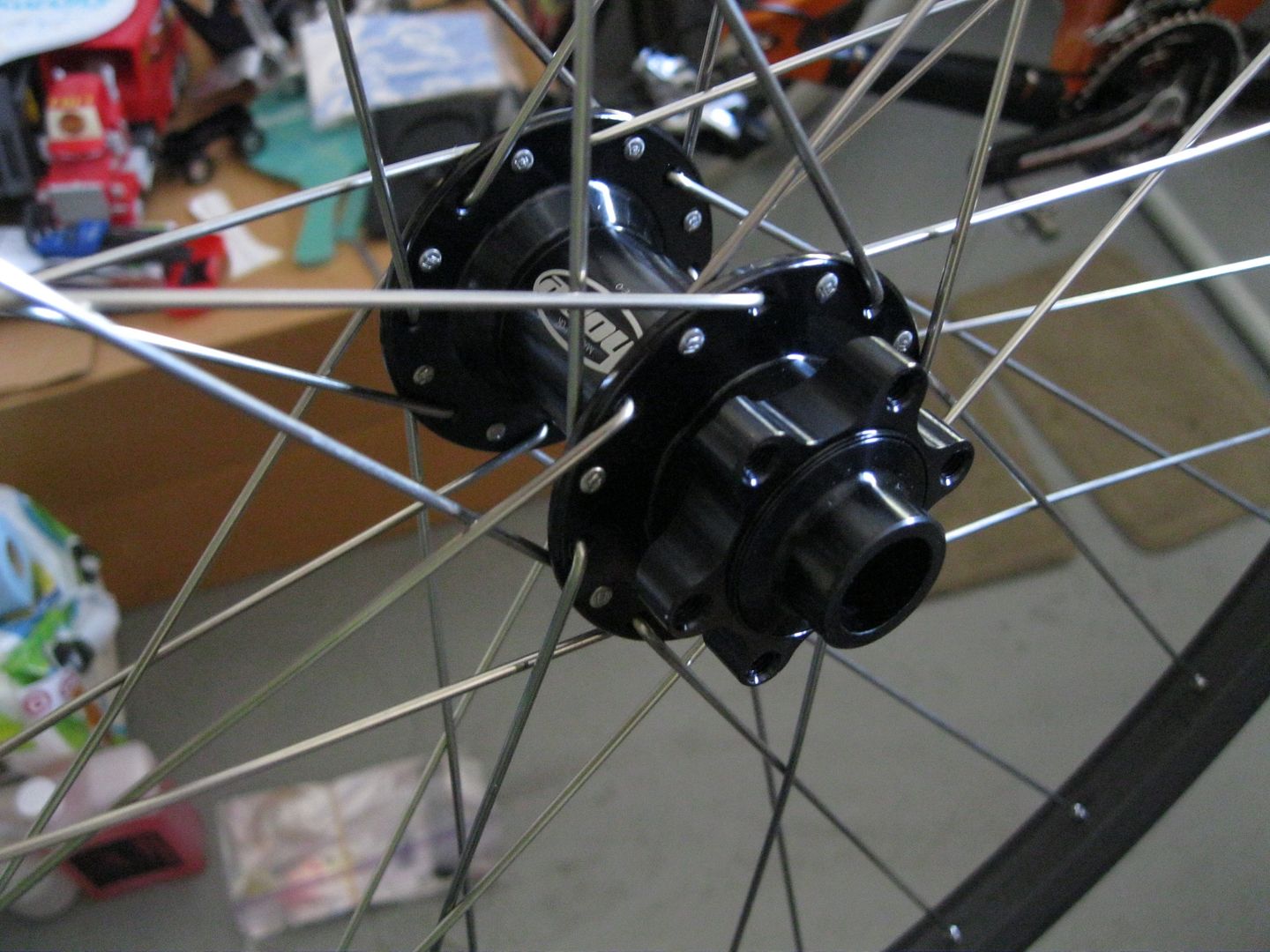

    Well, I got my rims, got them laced up to some Hope Evo's. Since it's a 29'er, I went with straight gauge.. Honestly, I may revisit that decision when I can, they're a little heavier than I thought, 1700 grams, I was shooting for 1600 though..

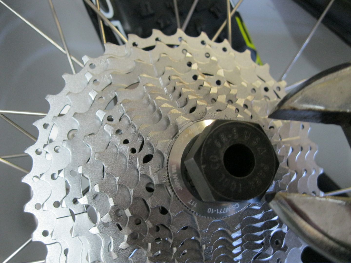

    Let's put this bike together now shall we..

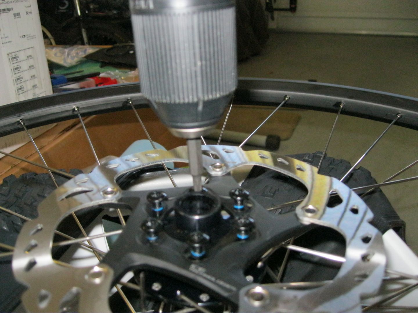

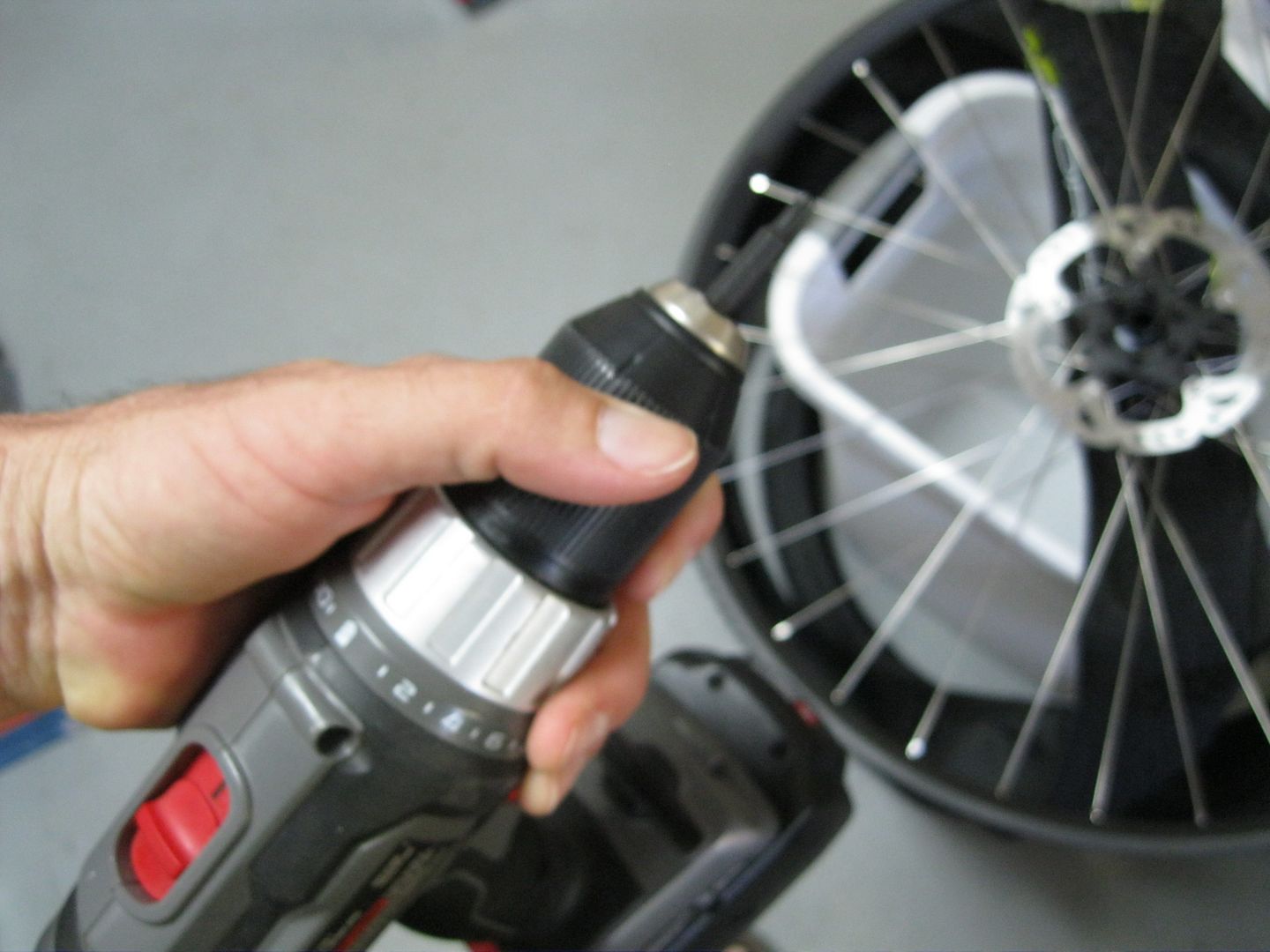

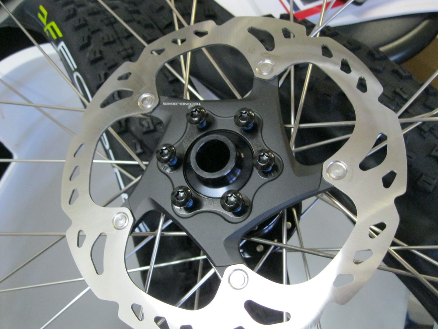

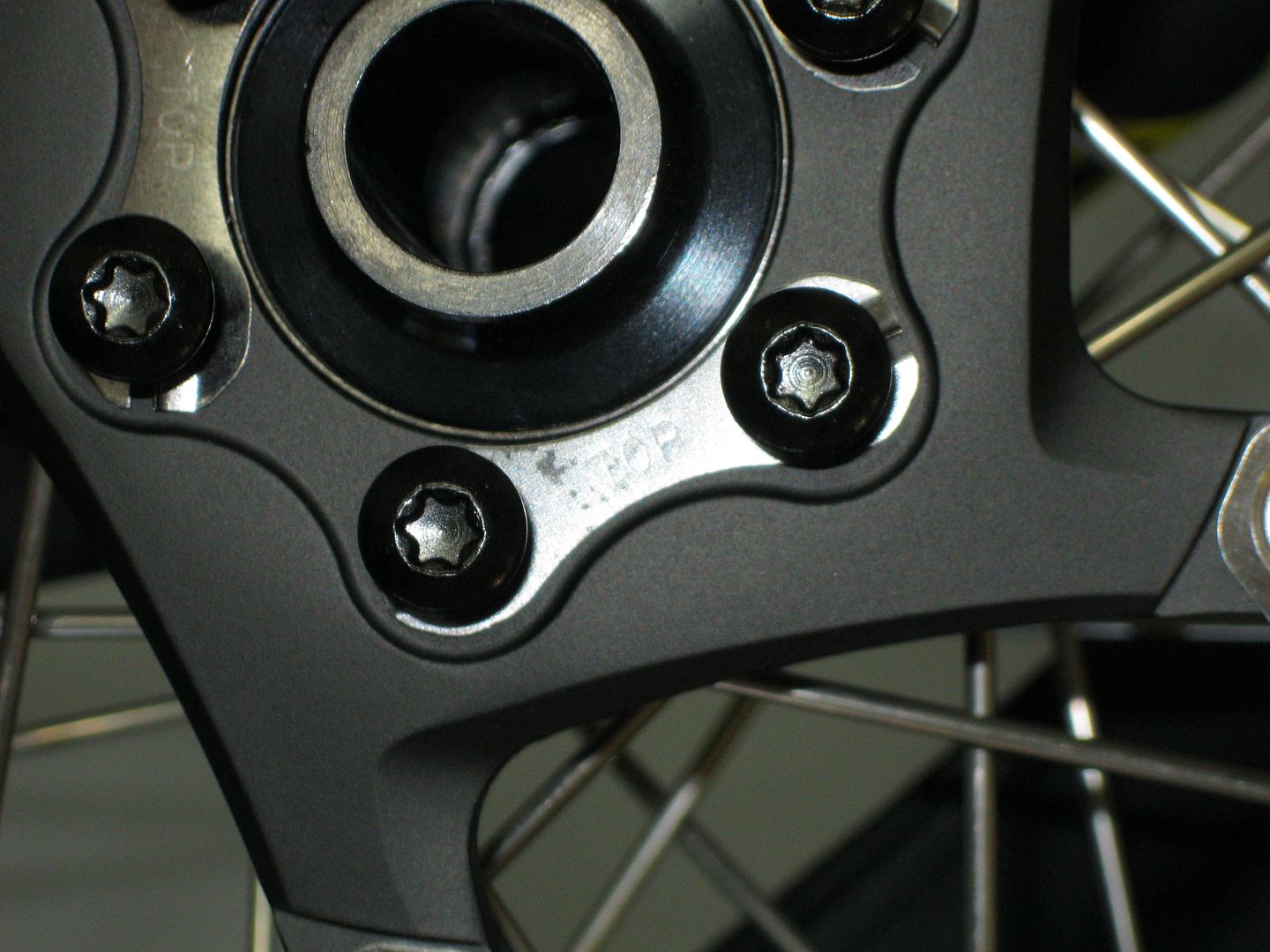

    Let's get the disks on, pretty simple, 6 bolts, use the little lock clips, they'll keep the bolts from loosening up. make sure you see the word "Top" or they'll just be extra weight. The bolts all have loctite on them, so, you can just screw them in with a torx wrench..
    Or, you can go my route... some things just take too long!

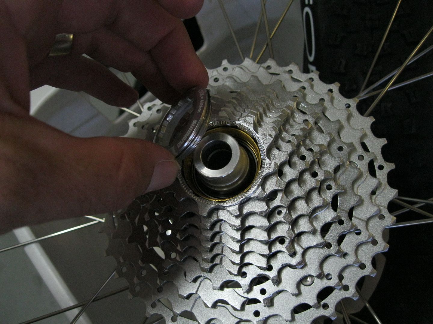

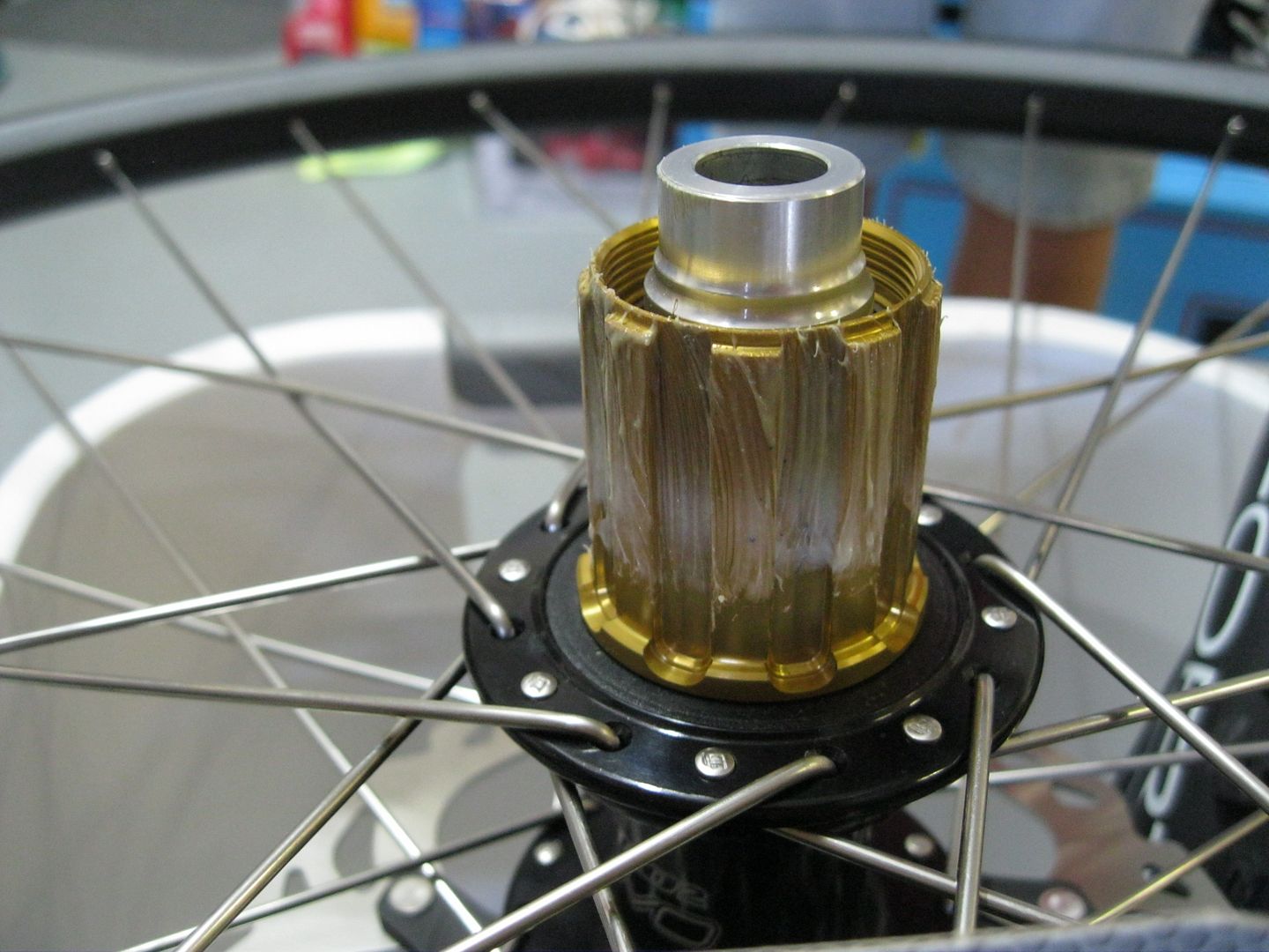

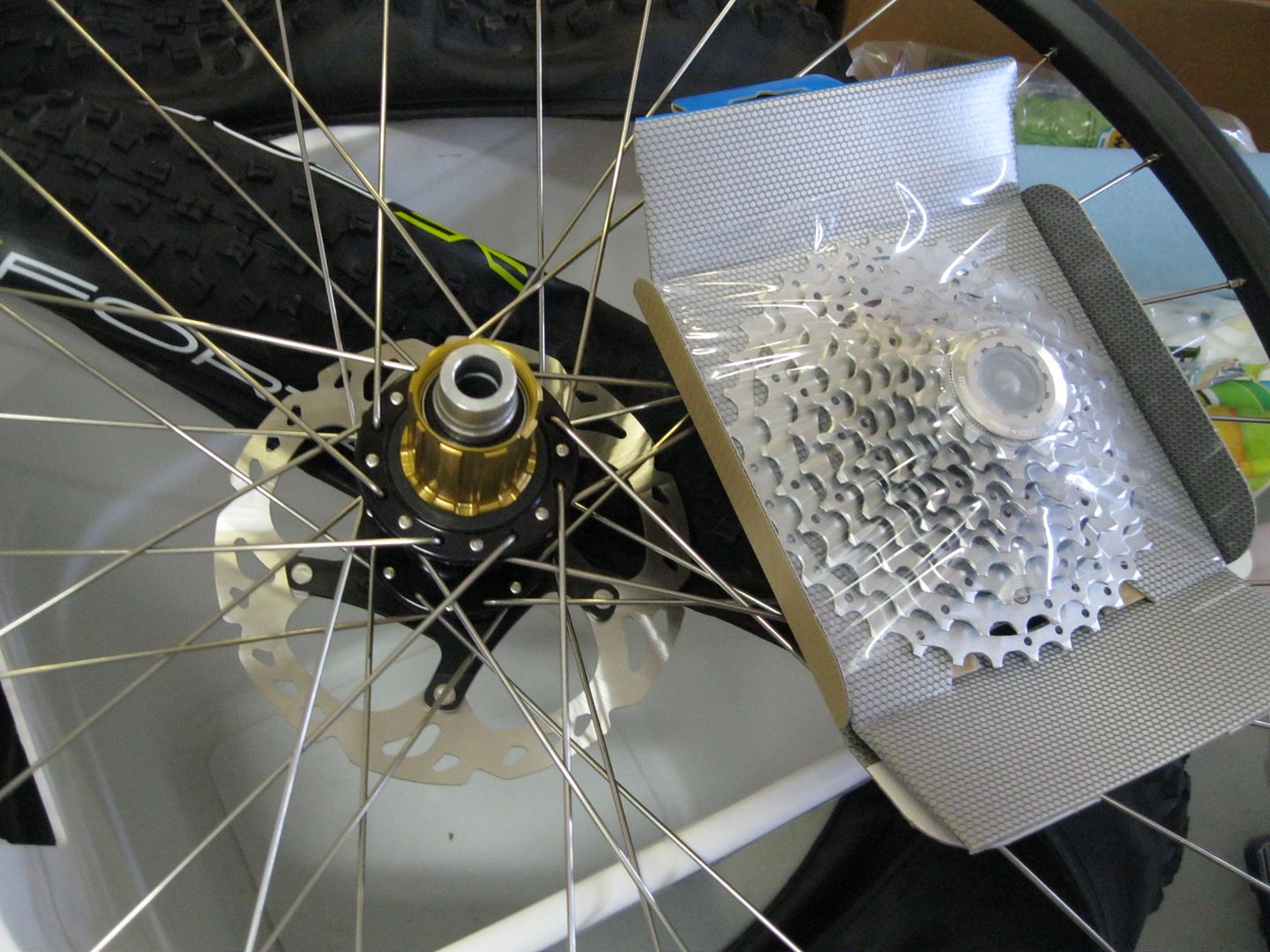

    Ok, did that to both wheels, lets get the cassette going. Thin coat of grease on the body, locate the large and small channels, and re-stack the cassette on the body. Thread the lock ring on, and tighten. Be careful not to twist the nut or the driver cuz the lock-ring is aluminum, and will strip or get gouged.

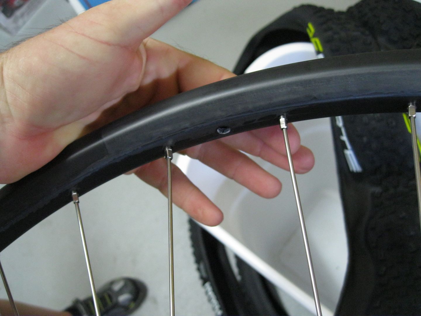

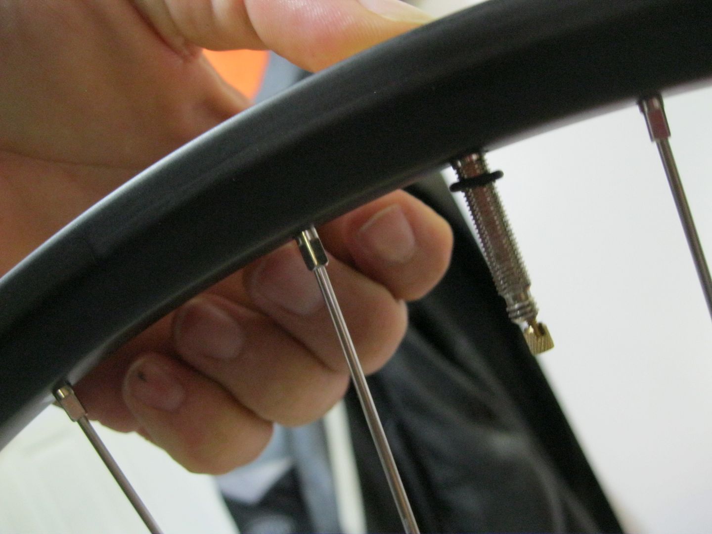

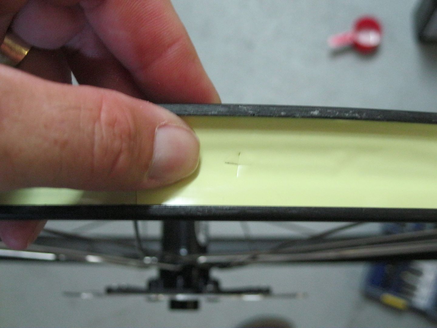

    If you wrap your rims with tape, you'll need to make a hole for the valve stem. Locate the hole and push something through it. It's easier than you might think to hit the wrong hole from the other side. (Wow, did I just say that??)
    Once you have the hole, put in the valve stem..
    put the o ring on, and tighten up the nut. Use fingers to tighten the nut, if you're out on the trail, and you need to remove the stem, you probably wont have a pair of pliers with you..

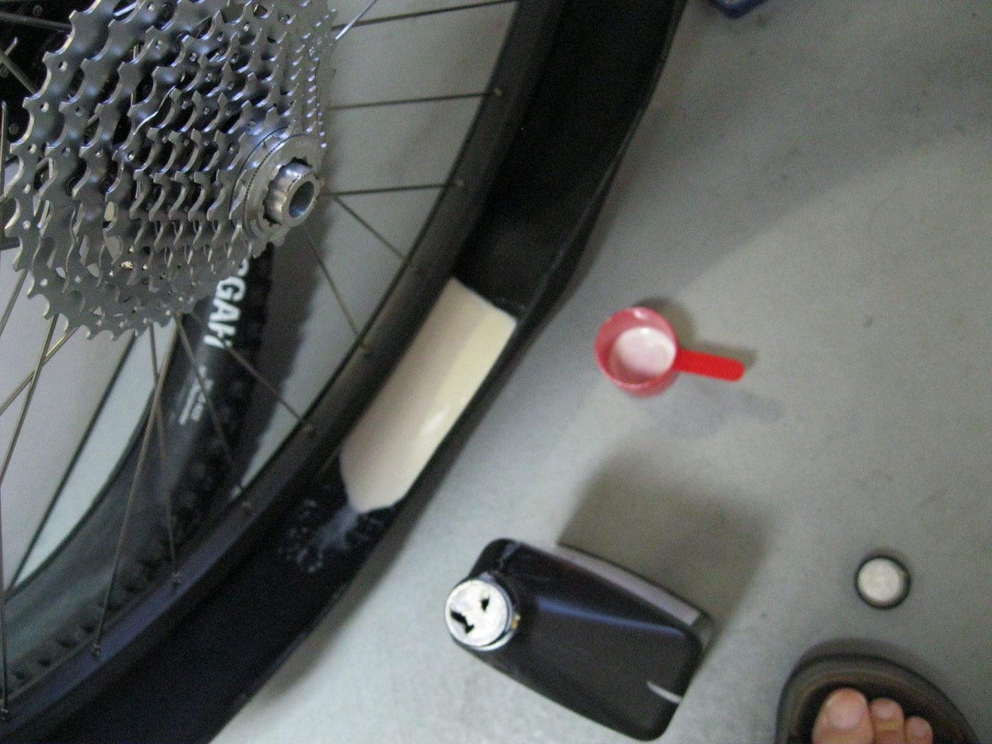

    Put the tire on, and two little red cups of Stan's...
    Seat the rest of the tire, and inflate with a compressor. I have a special tool I use for tubeless setups.

    Put the rear wheel in. The two bolts that hold on the brake caliper can be loose at this point, you need to aline the caliper to the rotor. A trick to doing this is to stick a business card on each side of the rotor, keeping the pads off the rotor. Tighten the bolts and your brake should be alined. Also, the DT axle, once tight, the handle can be re positioned simply by pulling up and rotating.
    Mar 2011
    194

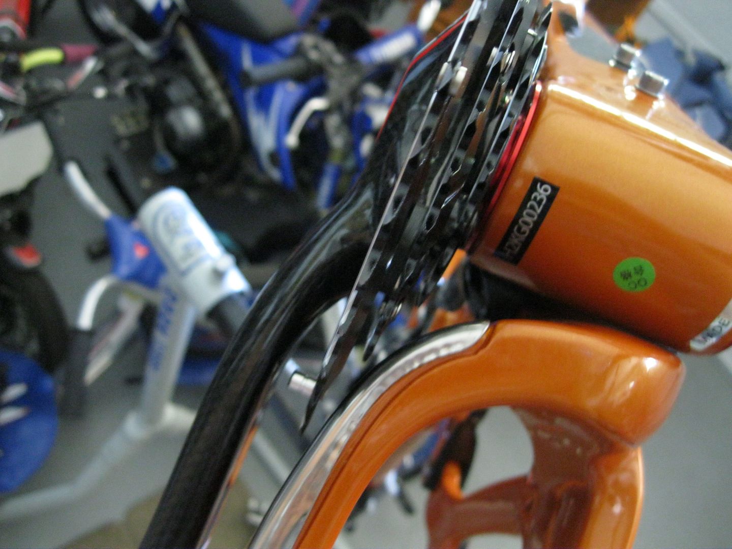

    I set the derailleur set screws before I put the chain on.. just easier to do that way...
    Hi and low on the rear..
    Then high and low on the front.
    I bottom out both shifters, pulling the cable tight, and tighten the end nut.
    I click through to make sure I have travel on both the front and the rear, then I click to big big.. I want to make sure the chain will reach. You can also go small small, and pull so the rear cage on the rear derailleur just put tension on it, but I like big big tight. As it worked out, no need to remove links. Woot!

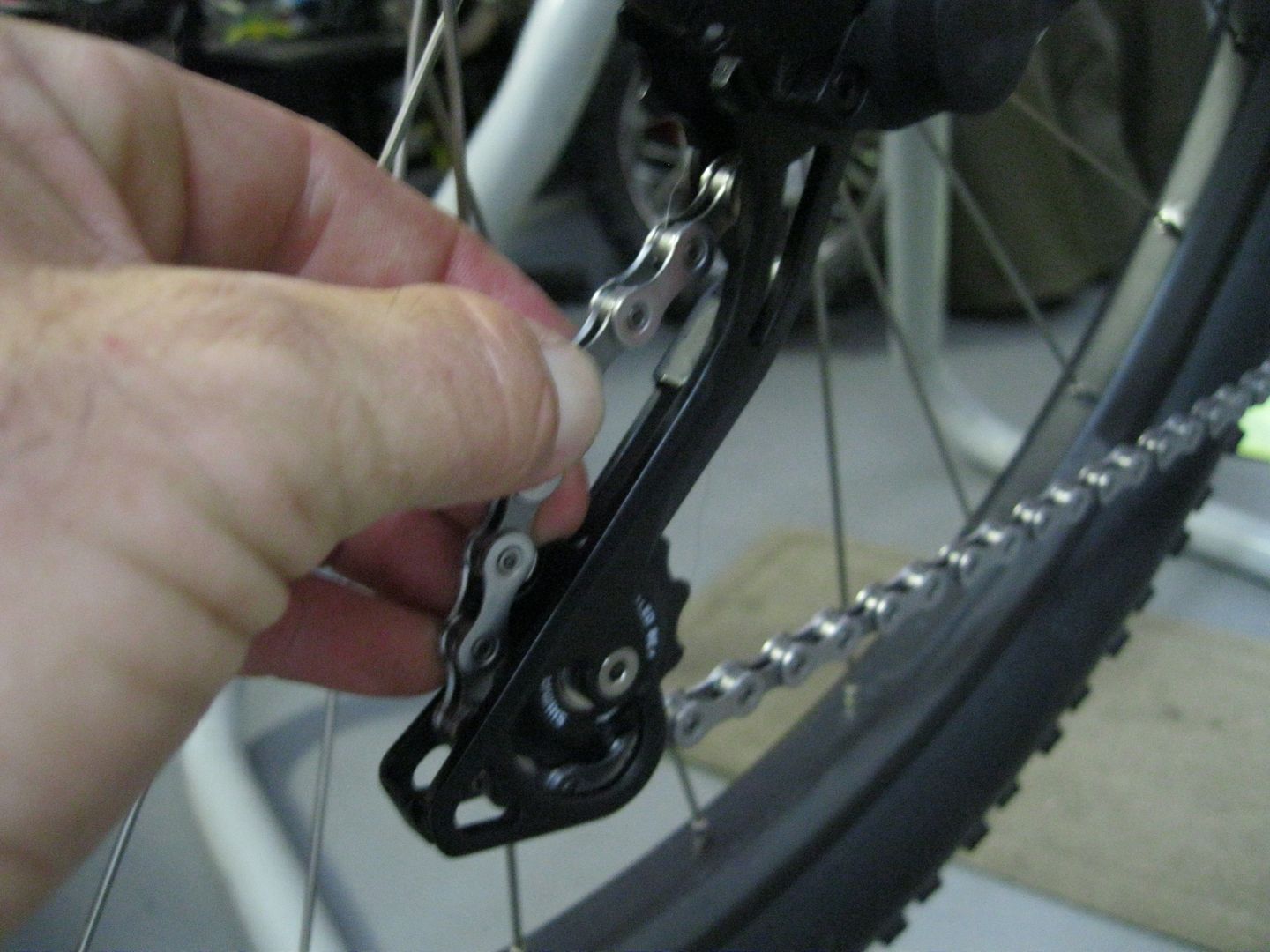

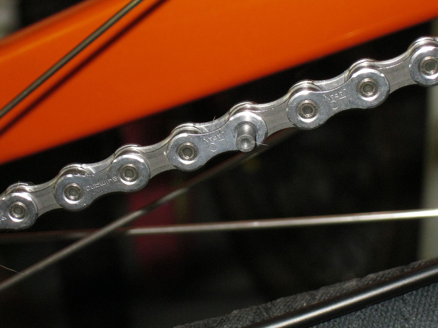

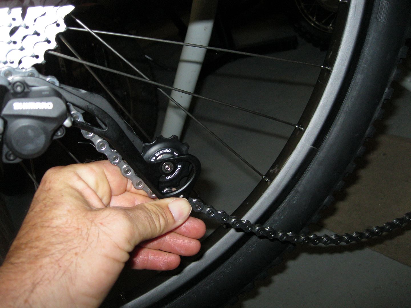

    Make sure when putting on the 10 speed chain, you have the lettering out.
    It's easy to miss this..
    BAD
    GOOD

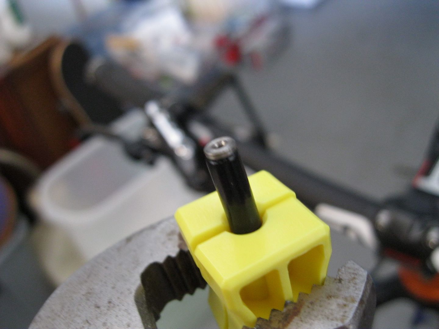

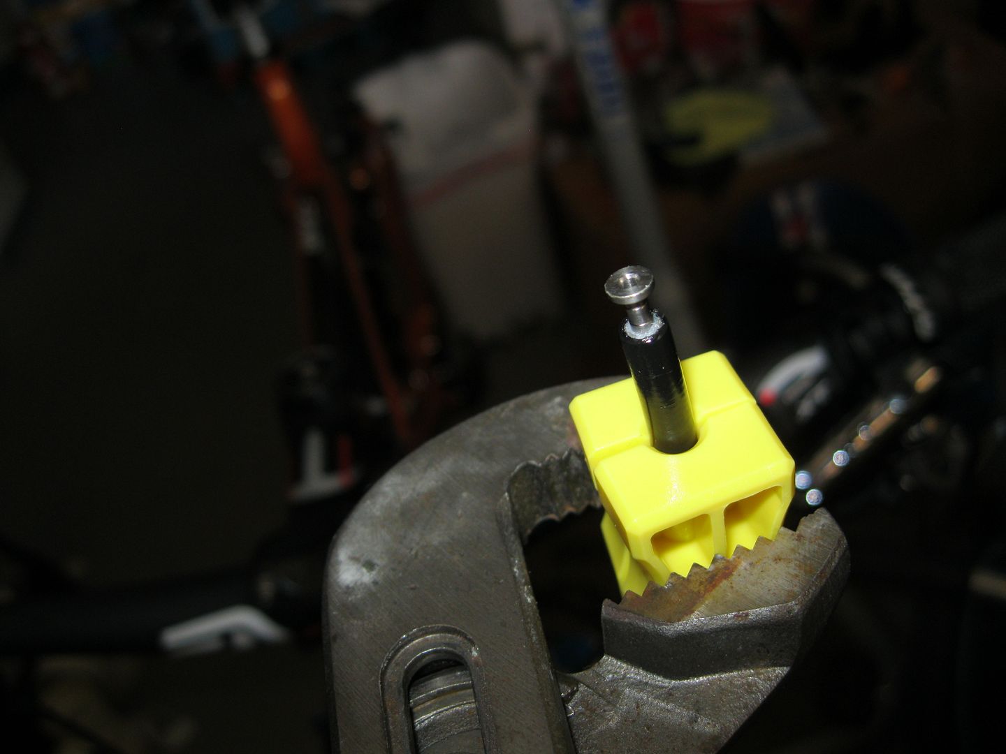

    Push the pin in with a chin tool til it clicks. Snap off the guide pin with some pliers, and spin through the gears. Make sure they all work.

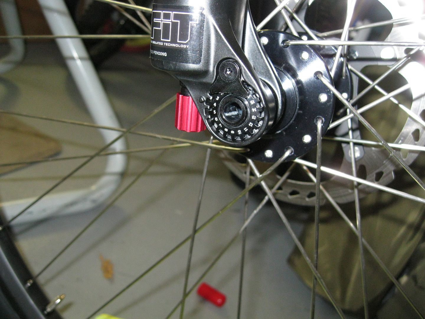

    Back to the front wheel, the adjustment is a little tougher than the rear. remove the little cover, and adjust the QR15 axle to your desired position. Put the cover back.
    Next, get your 5mm, 4mm, 4mm torque and 3mm allens. Use the 4mm torque on the bars and anything spec-ing 5nm..stem..
    take each allen and go through the bike one bolt at a time and make sure everything is tight. Once you're done with the 5mm, go to the 4mm...and so on.
    Check the cranks and the pedals.. You get the idea.

    Here's what she looks like now..
    Rode her around a little to get the creaks out of the wheels.. she's really nice.
    I'll get the seat adjusted and get the sag set, and we should be good!!

    Curious why chose to use a pin instead of quick link on the chain? Not something I've "chosen" to do since I found out about quick links and never had issues.
    Old habits die hard... I used to race DH and on two different occasions, we lost chains due to QL failures on our DH run's.. didn't play well with the chain guide. Once it cost me a win..literally..not maybe, really took first place from my grasp. It's so so hard to win on a national level, but that 2nd place, breaking that chain 100 yards from the finish... hurts still.
    Since then, always used a pin.

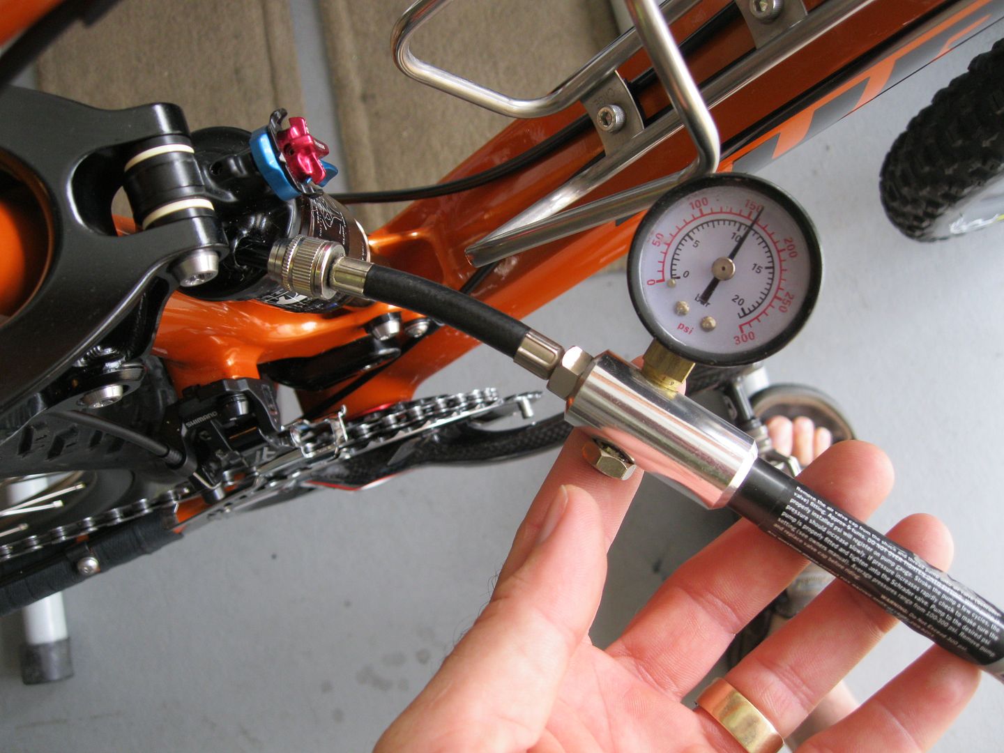

    Ok.. gonna take her out for a little spin.. I don't know if I'll do dirt, I'm 9 weeks post surgery on a clavicle, but, I need to ride it!!

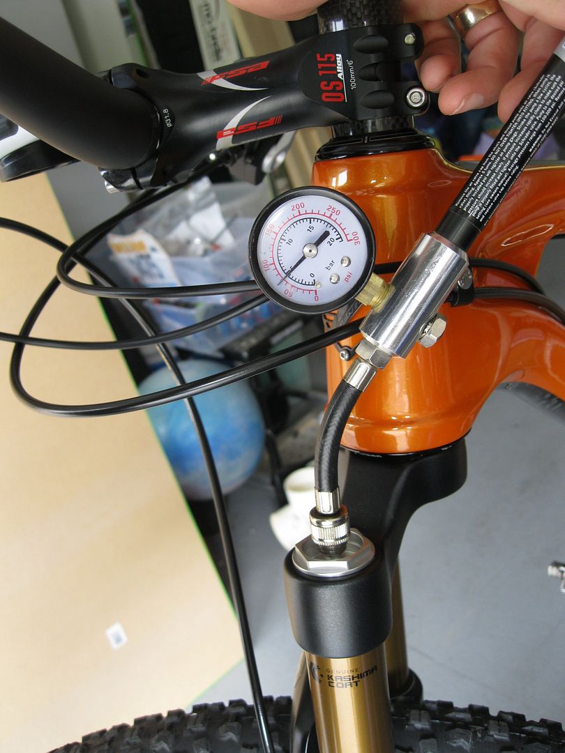

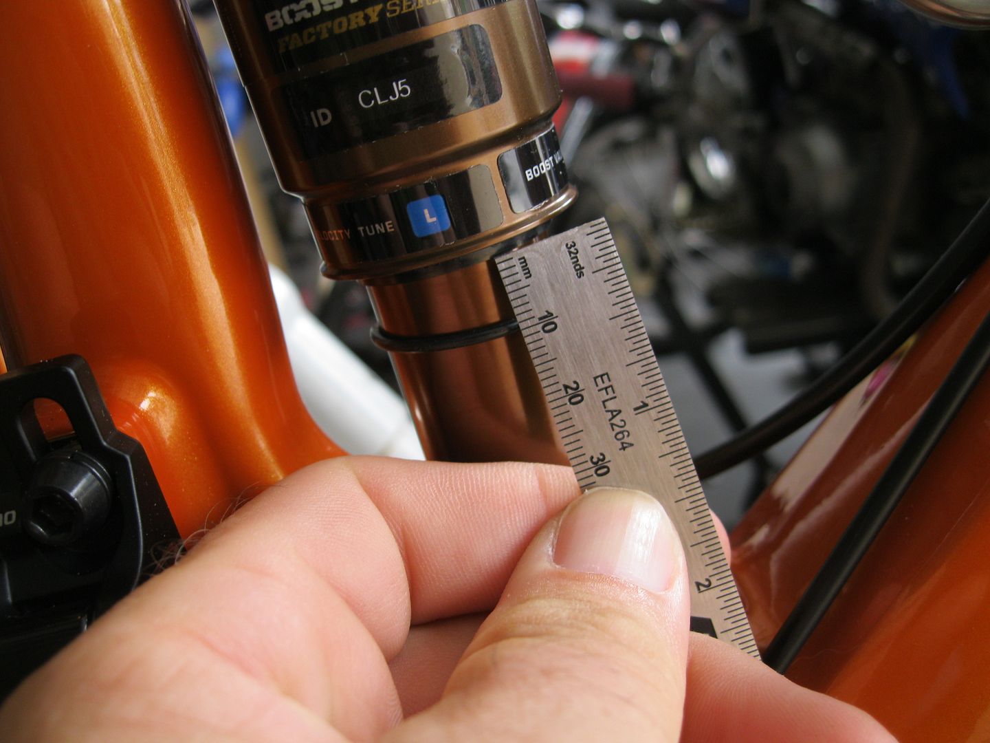

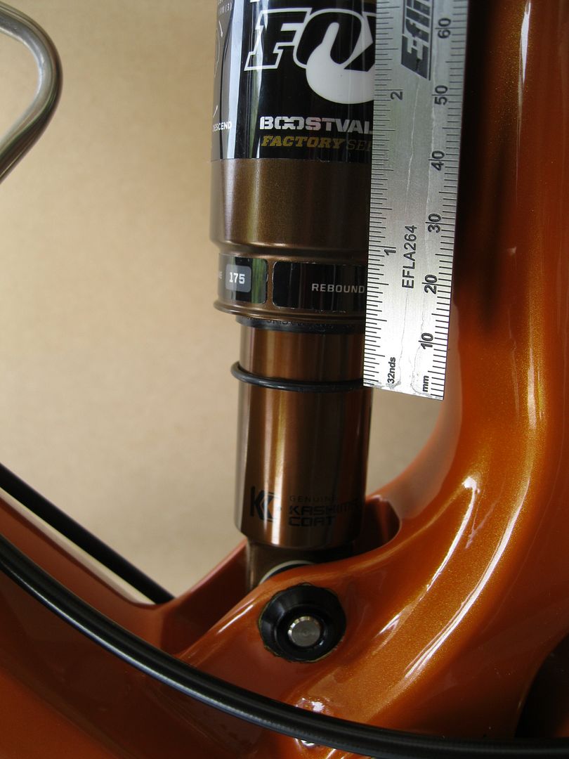

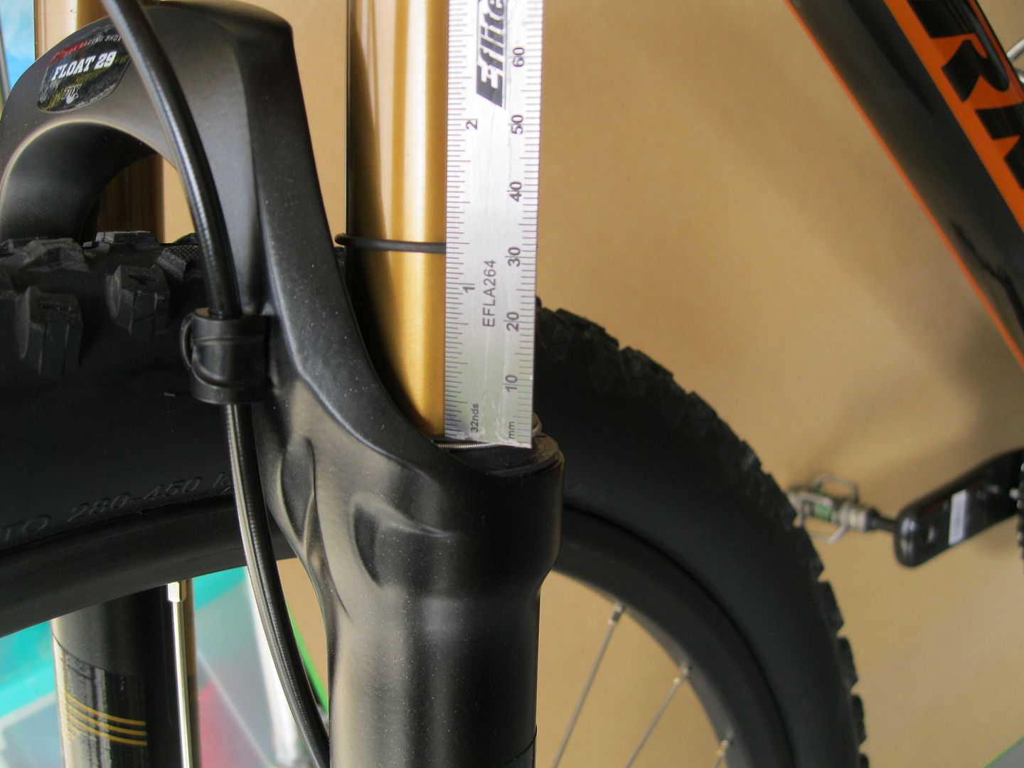

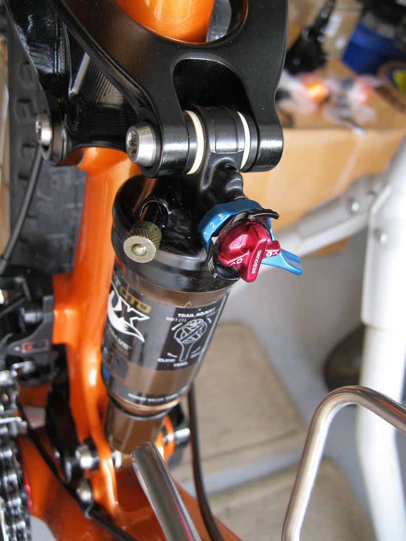

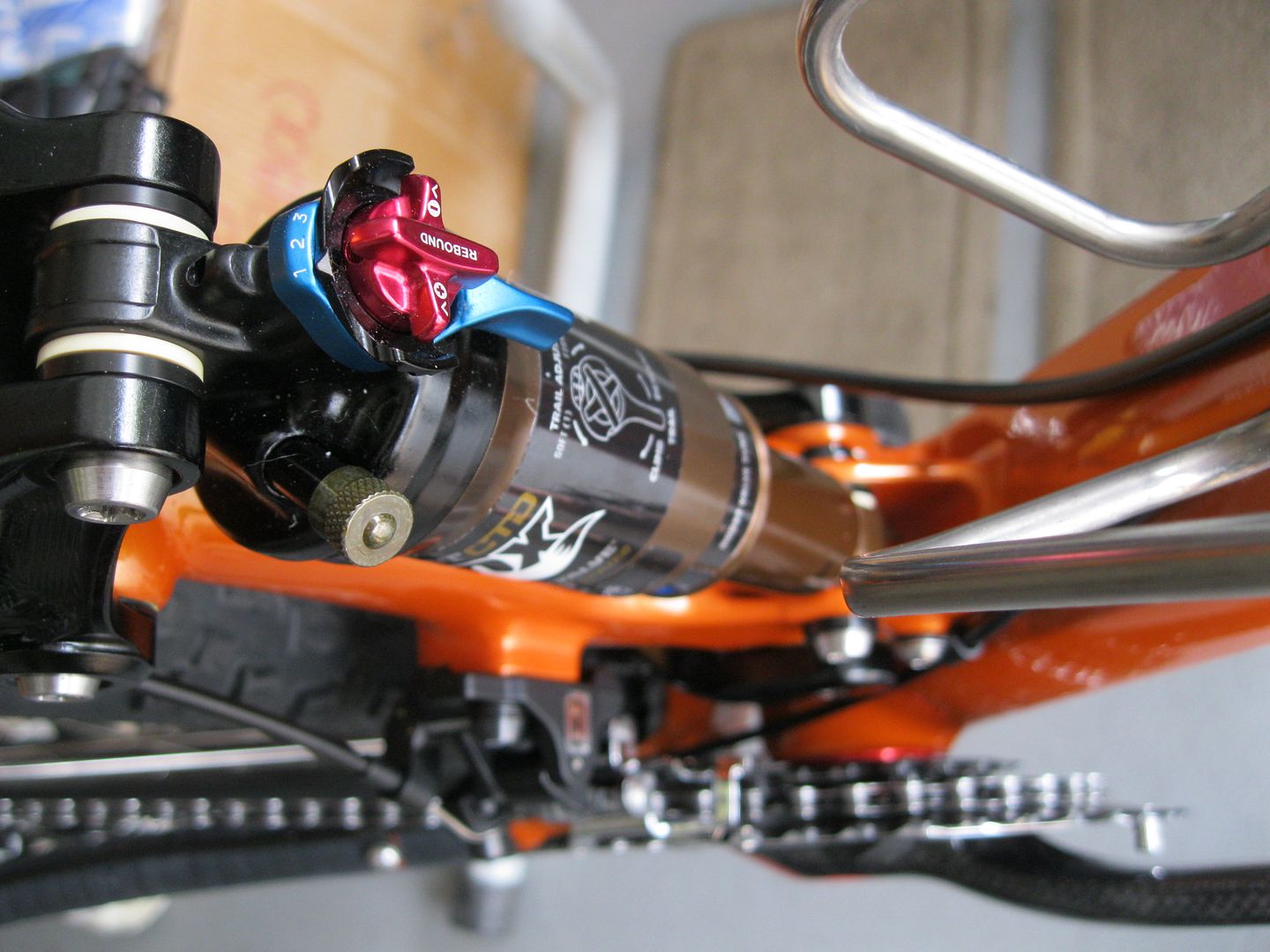

    So, I weigh 175lbs ready to ride (RTR).. For the Turner, the rear sag is supposed to be set at 10mm. Thats RTR in riding position, with the front sag set as well. Fox calls for 25% sag..so for the 120 fork, between 25-30mm.. I'm gonna let the fork sag a bit in the travel because I'm running a 120 and the Czar is set for a 100. I'm guessing, it wont be an issue.
    Sag is easier to set than you might think. Most people I've seen, never spend that much time setting sag. Start with this, with a sharpie, mark where you want your sag. A dot a small line, it's doesn't matter.. Ride your bike around, and keep pulling the o rings on the shocks back .. ride over stuff, jump some curbs. stop a couple times. Set the o rings one more time, then roll to a stop, don't hit the brake, just smoothly roll to a stop, un-weight the bike, and check sag.. do this a few times..til you get it right. Seems mundane, but, you will thank me for a properly set up bike later!
    Rebound, kinda a personal thing, but, set it so the shock comes back slower than you think it should.
    Oh, and make sure you're setting sag when the bike is in the "softest" position on the shock.
    So for me, I'm starting at 70lbs in the fork, 150lbs in the rear shock.
    Check the sag again for a couple rides, everything will settle in.. I think that's it for now..

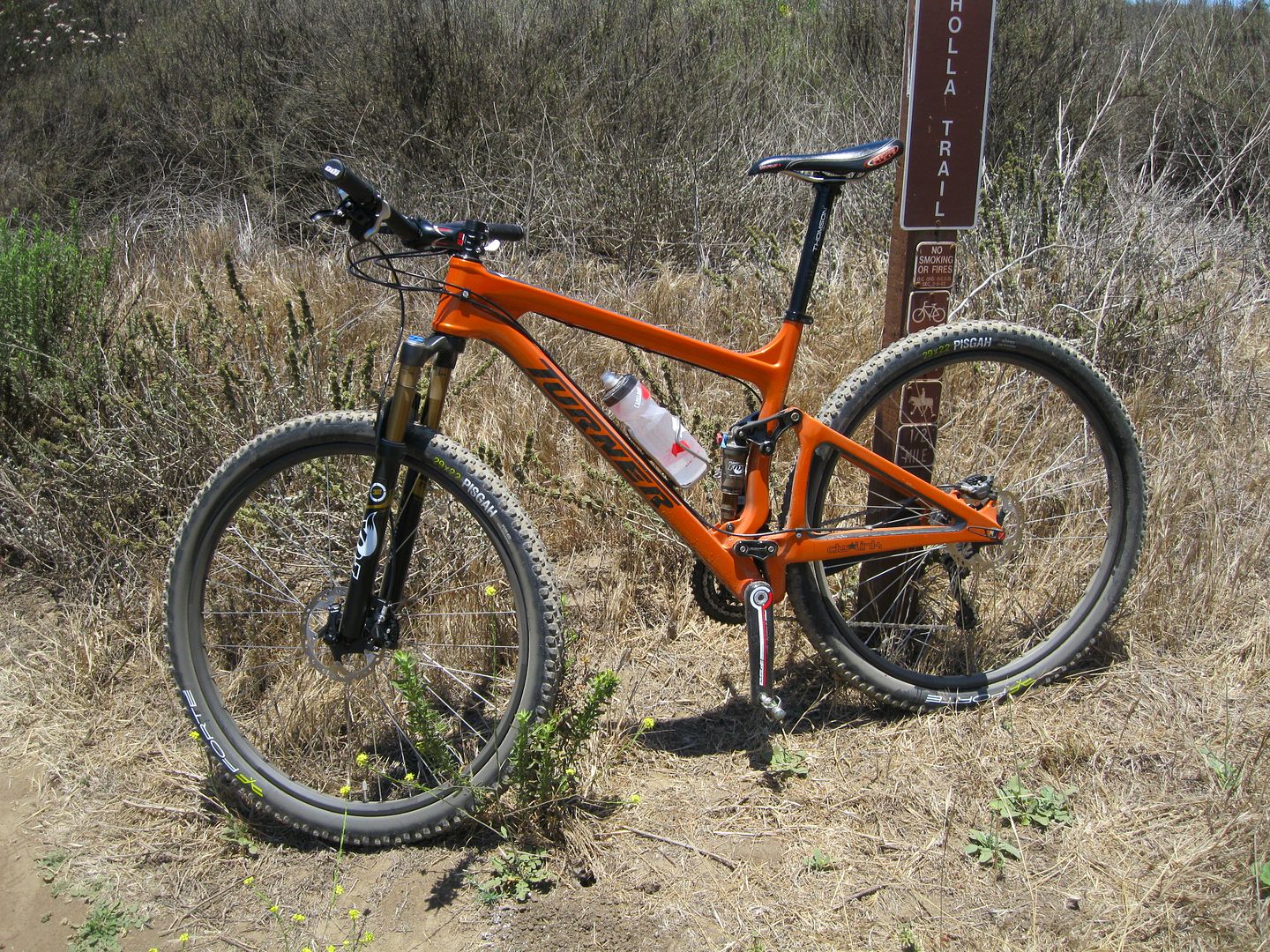

    So I took it out for a little shake down ride..
    I'm recovering from an encounter with a deer, and he won. So today I'm 9 weeks post op.. so, per the wife and Dr, no mountain biking.. I have however done a little road riding the past couple of days pain free, so I'll just take a little road ride, make sure everything fits..
    The first thing I noticed was the seat needed a small amount of adjustment. Also, the FOX CTD shocks work really well, I pretty much stayed in Trail mode. As expected, works great with the frame.
    So I got to Aliso and decided to go in... I'll just ride the main road in a little.. switched the shocks to D mode, to keep it as plush as possible..
    The carbon rims are STIFF!! Need to play with the tire pressures. The Czar wants to go.. I was running about 11.5 mph pace.. usually I'm in the 9's 10 on a good day.. and I really wasn't pushing..
    I stopped at the bottom of Cholla, next time..
    On the way out I almost crapped myself!!!
    Beast!!!
    35.7 miles later I'm uploading pics for you guys!
    Everything is tight and shifts well. The brakes don't rub, and the seat is finally adjusted right.
    Now I need to heal up a bit more then I'll give it a sound thrashing.. but for now, I made a GREAT choice for my first 29er!!
    Hope you guys liked the build!

    Check the head set. With the bike on the ground, grab the front brake and rock the bike back and forth, grab the top of the headset and feel for movement. Adjust if needed.

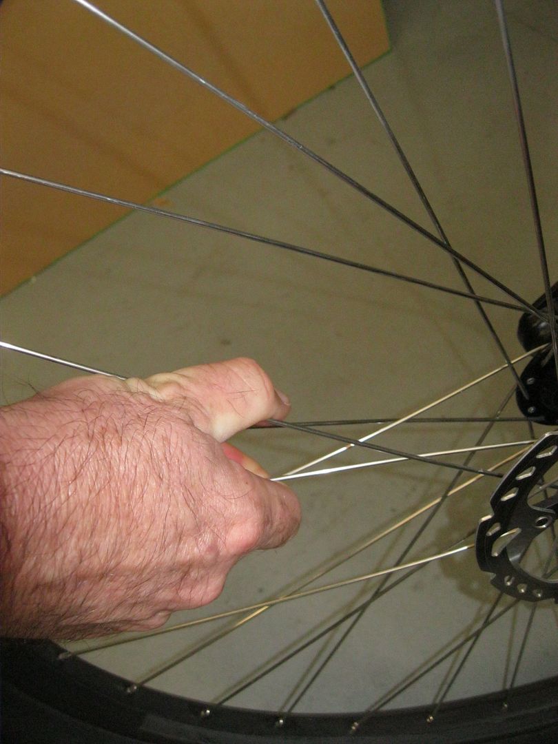

    277 miles later I can say this IS the best bike I've ever had. It's faster on the flats with little effort.. and It just begs to be ridden. I did Meadows for the first time since my broken clavicle, and first time on this bike, just cruising, even paused for a hiker, and still managed a 4 min flat.. I think my best time was a 3:51.. So without pushing it, I was able to get within 9 seconds...nice!
    So follow up with the build, since the wheels are built up, I like to check the spoke tension. Work your way around the wheel, if they feel tight, just true the wheel. If they feel loose, work your way around the rim tightening in 1/8th turn increments. Recheck the spokes.
    I cleaned off the dirt, gave it a coat of quickwax, and tensioned the spokes.. the rest of the bike is perfect!

    Quote Originally Posted by YamaDan View Post
    BAD
    GOOD
    Ok, Im going to bed, tomorrow we'll tackle sag!
    Just now reading your thread. I love negative rise stems and riser bars, with a little bit of over fork! Killer for the ups and the downs!
    Stupid, but sometimes witty. Occasionally brilliant. Slow and fat though.
    Mike Vandeman Sucks Dong
  86. #86
    Dec 2013
    964
    Quote Originally Posted by gmats View Post
    Excellent idea with the cotton tape. One suggestion, maybe you can take the cable guide off, wrap the chain stay and use a Xacto blade or pointed spoke to poke a hole through the tape and put the guide back on? Just seems like it'd look a bit cleaner.
    I copied YamaDan's cotton tape idea, but under the cable guides like gmats suggested. I like it!
    EDIT: never mind. I tried the Sram and it was terribly tight. Enduro caps it is.
    But leaving for others:
    I've got the same BB, and just bought a Sram X0 crank to run the Czar single ring. Any idea which dust caps to use (my options are below -- SRAM left, Enduro right)? I'm not seeing anything in either the SRAM nor Wheels Manufacturing install manuals.
    I tried first with the Enduro caps and I'm not impressed with how smoothly the scrank spins. I'll try the SRAM caps tonight, but it doesn't seem like I should be guessing here.
  92. #92
    Mar 2011
    194
    Quote Originally Posted by matto6 View Post
    Yeah I'm not running either. I ended up just running the bearing without the Wheels seal.. way smoother.

    I'll play....My XL Czar.Best race/trail bike I have ever owned.
    Attached Thumbnails Attached Thumbnails Turner Czar Build Thread-photo%25203-18.jpg
