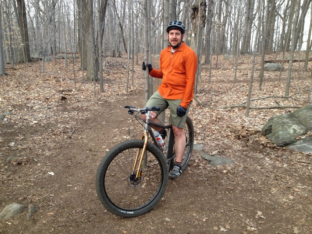

    I'm not sure what to call this beast, but it is awesome! I took my first ride last weekend and had a blast. This is more of a proof of concept for me, not a permanent setup. I had done some 'cold working' of the stays on this frame a few years back, and it just barely works with this setup. Sliders are all the way back. Here is the list for the gear freaks:
    Frame: Carver titanium 29er with sliders
    Fork: Niner steel (clears the tire just fine)
    Wheels: Hope hubs (singlespeed rear) and Jeff Jones 50mm rims, built by MC. His comment was they are 'super burly'. Not the lightest, but that's not the point.
    Tires: 120tpi 29x3 Knards
    Brakes: Old Hope Mono Mini
    Cranks: Truvativ AKA with spiderless HBC 28t Ti ring
    Cassette: 6 speed, 12-33 titanium, 8 speed spacing
    Rear der.: Shimano XTR M960
    Seatpost: Old style Moots layback titanium
    Saddle: WTB Silverado ti railed
    Stem: Thomson
    Bar: Groovy ti Luv Handle
    Grips: Ergon something with short barends
    Shifter: Old Shimano XT 8 speed rapidfire
    The first ride was just super fun. I started the tires at 15 psi, and stopped twice to lower the pressure. I forgot to recheck at the end of the ride, but my guess is I am around 12 back and 10 front. This was my first MTB ride in many months, so my legs were a bit dead, but I still cleared some climbs that I only sometimes make on other bikes. The grip is just incredible! You basically just don't have to think about traction, just pick your line and pedal! It certainly takes more muscle and a different riding style than my 22 lb singlespeed, but it's just a blast. My head is already creating a custom Carver Ti 420 with proper clearance and geometry! Anyway, enjoy the pictures:

    Really a neat bike! Do the sliders need to be all the way back to accomodate the tire? The knards should raise the bb to about 13.4" ? What geo changes would you make?
    Reputation: bikeny's Avatar
    3,665
    Quote Originally Posted by Vincentg View Post
    Yes, the sliders need to be slammed all the way back. Even then, I get an chainstay rub every once in a while while cornering hard. Honestly, I have no idea what the BB height is, but it doesn't feel really high. Geometry changes I would make? First would be to get the chainstays as short as possible. Not sure how short can be done. A little more standover would be nice. It hasn't been an issue, but it could be ! Lastly, slacker angles. I've come to appreciate slack geometry so would like something around 69 deg headtube angle. I think that's it.

    Do you know the chainstay lengths with the sliders all the way in/out?
    Looking at picking one of these up locally.
    Also.. What sort of cold-working had you done? Dimple the stays?
    3,665
    Quote Originally Posted by Jstews View Post
    OK, measured the frame last night. With the sliders all the way back, where they are now, the CS measures about 18.25", and they have about 0.75" adjustment, so shortest would be about 17.5". And yes, I basically dimpled the seat and chainstays to add some clearance. It toke some effort to bent the Ti tubing! Basically, I used some wood on the outside of the stays, a steel bar on the inside to make a dimple, and a big vice to squeeze!
