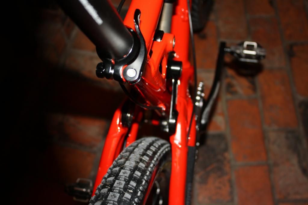

    So i sold my F/S 29er and got this....
    They are really that good.....feels exactly like an in between wheel.
    Size medium Nickel 5inch travel from S/C for $600.00 on thier website.
    Fork..xfusion velvet 26/650b fork 140mm
    Wheels.. Stans flow ex 650b with 3.30 hubs
    Tires...Maxxis Ardent 27.5x2.25 front
    Crossmark 27.5x2.10 rear
    Bars...truvativ t30 flat 700mm
    Stem...fsa 80mm
    Cranks... X9 with north shore billett 104/64 bcd 2x10
    Chainrings...22t 36t
    Brakes...magura louise bat 180mm f 160mm rear
    Front/rear derailure...sram x9
    Shifters...sram x9
    cassette...pg1070 11-36
    tons of room in the rear with shock bottomed out
    weighs 28lbs flat

    Looks sharp! Any clearance problems? Hows it ride compared to the 29?

    What modifications were necessary to make it a 650B? Did you have to change the shock or add anything special? I'm considering buying one of those frames and doing the same thing. How do you like the ride of that bike?

    Nope. Nickels fit 650b rear with no mods whatsoever. The frames are on closeout for 600.00 new.
    No clearance problems at all. With the shock bottomed there was a ton of room left. I have heard the reaaly big 650 tires leave just a few mm's clearance.
    ir rides fantastic. really....the travel feels bottomless.

    It weighs 28lbs flat on the nose. I went with flows but with crests and rocket rons youd drop almost 2lbs.and almost another pound if you went 1x10 or new xx1
    I had a felt hardtail, a performance acsess a khs flagstaff and was on an epic for a bit.
    ridden ALOT of 29ers and i can for sure say FOR ME i prefer the 27.5. it just feels right, VERY flickable,still have great rollover and it picks the front very easy.

    I am 5 9 178lbs. in average mtbr shape (meaning i have a family and ride once or twice a week) it's actually a little heavier than my 29er i sold but it was 1x10 with crest wheels and racing ralphs.
    I could have gotten a crest wheelset but i decided to get the flows because i figured they would handle rocks and roots better. i always felt there was a bit of flex in the 29er crests.
    Im not a jumper but im also not a 145lb xc racer

    What is your BB height? I'm considering building one of these, but am worried the BB may be a bit high, so I'm also considering a Blur XC.

    The BB height is 13 3/4 to center of bb.
    On the nickel i feel kinda just right. Not really in it or on top of it.On myb last 29er i felt on top of it...
    And if i ever go back to florida im making it a 1x10 with rocket ron tires.
    That will drop almost 2 lbs
    The nickel frame weighed just under 7lbs so it was on the heavy side.
