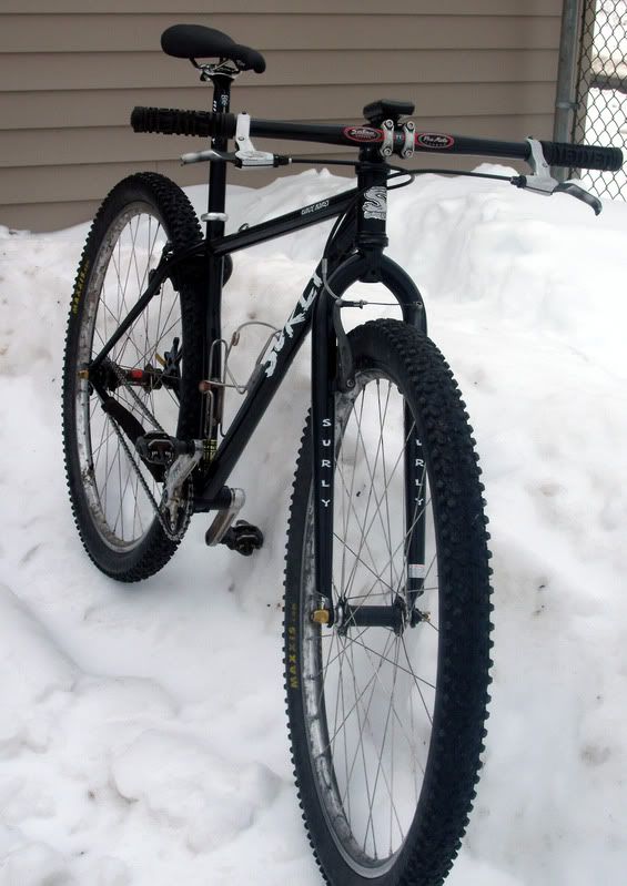

    Here's the carbon bar in 25.4 with 11 degrees of sweep.
    I had the alloy version and swapped to the carbon after building a stiffer front wheel and needing a little extra damping.
    It worked.
