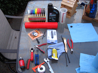

    Tools necessary ( most of them anyway) , easy stuff, nothing abnormal other than some c-clip style pliers
    C-clip pliers needed to hold the remote lockout top still while unscrewing it.
