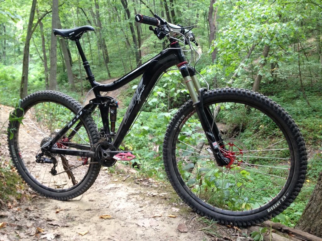

    Digging this thread back up for an update...
    First, thanks to all of you for your input on the Lenz v Turner questions. Much of your info helped me in making my decision.
    Ultimately what I was after was 1) stiff rear end w/short CS. 150x12 & <17.5". 2) slack HA at <68 degrees. 3) impeccable build quality / years of reliable service.
    The Lenz met each of these criteria. The Sultan missed points 1 & 2, and with Mikesee's review, I had a difficult time putting the Sultan above the Lenz due to the deficiencies he pointed out.
    So, after much debate through this forum, emails, and phone calls I pulled the trigger way back in March for the Lenz Sport Behemoth. I spec'd for a 150x12 rear end, of course, tapered HT, and gloss black finish. Communication, albeit a bit slow at times, was great throughout the whole process. When we were nearing the delivery date, Devin emailed me requesting I give him a call to work out some minor details. This conversation enlightened me into how deeply involved Devin is with each build and how much he cares about the end user's enjoyment with his frame.
    Because of my requested spec, Devin built me a Lunchbox but instead of the usual 6" rockers, he slapped on a set of the 5"s. I was actually happy he did it this way because throughout the 4 months of gathering components for the build and reading, researching, and debating, I began second guessing my decision to get the 'Moth over the 'Box. Why did I limit myself, is the question I kept asking...so when Devin revealed what he decided to do I was ecstatic. If I want a full-on 6" travel Lunchbox I just need to make a simple phone call and *bam* I've got it. Of course, I would then need to get a bigger fork.
    TL;DR: So, without further ado...here's my build spec ---
    FRAME - Lenz Sport Lunchbox w/5" rockers, size L
    FORK - RS Revelation RCT3 140 20mm TA
    SHOCK - FOX Float CTD w/Boost Valve
    HEADSET - Cane Creek 110
    CRANK - Race Face SixC 24/26 w/bash, 175mm arms
    FR DER - Sram XO direct mount
    RR DER - Sram XO medium cage
    SHIFTERS - Sram XO
    B/BRACKET - Chris King
    CASSETTE - Sram 11/36
    BRAKES - Hope Tech M4 203f/183r
    POST - RS Reverb
    SABBLE - WTB Rocket V
    BAR - Spank Spike 777 EVO
    STEM - Easton Haven 55mm
    PEDALS - Spank Spike
    WHEELSET - Hope Hubs laced w/DT Swiss spokes to Salsa Gordo hoops wrapped with WTB Dissents, built by no one other than Mikesee
    obligatory crappy iPhone pic:
    ---> ya, I know...the front brake hose is twisted up...I'm gonna fix it ;-) <---
    The total build comes in around.....actually, who gives a s##t what it weighs, I know I don't. It's big. It's heavy(ish). And, it *rails*.
    Does it climb as quickly and as snappy as my Niner MCR on my local XC trails? Absolutely not, and I never expected it to.
    Once I got the rear end dialed, small bumps completely disappear and the biggest hits on the trail (2' drops to smooth transitions - I know, not big at all but it's all I've got locally) feel very smooth and controlled. Descending this bike makes me happier than any other bike I've ever been on. Slam the post, get down and *in* the bike, and the 'Box just rails. I'm holding lines through off-camber corners that have made me pucker for years.
    I built this bike not for my local XC trails but for my frequent out-of-town all day epics and for my annual week-long MTB destination trip. This year is Moab/Fruita/GJ. It'll be my third time out to that part of the country and I'm feeling pretty dang good about my bike's capabilities for that type of riding.
    Thanks again everyone for your input and debate on this topic. I appreciate the MTBR community.

    Beautiful bike. I've never been a huge fan of the Lenz aesthetics (although I love literally everything else about them that I've seen), but the black really helps it.
    One question: what is the story on the rear travel? They list it as six inches on the website, but yours is obviously five. How interconvertible are the two and what are the other geo differences? Why'd you go with 5"?

    Thanks for the compliments guys! It's nice when you finally get a bike together that you've been lusting over, gathering parts for, and working on for so long and see it all come together just as good as you planned.
    Speaking to the decision on the 5" of travel....
    Originally, I ordered a Behemoth with a 150mm rear end. My decision to go 150 was two-fold - 1) coming from the Ellsworth's noodly feel, I was after a much stiffer rear end for better tracking through the terrain I'll be riding this bike on and allowing me to take the rougher lines, cuz they're much more fun. 2) working with Mikesee, he basically said that going w/ a 150mm hub allowed him to build a stronger and lighter wheel than if we did a 135 or 142 rear end.
    Looking at the geo specs on Lenz's website, the 'Box and 'Moth are virtually the same except the rear spacing...it's the fork that changes the game --- the 'Box has a slacker HA with a 150mm fork (67.5), a higher BB (14.4), and a longer wheelbase due to the rake of the front end. So, when Devin began building my 'Moth w/150mm rear, he decided to build a 'Box with 5" rockers, giving me the travel I was looking for but allowing me to increase it down the road if I so desired.
    So, the decision to go with a 'Box at 5" really wasn't made by me, although I'm very happy with the result!
    As far as the chainline.....
    Initially, I had some issues using the stock spacer setup with the RF cranks, but that was due to my own mistakes. Once I went back through the installation instructions and installed the spacers according to the listed "stock" position (50mm) all was well. I'm not sure if you're asking me spindle length or diameter, and I don't know either off the top of my head, but I can tell you that the BB shell is 73mm and I'm using a Chris King external bottom bracket for non-stepped spindles. Basically standard stuff. And since I'm running 2x up front, I've been staying in the 36t ring for my rides. It's been tough pushing this beast up the hills (my riding buddies on carbon 29er hard tails are on my a$$ but I pull away on the descents!) but I can feel myself getting stronger as well as adapting my riding style by carrying more momentum on the descents, pumping the terrain, and using less brake through the corners.
    On the hubs...
    I gave Kings serious consideration. I love their products and I love what their company is all about. However, I've got a ton of miles on Hope hubs (this is my 3rd wheelset w/Hopes) and they've been indestructable. I've had to replace the bearings so I've got all the Hope tools so I can fully service them myself. I just couldn't justify the ~$200 price increase for the Kings when the Hopes do the job and do it damn well. And, I'm partial to the loud-a$$ free hub ;-)
    One thing I will add...
    I friggin *HATE* front derailleurs. The Lenz frame has a braze-on for a direct mount FD. I figured setup would be a breeze, however it's been nothing but. Right now, I'm struggling with the proper chain tension because when I'm in the 36t ring and the bottom 1/3rd of the cassette, the chain rubs slightly and annoys the hell out of me. Basically, any noise my bike makes on the trail completely destroys my mental focus and I cannot ride. So I've gotta get this sorted out rather quickly.
    That small issue aside, I'm absolutely loving this bike!

    Beautiful Mothbox. Tell me how you are liking that chain tensioner. I have seen it before but I forget who makes it. As I continue to dial in my Moth, next up is a device to reduce chainslap. Looks like you have just the thing there.

    Beauty - glad Devin got you sorted properly! Slap a coil shock on that baby and really open her up.

    That's a nice Mothbox! I have an old school Moth that has been rebuilt and powder coated flat black. I too experience chain rub on the front derailuer and I have a 22/36 Saint crankset up front and a 11-34 9 speed rear cassette. I do find it annoying but as you have stated it only rubs when I'm in the 36 front ring and the last 3 rings in the rear, but I am rarely in those gears so the nuesince is not very often. My moth frame is not fitted with a direct mount front derailuer and the bash ring on the Saint will not allow me to mount the derailuer any lower. When trying to fix said chain rub I noticed a lower mounting point might fix the issue. On another note my Moth has a 135mm rear triangle so I would figure that having a 150mm rear is not the cause (but I could be wrong).
    Also as another has said swap that air shock to a pushed VanR with spring and let your Moth fly. It definately gives you some serious point and shoot DH confidence. I have launched up to 4' to flat (tagging rear first or flat landing) drops with nothing but a smile!!
    Enjoy your Mothbox and keep us updated on any changes!
    Thanks!!
    I first saw the chain guide on Lenz's facebook page. Nick posted a picture of it on his 'Moth talking about it being the best option for a 2x setup on the Moth/Box's cuz of the ultra short chainstays.
    It's made by Bionicon ---> Accessoires
    I'm pretty sure I need to remove another couple of links in my chain and do some fiddling with the front der. Hoping I can get rid of the chain rub.

    When I had a 20-30-bash set up I got horrible FD rub in the 20t chainring...but only when the suspension was uncompressed. THis translated to a minor annoyance on the trail. Nowhere near the annoyance of the chainsuck I was experiencing. I decreased the irk-factor of both problems by switching to a new 22-32-bash crankset. Are you gentlemen getting rub on the sides of the FD guide or the bottom?
    BTW, thanks for the bionicon hotlink bro. Does it perform well? Does it quiet chainslap in your case?

    Chainslap hasn't been completely eliminated but it's not nearly as annoying as it would be without it. I would say, so far the Bionicon guide is working as advertised.
    I was able to stop the chain from rubbing on the FD by adjusting the limit screws. However, I have yet to solve the chain suck issue.
    When in the big ring up front and any of the smallest 3 cogs out back, if I drop to the small ring and apply a small amount of torque on the crank, the chain jams between the backside of the big ring and the chain stay, basically right where it transfers over to the small ring. I tried moving the chain guide closer to the rings as well as removing 2 links from the chain. Neither cured the problem. In fact, I had to put the 2 links back in the chain as it was too short when in big/big combo w/suspension compressed.
    This chain suck thing has me baffled. Wondering if an additional spacer, either on the BB cup (there's one there currently) or moving around the spindle spacers on the crankset would do it.
    Anybody have any thoughts?
    The chainsuck thing has me cursing at trailside, typically. Putting a new crankset and rings on the Moth helped a bit. I have read about some DIY chainstay mounted deflector machinations. I may have to go there. For now, the new chainrings and better technique/timing with shifts is making things better. As I look at the Bionicon, I am wondering if it has the potential to make chainsuck matters worse but decreasing the angle of take-off between the chain and the bottom teeth of the larger chainring. I think for now I'll try padding the chain stay with tubes and velcro as described above.
