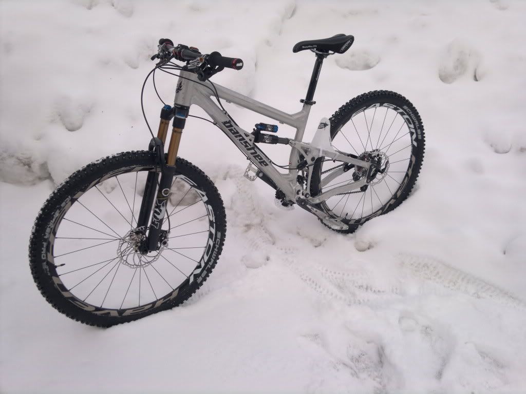

    It's been a long wait, but I can most re-assuredly say that it was well worth the wait
    Received it Thursday afternoon and had it all built up by evening and test rode it around the neighborhood, it felt very nice, very familiar to be honest, despite having a wheelbase 3"> greater than my Paradox. It came set in the "slack" setting and that's what IO first tooled around in, but then I decided I'd prefer the "steep" setting and have been ridng it like that since.
    BB height is over 1.5" higher, chainstays measure 17.6",so longer than the Paradox and despite that and the much longer wheelbase it's as nimble as the Paradox, actually feels a bit more responsive to be honest and that's with the exact same 80mm stem and 750mm wide bars. Have thrown on a 60mm a friend had to just give that a go, but I think it's a bit short, but need to get a proper ride in to test it, thinking a 70mm will be perfect.
    Put these pics and quick thoughts up so I'll have somewhere to come back and update and so you can see just how sweet the Prime really is. So you all know, I'm 6'2.25", 35.25" inseam and this is an XL frame. The thing has a $hit load of clearance, enough so that a friend who's only 5'8" had no issues straddling it.

    did you weigh the frame?

    Frame size?

    He's our height. The OP's Prime is XL.

    Would be interested to hear how much it weighs. I often wish I needed that much bike just so I could get one. It's a beautiful machine.

    Right now there are 2 options, 135 standard drop-outs and 150mm bolt on, think the production will have 3 options.

    Yes, you're seeing right, 2x upfront, 6 outback, no FD because this frame takes the SRAM S3, low mount, bottom pull FD and there wasn't one in stock when I was ordering the additional parts I would need - I don't have XO/XX money, although I did find a deal on a n XO I'll prob get. Not a real PITA, just need to stop and throw the chain up or down, or grind/spin it out if you don't want to stop.

    Currently - in prototype form - the XL frame is 9lbs 10 oz with shock, I've heard the med's are a sliver over 9 lbs. For production they will run around 700g lighter.

    Why not put a Widgit on there for a nice 1 x drivetrain and be done with it? Probably close to being about the same cost as the special FD needed.

    For production there will be increased front derailleur clearance and compatibility with more options... working on it now infact!

    Yeah Bruce, not sure exactly if you've tried an abbreviated cassette or not, but with the smallest cog being a 16t going 1X isn't very feasible, so I'll be sticking to a 2X setup. Just swapped out the 38t for a 36T I recently got as I don't have the FD and instead of stopping and changing rings manually I'm trying to pedal the big 38t and I can feel it after the weekend, so the 2t drop should help with that a little.
    FYI if anyone's interested, weighed it today and got 33lbs 5oz as is.
    Also, when a manufacturer tells me there's clearance for a 2.5" tyre, the pics below are what I'm expecting. Way to go Banshee on delivering enough clearance to run a 2.4" tyre like the Ardent and still ride it in the mud and muck without it packing everything up.

    Yeah, I was in-line for one since I found out they were going to be made, been a long 1.5+ years, but oh so worth it Have to agree with you on the looks, not sure exactly why, as Banshee have some nice frames, but the Prime just looks so, so right.

    Hey Dude, missed your comment. It sure looks good, but even better it rides as good as it looks Wishing I could take a trip up there and give it a good test on some of those sweet trails.

    Quote Originally Posted by sakucee View Post
    Too much green and sunshine.
    Now with Fox, XTR and Easton.
    What's that flap you're using?
    Mar 2011
    389
    Quote Originally Posted by scvkurt03 View Post
    Mucky Nutz
    beater
    Reputation: evasive's Avatar
    Feb 2005
    5,225
    Work well for you? It looks pretty similar to a MarshGuard, which I was considering buying (since they're cheap). I haven't gotten around to making my own yet, like FM did.
    Mar 2011
    389
    Yup, works great, 11km ride on melted snow/slush/water today and no spray on face, top speed according to GPS 37kmh, of course it wont stop stuff flying up past the downtube, but hey, 10 euro product that weighs what, 20grams and it keeps a lot of the crap off from fork crown!
