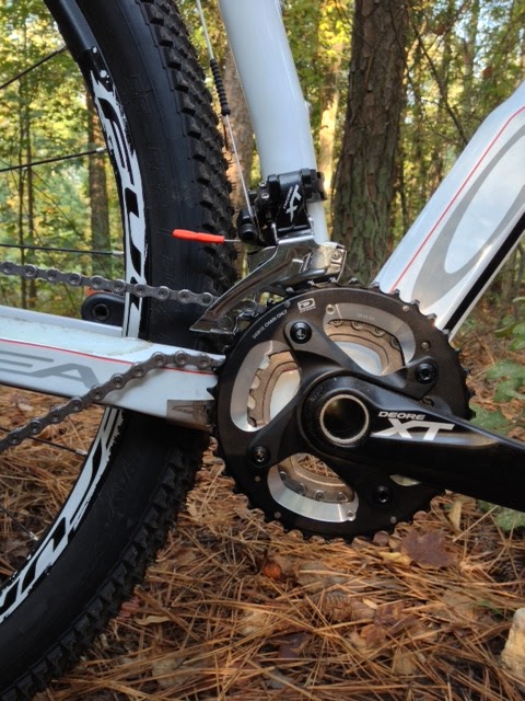

    dealing with chain suck and preventing it
    I got chain suck on my first ride. Pretty upset, I took my bike apart and vowed to not ride till I could hopefully fix the issue.
    Things I did:
    1. ICS Helicopter tape, custom shapes cut for the bottom bracket area.
    2. KEdge clamp on chain catcher, not exactly for chain suck, but chain drop is just as bad.
    3. XTR shadow plus rear derailleir, wow, this thing rocks, no trail chatter.
    4. Check chain length, shorten chain by 5 links. This had to be the main problem. No matter who built your bike, its best to check these things. I did the shimano big/big plus 2 links method and found the chain appeared to never of been shortened, just "slapped" on.
    Chain Suck on the trail. had to basically pull the chain outta there, almost thought I'd have to take it home and uninstall the crank just to get it out.
    Damage inspection: Only paint was taken off.
    Quick touch up and custom ICS helicopter tape shape
    KEdge
    XTR Shadow Plus! This is incredible, I took off the XT derailleur and was able to compare the two (same model year), amazing how much more attention to detail the XTR had.

    CHAIN: Even with a properly sized chain, xtr shadow (clutch), I still have gotten chain suck. WHY? Because my chain (SLX) was really dirty, and I've since gotten a lot better about wiping it down and running it through the chain cleaner more often. Basic stuff here, clean lubed bikes work better. Its not anything uncommon (since properly tuning) and would highly recommend the shadow derailleur on any bike.
    EXTRAS: I went ahead and bought some extra chain stay protectors, around the BB area, along with an extra derailleur hanger, just in case.
    D.Hanger: I noticed that the small pan head allen screw holding the d hanger in was not in very straight. I used the new hanger's screw to replace it and it went in straight. FYI. Design wise, I dont like how the D. Hanger is in the frame, its not secure only having one screw (acts as a pivot point), I get it though, the rear skewer holds the whole assembly down, but wheel out the hanger will move (pivot) it you touch it.
    C.S.Protector: This was not originally stuck on my frame very well. It was ripped off on chain suck incident #1. I put it back on (the sticker side was a little dirty too) and secured it with zip ties thinking that's what would hold it on. But what happened was that the zip ties REALLY got the glue, sticker to bond to the frame. I can pull on it now and it doesn't budge.
    EXTRA PROTECTION: I did a few more areas with the helicopter tape I purchased from Amazon. I cut out custom shapes so that the tape would fit to the frame around the BB area. Kinda over kill, but its piece of mind for me.
    KEDGE: I bought this after getting chain suck thinking chain drop was a possibility. Shifting is either never perfect or always changing and I managed drop chain once, having the kedge now ive heard it hit the kedge, but the kedge did its thing keeping it on the small ring.
