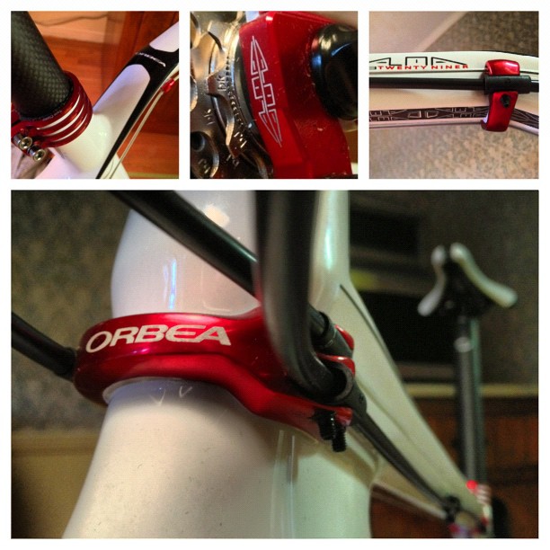

    Pics:
    http://2.bp.blogspot.com/-h83vO4cwZD...s1600/open.jpg
    http://4.bp.blogspot.com/-Fmmpgw675G...00/whiskey.jpg
    http://1.bp.blogspot.com/-7WcLSl3vpq...0/details3.jpg
    http://1.bp.blogspot.com/-8Kk-tZSp96...0/details2.jpg
    http://4.bp.blogspot.com/-26sWiZiKaF...00/details.jpg
