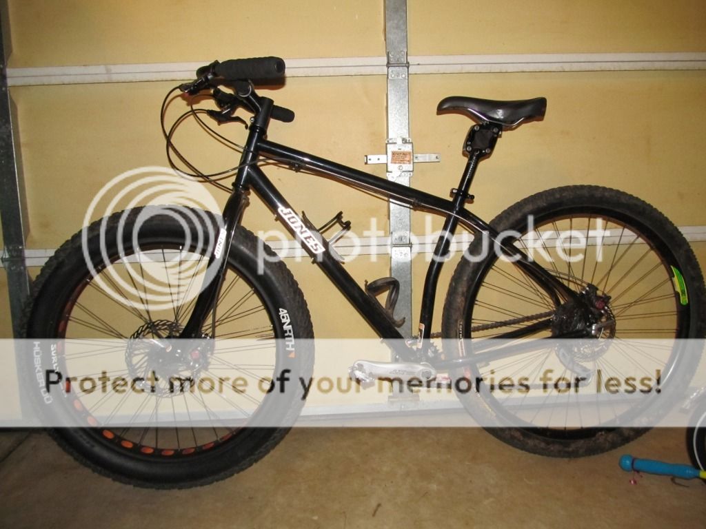

    the Jones as set up for the epic ride:
    <a href="http://www.flickr.com/photos/davidandmelinda/6853517237/" title="Fat by Melinda and David, on Flickr"><img src="http://farm8.staticflickr.com/7182/6853517237_a2580ff18f_b.jpg" width="1024" height="768" alt="Fat"></a>

    Fat front Jones really is the way to go. I originally bought my Jones Diamond frame and Unicrown fork from Jeff with a 29er wheelset. He advised me to try it out with the 29er wheels to make sure the geo was a good fit for me, but also said that once I tried the fat front I wouldn't want to put the 29er front wheel back on. He was mostly right.
    My front wheel is a Paul WHUB laced to a Surly Large Marge Lite rim with a Husker Du tire. It is a really awesome setup - pretty light, wide enough, great grip, etc. I run the fat wheel 90% of the time. the only times that I run the 29er front are either for bikepacking or on a select few trails that are really buffed smooth. Otherwise, if the trail has roots and rocks, I'm going fat.
    I know, I know...pics or it didn't happen, so here it is...
