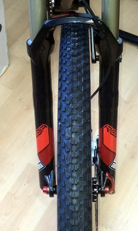

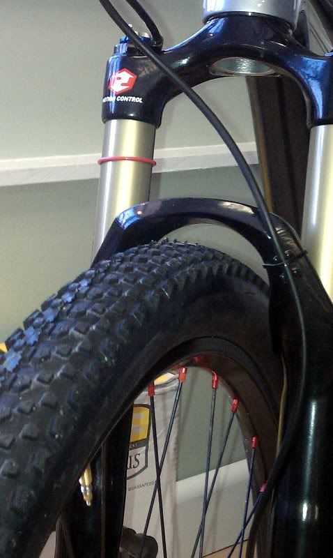

    Running a Crossmark UST (or LUST as Maxxis calls them) on the rear of my RIP 9 since June of last year. I have two of the Crossmarks and they both weigh around 840g. You can read the thread here.
    <a href="http://www.flickr.com/photos/7166535@N05/4954319886/" title="Crossmark UST by singingsingletracker, on Flickr"><img src="http://farm5.static.flickr.com/4124/4954319886_97362e8e18.jpg" width="500" height="375" alt="Crossmark UST" /></a>
    <a href="http://www.flickr.com/photos/7166535@N05/4744397579/" title="Muddy RIP by singingsingletracker, on Flickr"><img src="http://farm5.static.flickr.com/4138/4744397579_502688706a.jpg" width="500" height="375" alt="Muddy RIP" /></a>
    I've been running them on Flows with yellow tape and valves only, but that is about to change as the Crossmark is losing air now on the rear of my RIP. Time to add sealant, but I wanted to see how long I could go on them without using sealant. I made it from June to January sealant free, but I must have run over something in the past month - or the cold winter weather is enough to make me lose air every 48 hours.
    Good, solid tough tires.

    Update: In spite of the winter storm and very cold temperatures, I decided to see what was causing the leak this week in my rear Flow/Crossmark LUST. Turns out, it was the valve after all. Since I have not been using any sealant, it was easy to pop the bead, remove the valve, dip the valve in sealant, reinstall, tighten down the locknut and air up. Leak gone. Tire has held air all week and I've been riding on it every morning in the snow. This was good news to me because I didn't want to have to patch the tire in the middle of winter. So my previous durability assessment of the Maxxis LUST Ardent and Crossmark stands. My leak was the valve's fault.
    So my Maxxis UST tires (or LUST) continue on sealant free (outside of the dipped rear valve) since June of last year.
