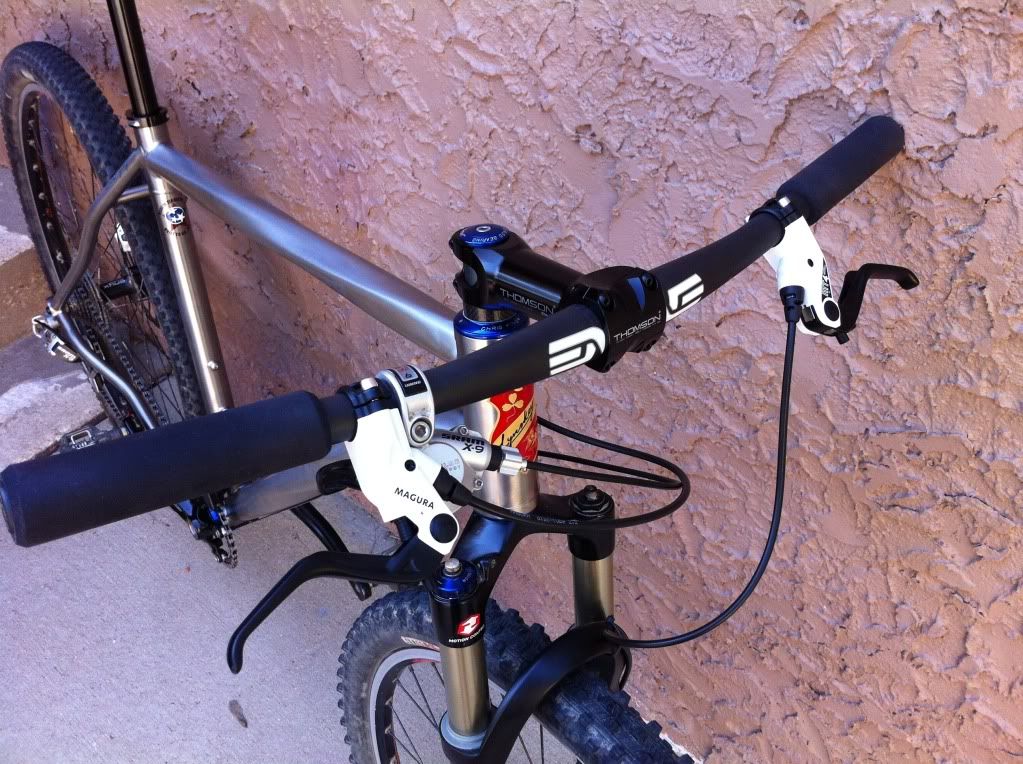

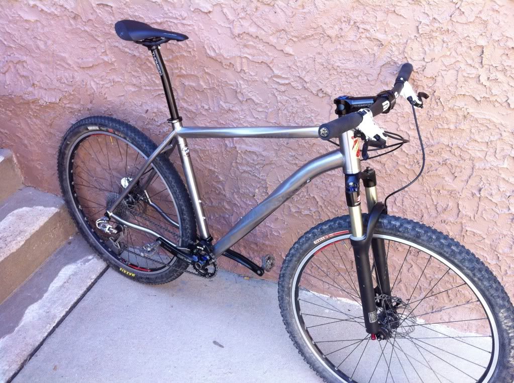

    Good job! Lynskey Pro29 Build
    Frame - 2012 Lynskey Pro29, Industrial Mill w/ Etched Graphics, Size XL
    Fork - 2007 Reba Race 80mm
    Headset - Chris King Inset 1-1/8" Blue
    Brakes F/R - Magura MT-4
    Rotors F/R - Magura Storm SL
    Wheelset - DT Swiss Onyx Hubs w/ DT Swiss 3.1 Rims
    Tire F - Bontrager ACX 29 x 2.2
    Tire R - Maxxis Ikon EXO 29 x 2.2
    Tubes - Bontrager Boat Anchor (standard tubes..)
    Handlebar - ENVE Sweep (cut to 620 mm)
    Stem - Thompson X4 Mtn 110 mm x 0 deg
    Seatpost - Thompson Elite Setback 27.2 x 410 mm
    Saddle - Fizik Antares Braided Carbon
    BB - Chris King GXP Blue
    Cranks - Truvativ Stylo converted to 1 ring
    F Ring - Blackspire Mono 32T
    Chainguide - MRP 1X seatpost mount
    Cassette - SRAM 11-34T
    R Der - SRAM X-9
    R Shifter - SRAM X-9, 9 sp
    Chain - SRAM
    Grips - ESI Chunky
    Pedals - Crank Bros Candy SL (older)
    Went with Magura brakes after having good luck with my Martas I had previously. Aside from the hoses being cut down (had a shop do this), install and setup was pretty simple. They don't have a ton of power yet but the pads obviously are not broken in. I will report back after a few rides.
    Coming from an aluminum (Orbea Lanza) 29er, I was impressed how much more muted/comfortable the ride was while being about equal in terms of stiffness out of the saddle. The oversized 2" downtube and 73mm BB shell are a real benefit for this.
    I want to change a few things.. going tubeless, new pedals, etc. but was too anxious to get together to ride right away.
    Thanks for looking, i'll try to post a couple more pics soon..

    Couple more pics..
