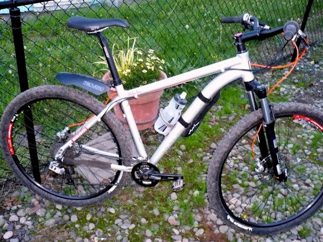

• 04-13-2010
    CommuterBoy
    Let's see your Performance Access XCL 9r Build!
    I got sick of searching for pictures when I was building mine... so lets put them in one place, shall we? ... inspirational pics for those who are building one up. Plus, I want to see yours so I can steal your ideas.
    Here's mine, it's the 21" frame:

    Finished my build 'bout a month ago and put 'bout 100 miles on her since. This bike has transformed me into a full fledged 29er rider...my 26" bike hasn't left the garage since. I'm in the process of going tubeless with ZTR Flow's...will post pic's soon...
    " width="549">
