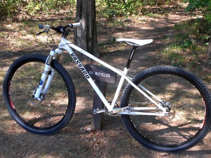

    ss29er
    Here's one that didn't used to be black
    Now it is after I added a little crotch clearance by moving the cable guides for a smaller rider.

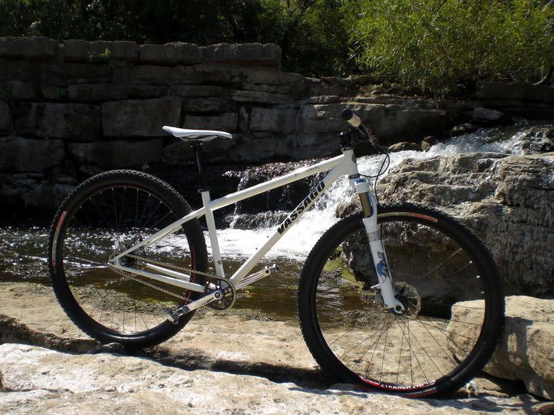

    mattKHS
    My Vassago, at 11,500 feet on the Colorado trail.
    Custom powdercoat paint. Its a metallic cool charcoal.
    Reba SL, wtb speed disc wheels, xt / xtr 1x9 set up. Probably not the lightest. I think I am around 28lbs with the nevgal tires.
    Stans wheels and hope hubs coming in the next few months. Once I sell my 26ers off.

    P'sanbiker
    Not yet built up, but so far so good.

    justanotherbikegeek
    Blackerwocky
    Here's mine. Not the greatest photos, but I'm posting this primarily for anyone who's on the fence about an 18" vs. 16" frame. I'm 5'9" on a good day (and in riding shoes). I was a bit confused by the sizing of these frames and had to make a decision without being able to try them out for size.
    I chose the 18" frame because I like a stretched out riding position, didn't want to run a long stem, and didn't want a super long seatpost sticking out of the seat tube. You can see from the photo that the amount of seatpost showing looks about "normal." The stem is a 110mm. The bike fits really well and feels great.
    I'm using an XT quick release on the rear wheel and have had no problems with it staying tight. Taking the rear wheel off is a little bit of a hassle because I have to dial out the tensioning screws to get the wheel off, then fiddle with them again to get the wheel back in place.
    Someone posted a closeup shot of an ODIS fork leg with a cable holder thingie on it. Is that an aftermarket stick-on cable holder? If it's some sort of stick-on thing, I'd like to get one. My fork is getting a lot of cable rub from the cable being zip tied on there.
    I bought the frame and fork used from Addictive Cycles and they were great to deal with.
    I don't have an accurate weight, but using the bathroom scale it comes in around 26 pounds.
    Deda Newton stem
    Easton EA70 bar
    Giant short bar ends
    Oury grips
    Sinz headset
    Thomson Elite setback post
    Salsa seatclamp
    Fizik Gobi saddle
    Stronglight 32t singlespeed crank
    Stronglight bottom bracket
    Speedplay pedals
    DT 7.1 (or something...can't remember) rims
    American Classic singlespeed hubs
    Avid BB7
    old SRAM levers
    King aluminum 17t cog
    Exiwolf in front, Nanoraptor in rear
