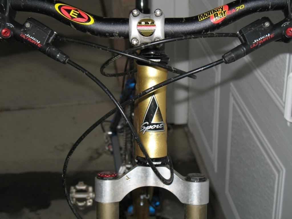

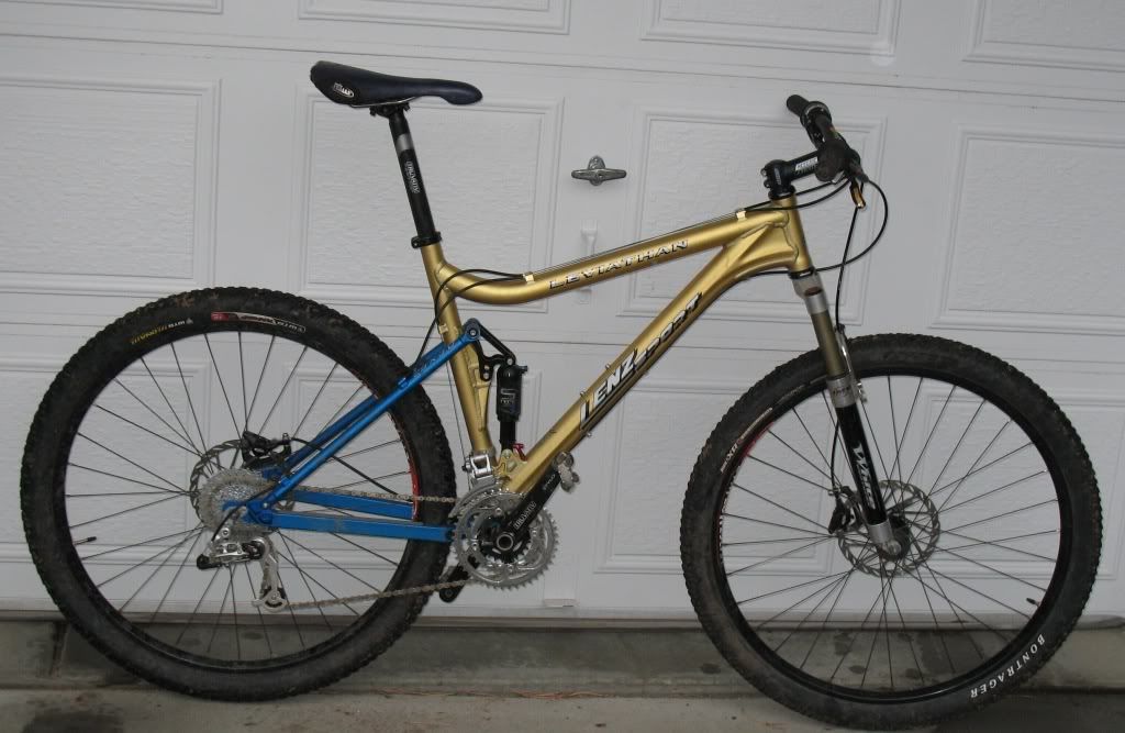

    Here are a few shots of the Lenz XL demo bike. The build quality is excellent, and the frame just oozes attention to detail. I do think the graphics and logos are a bit cheesy looking; something a little more subtle would help the bike display its “gravitas” on the trails. Not a big deal because you can’t see the stickers that much when the bike’s wearing its natural protective layer of dirt and mud. [Note that these shots were taken AFTER the Lev got a post-ride cleaning… I was afraid that internet pictures of the bike with a full cocoon of mud would disqualify me from future test rides courtesy of Lenz Sport. ]

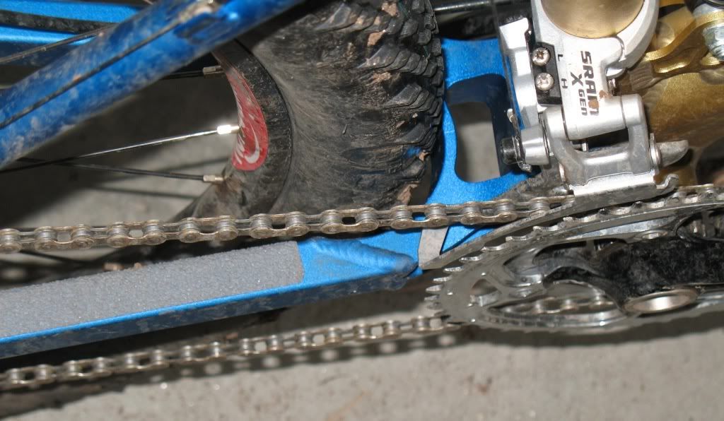

    The Lenz could use more mud clearance. It’s pretty tight around the rear tire (see photo below). The conditions today were about the muddiest I’m likely to ride in, and at a few points I had to stop to clear the glop out of the swing-arm. If you ride frequently in wet conditions that transform dirt into lovely clay gumbo, you might want to take note.

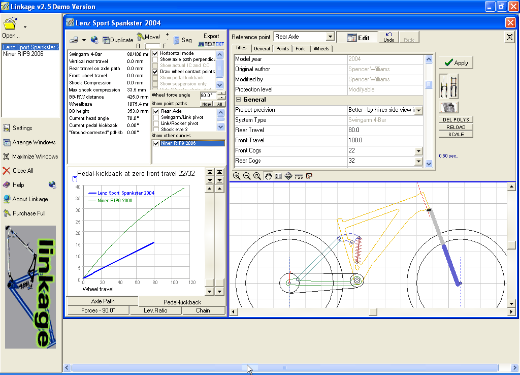

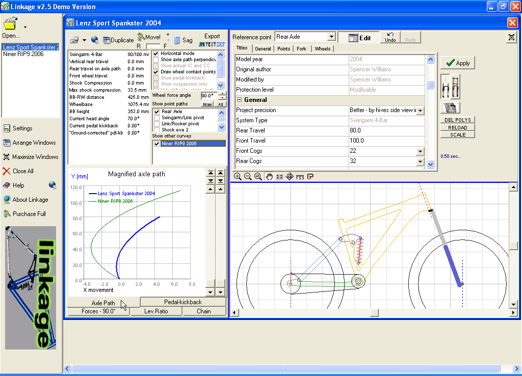

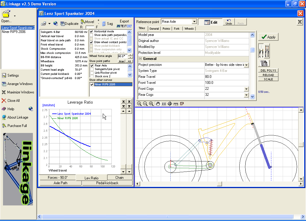

    I’ve been playing around a bit with the Linkage demo suspension simulation software (you can download it at http://www.bikechecker.com/). Unfortunately, the Lenz Leviathan isn’t in the web library, but the Lenz Spankster is, and appears to have similar travel and suspension design.
    Here’s a comparison of the Niner vs. Lenz suspension leverage ratio (Niner is the green line)
    Here’s a comparison of the pedal kickback. Even though the graph would indicate that the Niner has more pedal kickback when the suspension is compressed, I couldn’t notice it on either bike.
    And finally, here’s the plot of rear axle path through the suspension’s travel.
    What does this all mean? Who knows, they both feel pretty good on the trail.

    I don't think the suspension softwareis acurate if it doesn't take into account the siez of the whells. Does it ?
    No, it's not. I don't think the Lenz frames in the 'web library' available to the freeware version of Linkage are accurate, and they aren't 29ers anyway. At some point, maybe somebody with a personal version can upload a Lev 3.0 or 4.0 so it's a more valid comparison to the RIP9.
