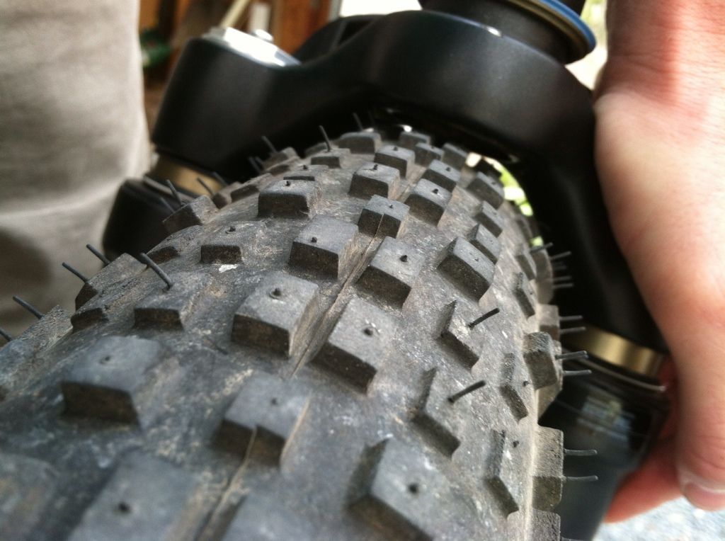

    92
    I have never really bottomed a fork out that far. heres a few pics. with blunt 35s not rabbit hole tires.
    Attached Thumbnails Attached Thumbnails Krampus with Front Suspension!-p1060723.jpg

    Haven't bumped it up to 120mm yet, but likely this summer. I'll post up when I do, likely a week or two.
    Here are a few pics of the crown/tire.
    Fork is a Float 29 RL, not a FIT fork. Not sure of the year though...I've ridden it quite hard with the Knard/Rabbit Hole combo on my Krampus, no contact between tire and crown at all. Quite a nice addition to the ride quality!

    Quote Originally Posted by mikesee View Post
    Facetious?
    There's very little difference.
    I'm not joking Mike. Maybe its just the pic you posted but it looks like you have huge clearance compared to other Fox/Knard fits I've seen.
    This is a 2013 Fox 32. Knard is on a Blunt 35 at ~20psi. Plenty.
    Mike have you taken physical measurements of this setup?? ie 95mm, 97mm etc??

    Quote Originally Posted by fleanutz View Post
    Just beware...
    Take all the air out of the fork and watch the crown hit the tire.
    Just my attempt at a PSA, be mindful of the catastrophic possibilities.
    That being said, I'll still ride it. Just with a touch more air pressure than normal. At least until I feel confident enough that I won't lose my teeth. Another guy around here actually bottomed the crown out on the tire while riding; lots of noise but no immediate stop or damage.
    My $0.02.
    I was using a Float 32 (26") on my 650B bike. Like your picture above, if you bottomed the fork it would hit the crown. I put a couple of the bigger zip ties around each stanchion to keep it from bottoming and never had a problem in nearly two years riding. Alternatively you could open up the fork & put something inside to limit travel 10mm or so.
