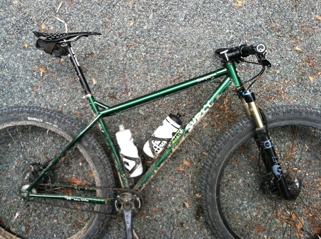

    I put a 130mm Fox Float on my Krampus. It's significantly slacker with the suspension fork on it. It rides great. No issues at all.
    A2C is ~545mm sagged to 25% = 513mm so it's ~30mm taller than the stock fork.
    My other MTBs have HTA's of 66 and 67 deg so the Krampus seems just fine at around 68.5 deg.

    Hello,
    This thread has been awesome for my inquiries of krampus front suspension.
    I'm now deciding between the 100mm and 120mm fox.
    My question is which one will leave the geometry closest to stock. I love the climbing ability of my krampus and do not want to lose that.
    So 100mm or 120mm?

    Quote Originally Posted by fleanutz View Post
    Riding mine at 100mm, likely will try it with 120mm also.
    I see this is an old post, but looks like you have the 100mm and planned on trying the 120mm. Any info on which is best to maintain the krampus' stellar climbing

    When we test fit multiple forks at the shop the Fox 34 looked to be the best in the clearance category. Slightly better than the 32.

    Nice. Thats good to know.
    I'm mostly curious if the 120mm will raise the front of the bike more than I'd like it too

    Quote Originally Posted by Cmahaff View Post
    Go 120.

    I ordered the FOX 120mm. I'm pretty excited. I'm gonna go dirt wizard up front and will post some pics.
