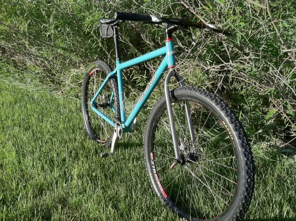

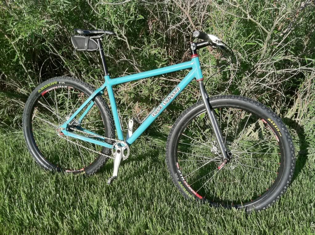

    A Custom Rock Lobster SS (big pics and info)
    Back in November I talked to Paul Sadoff at Rock Lobster about a custom aluminum 29er singlespeed with sliders. A patient wait over the winter, fun with the build process, and here she is:
    This is a burly Easton 7005 frame, the beefiest down tube Paul could find, rectangular-section stays, solid aluminum seat/chainstay yokes, and aluminum sliders. The sliders and yokes are made by Mike Ahrens. Here's how they look up closer:
    A nice weld shot, and Paul's sig...
    Gobs of clearance, not tried it yet but based on the measurement a Ralph 2.4 on a Gordo will fit in here with plenty of room...that's a tiny little Hutch Toro in there now:
    Geometry custom to spec plus Paul's suggestions, a 71 head / 73 seat angle and a fairly short seat tube to provide some standover clearance (I'm short-legged for my height). The sliders provide effective chainstay lengths of roughly 17.2" - 18" depending on gear and tire choice, based on a 65mm BB drop. This provides adjustment about as short as you can practically go on a 29er without doing a bent seat tube or some other approach to keep the rear tire from buzzing the seat tube, and works well for me in my frame size and the 71 head angle. Fork axle-to-crown based on an expected ride height of 480mm on the 100mm Fox Fork.
    The ride? Well...I am going to have to learn to mountain bike again for the 4th time...it is a lot better bike than I am a rider. I think the lobster is secretly laughing at me when I am tired on climbs or balk at an obstacle:
    This bike laughs at uphills...it is all up to your legs/lungs, what ya waiting for??
    And fast rocky descents that might have had me concerned on one of my steel rigid bikes? Again...the lobster chuckles to itself and shakes its head, no issue, bring it on...
    All I can say is it is going to be a really fun spring and summer. This bike is fast, comfortable, and confidence inspiring. It feels very balanced and stable on descents, and I have no trouble lofting the front wheel and sus fork on climbs. Only a couple rides in so far, but I am very, very pleased. The frame builder's art is alive and well in Santa Cruz, CA.
    The build, all the stuff I had laying around my garage... Well, OK, it was in my garage but that is 'cuz I sold off my old "best" frame and this is the new one...um...REAL good decision.
    09 Fox 29er fork, 100mm
    XT Crank Arms (getting an Enduro BB, XTR cups for now)
    Surly 33 ring, Surly 20 cog, SRAM 991 chain
    09 Marta SL brakes
    Thomson Stem, Post
    Fleegle bars - sadly, Fleegle can't see out of my new stem :-(
    Shimano XTR pedals
    King headset
    King SS and ISO disc hubs
    Stans 355 rims, Sapim spokes (Speeddream wheelset)
    Specialized Alias Saddle, some Lock-on Grips
    Silly Little French Tubeless Tires
    Yep, those are King Cages and they're Stainless Steel
    Yeah, I may try the Captain Control's on it here in a bit, but I am primarily an XC guy and the Hutches are fast, and had that nice blue logo for pictures. This bike just begs to be ridden long and hard over anything you care to try.
    Another season is upon us...Let's Ride!

    weight?

    Wow. Nice unique build. There don't seem to be that many Al customs to begin with, but yours takes it to a new level. I love the large tubes, they look like they mean business.
    Re: the tires, they don't look small from the side. Those Hutchinsons (at least the 26ers at my LBS) seem to be much taller than a given tire in the same width.
    Nice to see new bike pics with dust and dirt, BTW.

    I am a fully recovered ex-weight weenie so I have not even checked the whole bike. The Thomson stem and Fleegle bar are a couple of the heaviest products in their class.
    The frame is between L and XL in typical sizing, and weighed 4.2 lbs on the hook at the shop. Not bad, considering the sliders and the yokes are solid hunks of metal. The tubing is older US-made Easton Elite...I think you could use it for a Tandem...weight was not a big consideration.

    I have two Fleegle bars on different mountain bikes...I am hooked. I had a Niner Flat-Top 9 bar set aside for this build...but it got swapped onto the winter bike...I plan do do some long rides on the Lobster and I have not found anything to be as comfortable. I really reef on my bars when climbing, so the Thomson stem and Fleegle are the platform to deliver full-body force to the pedals.

    Looks like you later swapped the front Hutchinson Toro (2.1"?) for a WTB Exiwolf? Would you compare the tires and how they affect your handling?
    Nope the rear is a Toro for bite, and it has the hardskin casing so all the crap that had the benefit of suspension on the front tire does not shred the hardtail rear tire.
    The front is a Python, it has more volume than the Toro, but narrower tread. Rolls fast for the front and with the sus fork there is WAY more traction than I am used to coming from rigid bikes.

    '06 El Mariachi (now the Gordo-Fat-29er)
    '07 One 9 (nice but I sold it)
    '09 Jabberwocky rigid for the 71 head angle (I know...I know...but I did skip '08)
    '09 Rock Lobster is here now as the prime machine
    Most of my parts have seen at least 2 or 3 frames...compulsive part-swapper. The RL build right now is a keeper for awhile though.

    those yokes are SWEET! I had an Ibis Alibi with similar yokes. Nice build, I like it.
    One question - Why not a Setback post or a slacker STA? Looks like you have that seat slammed back on its rails. Nice build, and sweet color! Have fun.

    Well...I am actually in that grey area between needing a setback with the seat forward, or a straight with the seat back. The specialized saddles actually have long rails, so the seat is not quite all the way back. Also, a slacker seat angle causes other changes like even tighter rear tire clearance, and I like short chainstays. Every bike I ride regularly has a Thomson post and an Alias saddle, set up just like that...I can ride all day with no irritation in that department, so I am not changing a thing.

    Looks great. The STA looks slacker than 73*. Too bad its not...
    So, how short are the chainstays currently?

    Well, I obviously have that new bike enthusiasm going and only a couple rides on it under my belt. I have ridden mostly steel rigid forks on my 29ers until last fall when I picked up the Fox, I ran it for awhile on the Niner frame and didn't happen to like the way the two played together. I then ran the Fox on my El Mariachi for a bit...nicer combo but had a big-n-heavy sort of feel together. This bike was designed around the geo of the Fox, so no surprise they work great together.
    I sought out aluminum after comfortably riding a "Scandium" bike for awhile (which is aluminum alloy) and getting fascinated by reading this article in Mountain Flyer by Mike Ahrens:
    http://ahrensbicycles.com/Understand...Mt%20Flyer.pdf
    Mike and Paul have separate companies but seem to cooperate together so I got connected with Paul to build the frame, using some of the Ahrens components. I can't point out to you what is yielding or not specifically...but the bike has a lively feel and rides fantastic.
    I agree with your comment on tire choice also...the Hutch tubeless tires are like a little bit of suspension themselves.

    nice bike cayonrat, I have a RL SS paul built for me about 6 years ago out of scandium. it is one of my favorite bikes.. I have a 69er in the cooker with paul. I still got some time to wait though. prolly a couple months yet.
    Yo!
    Yo! is offline
    Reputation: Yo!'s Avatar
    Dec 2008
    348
    Very very cool.
    I was wondering when I would see a 7005 frame with sliders, machined yokes, and boxed chain/seat stays.
    That bike looks like you could huck 5 feet and keep on rolling...it reminds me of my burly dirt jumper.
    EDIT: This is probably my favorite bike on the forum.....I'm in love

    Awesome David, enjoy the build and the process! This is still one of my favorite bikes, just shuffled components around and finished this rebuild yesterday:
    It's seen 2 Leadville 100's, 4 forks, more builds than I can count...sorry these pics are a little overexposed from horizontal 6:30pm sun in Denver.
    Lessee what's changed now...
    - All the king stuff gone, big Cane Creek 110/100 fan now.
    - Just outfitted with Ardent 2.4 front, 2.25 rear on flows, Hope front on RWS, Paul SS rear with White FW.
    - Blacksheep Ti fork...
    - Bars, stem, grips, *sigh* I know I can't leave well enough alone.
    Last year it was all ultra-light build with Niner Carbon fork, Crest/240s wheels, etc.
    Frame is just getting broken in. :-) Say "Hi" to Paul for me...one of these trips to SC I am going to buy him a beer but never met him in person yet.
