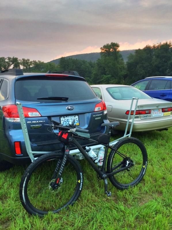

    6+ month and easily a couple thousand miles on the bike update.
    I have had my IP-056 for 6+ months now.
    I have put this bike through its paces from long sustained climbing to fast rocky downhills to fast tight rolling single track.
    I have had a couple of hard crashes along the way as well which comes with territory when you push the speed envelope.
    From day one I have been hard on the bike riding wise without even thinking twice about structural integrity of the frame.
    The bike has been pounded and has performed flawlessly over the last 6+ months
    Too anyone who is reading this thread and are having second thoughts about buying one of these frames dont be afraid.
    I have 25 years of racing and riding experience some of it at a top level over the years.
    I have ridden and raced many a bike over the years and these frames are the real deal for what they are.
    Cheers!

    IP-256 first ride report: so far so good!!! Took it on the D2R2 180km ride yesterday as its maiden voyage and it did not disappoint. Climbs great, feels light and lively. Only one ride on it but so far I love it. I haven't weighed it yet but it's light. Stoked for the carbon Jones bar to come out later this summer and shave another 0.5-0.75 pounds off the build.
    Complaints: the 32 tooth ring is the biggest you can get on there with the XX1/X01 drivetrains. For future iterations of this bike there will need to be more clearance for bigger chain rings (at least up to 36 or so) now that 1x setups are so common. I tried to fit a 34 tooth on there with no success. Oh, and the water bottle holders are too close together so the one on the downtube is pushed out like 1.5". Not a huge deal, just bigger chance of losing a bottle.
    XMI Play IP-256, medium
    Derby 35mm wide carbon rims
    Niner RDO carbon fork
    SRAM X0 drivetrain with 32 tooth front ring
    XTR brakes 160/160
    Jones handlebars

    Chinese Carbon 29er
    Side entry cages will solve the bottle problem.
