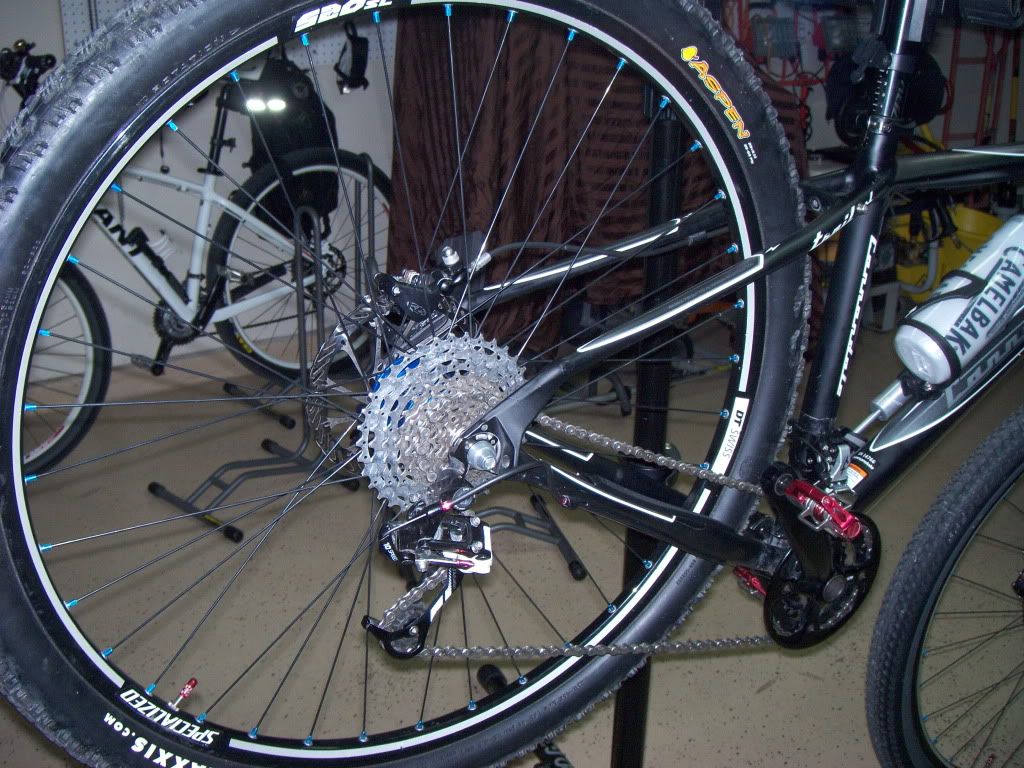

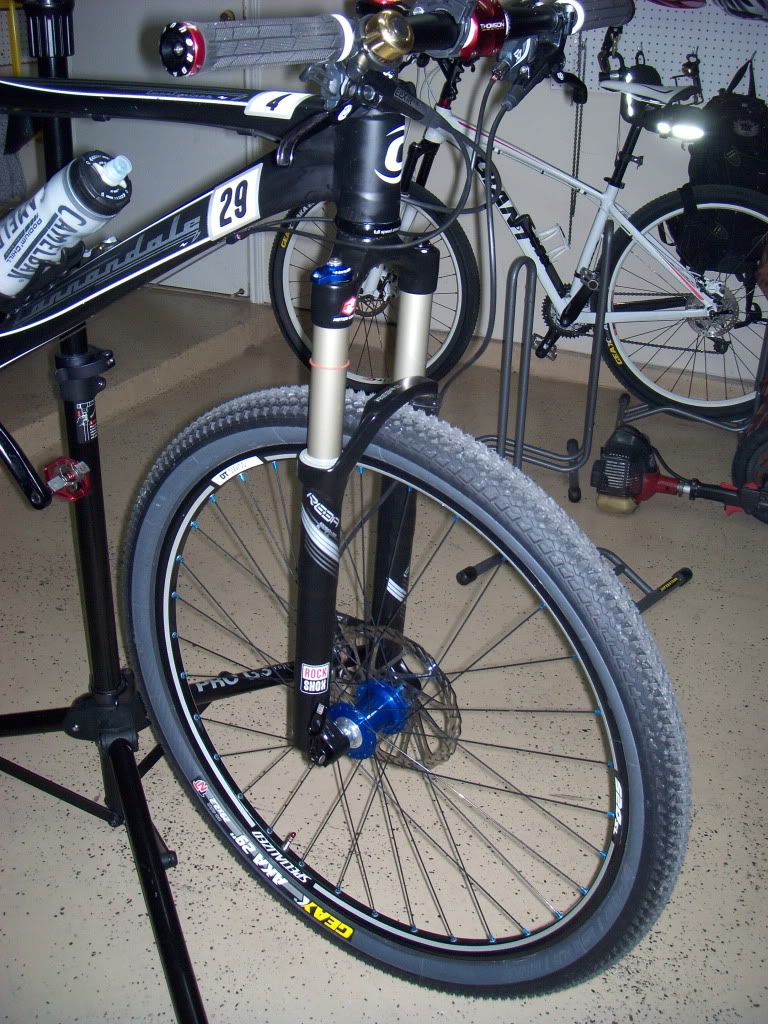

    As promised. Upgraded fork. If you are on the fence about a Cdale Trail, don't hesitate to get it. Just make sure you get one with 1.5 headtube. If you get a frame with 1 1/8 headtube, you have to change the frame out to get stiffer. Not knocking the 1 1/8 frames out there that are specd high, but there's a tradeoff. If you are a newb, you won't notice the diff. But once you ride a tapered or 1.5 headtube with a thru axle, then you will notice the stiffer front. I love my Cdale trail so much, I almost put my XO stuff on it. The point is, the CDale frame is worth upgrading. The rear tire clearance could be a bit better but you can run 2.2 in the rear.
    Reba with 20mm thru axle polking a 20mm Hadley DH hub, HOLY STIFFY
    massive 1.5 headtube, look how smooth the welds are on the headtube, almost like glass
    2x10 with x9 and Hadley 10mm bolt on...freaking awsome!! Look at the rear triangle. The tubes are shaped thinner and wider in the middle (a little hard to see in pic, but its there), thats the "Save" tech to make the rear somewhat like a soft tail. Some guys have reported that with the "Save" frame and "Save" seatpost and running the tire tubless with low pressure, they almost feel like there on a FS bike.
    In conclusion, the Cdale Trail tends to be lower specd than some budget bikes, but the frame is awsome. Best of luck what ever you get.
