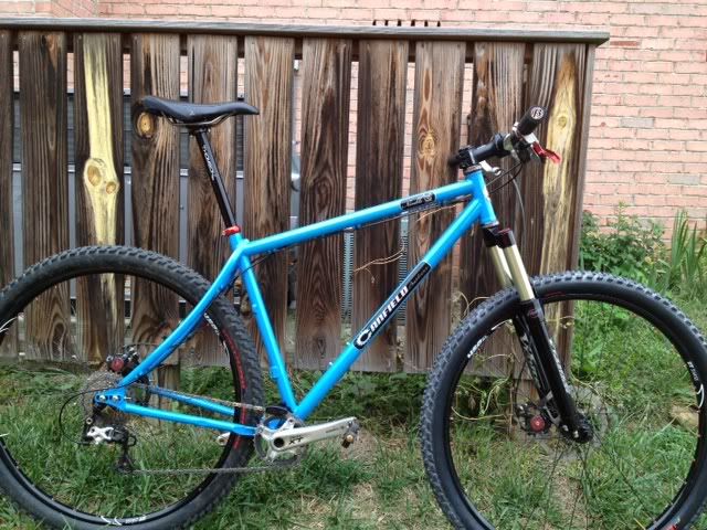

    Finally up and running. A quick shakedown ride through the City on sporadic singletrack on the old army base.
