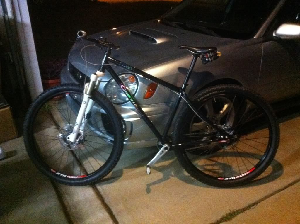

    Here is the final product after cleaning up the spacers and brake cables.

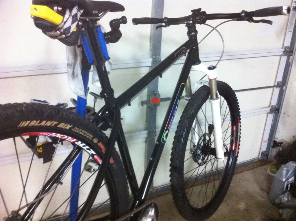

    The new bike on its first ride. Rode a few miles of pavement to the trail and back. I have the same heel rub as others have mentioned. I need to dial in the setup a bit but love it already.

    J.A.M.- That thing looks wicked fun. Nice build.

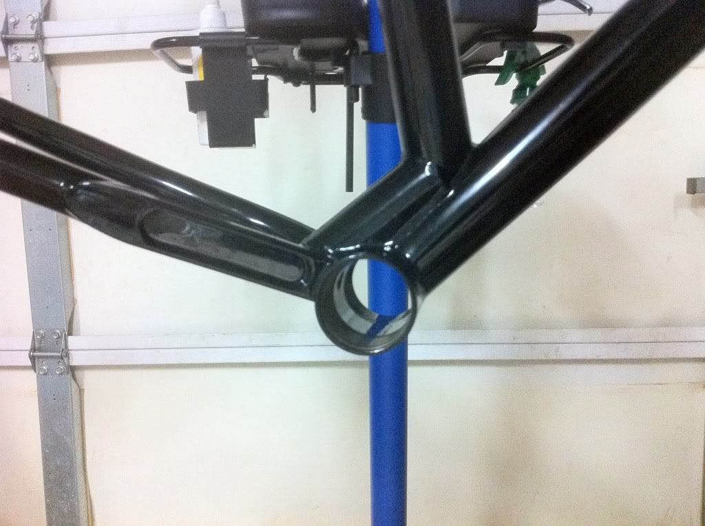

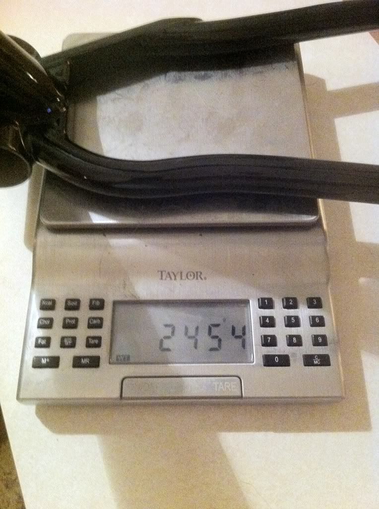

    My new Nimble 9. Just built her tonight. Heading to Warrior Creek in NC to break her in in the morning.
    Build list:
    Medium frame
    Reba 15mm thru axle
    Industry Nine Enduro wheelset with Flow rims
    Hope Mono Mini brakes 183mm front/ 160mm rear
    XT crank set up singlespeed
    Thomson and Easton bits with Fleegle bars and Ergon grips
    Pics:
    Weight of frame, including hardware:
    Seattube:
    32 tooth ring clearance:
    Rear setup:
    Front setup:
    Completed:
